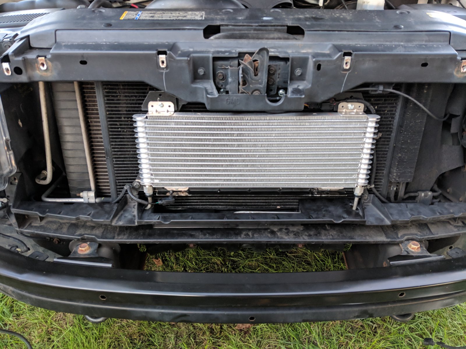

You can make the stock lines work with fittings to the 40 k cooler, flip the bottom bracket drill holes and reuse the stocks bolts. I made the bracket 1/4 aluminum.
I don't have a stock one. I have zero. Which line leaves the radiator to return tot he trans (our cooler in this instance) The bottom line from the radiator would make sense.
21,321
30,318
Now which line is which top to bottom?
Fluid comes from the transmission and enters the bottom of the radiator and exits the top fitting. This is to keep air pockets from forming. So the line coming out the top of the radiator goes to the external transmission cooler. When we used the tube/fin style cooler, the exits were on the side and we plumbed into the bottom first and then the return came out the top. With them facing down, I reckon that it doesn't matter unless the manufacturer says so.
Doesn't matter but I just matched to my stock one with the Trucool

Wow she’s a beaut! Any more info on parts needed?
I did the same using most parts that came with the Trucool pack ... I did get transmission line adapters that screwed into the trucool. I cut the original lines with a small tube cutter and then extended them with rubber lines

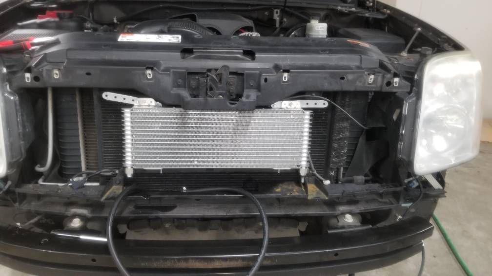

Here is a pic before clean up
If you have the stock trans cooler all you need is a bolt kit of your choice, local advanced Auto parts has them .
One flat bar of aluminum and a way to cut it. The stock lines are thin and you can heat and bend them easy. Also need to trim the lower plastic panel. Napa has the fittings for the 40k cooler to work with stock lines .
The bottom mounting bar just needs flipped over and trimmed , you can reuse the stock bolts . I'll get some detailed pics this weekend .

Can the stock ends of the hoses fit the new cooler? That’s more the part I’m unsure of. Getting it physically mounted seems easy enough.
Yes Napa has the fittings for the cooler to work with the stock lines but you have to reroute and bend them a little
