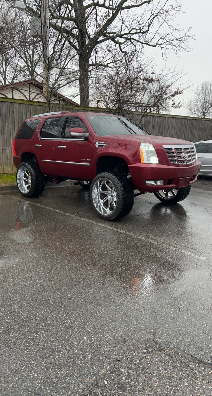

If anyone has any questions about 07-13 Escalade with lifts or levels etc
Let me know I have a 2010 Escalade on 7.5 inch lift and 26x14 and 37s
Amg5150
Aug 10, 2023
Hi, what are the details on your lift? I have an 07 Denali AWD and was wanting to do the RC 7.5 lift but they say it won’t work on AWD.
