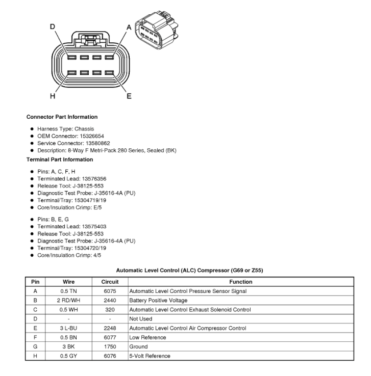

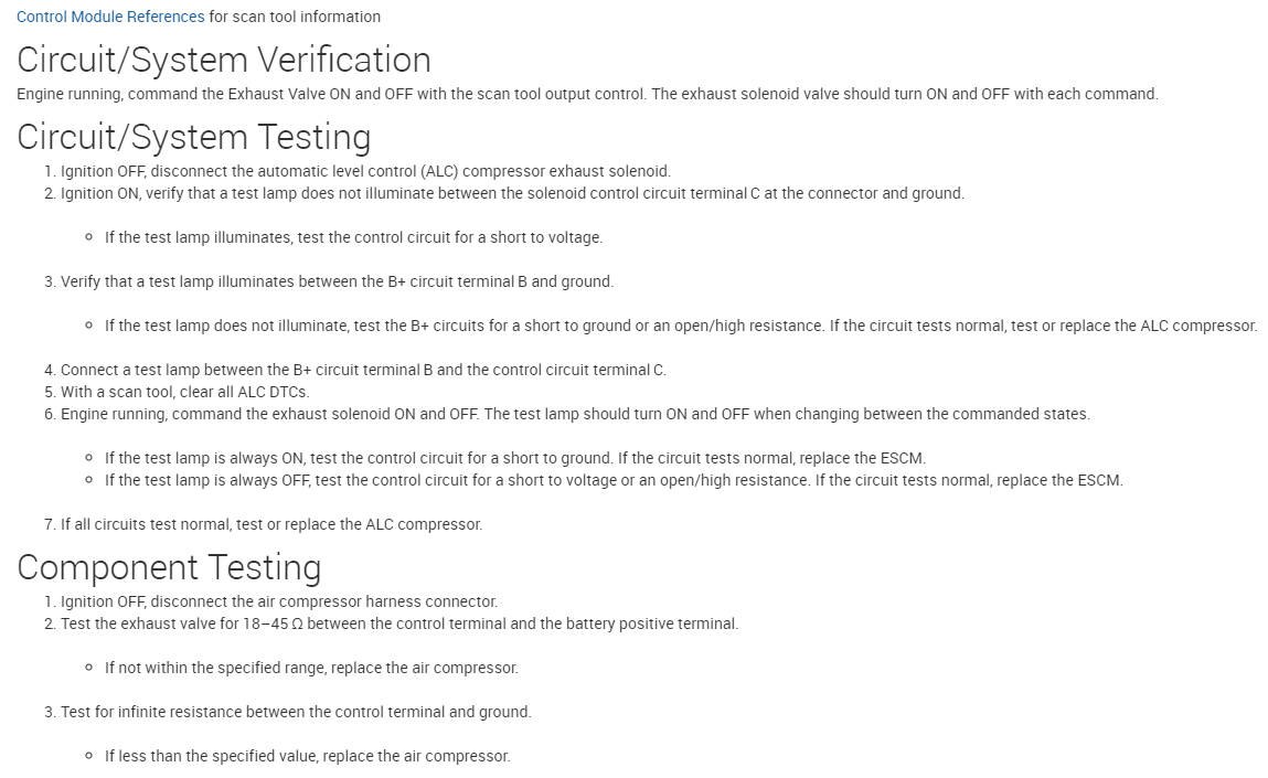

You can test the compressor’s functions using a Tech2. That is the only test procedure that I’m aware of. In theory it should be possible to bench test it as you say using a wiring diagram, which I can probably dig up for you if you need it. Or, a subscription to alldatadiy.com is a good investment for these trucks anyway.

If you could somehow find a diagram for it I would very much appreciate it, my gmc has 129k miles and the air shocks look like they are in pretty good condition that’s why it’s kinda weird for it to have that problem with it having kinda low miles, I used a scanner similar to the tech2 but when I tried to test out the compressor, all it said was test failed, no communication with the exhaust valve, that’s why I’m thinking of bench testing it to see if the compressor is bad or I have a wiring issue with would be a pain to fix probably.

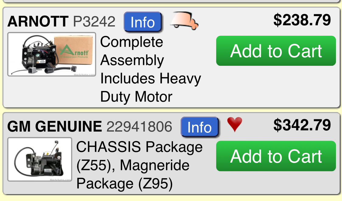

The AutoRide system is really simple. Most of the time that DTC is the pump grounding / shorting out or the control module rotting out. In the XL the module is under the spare and the shorty the module is next to the spare. If your pump is silent at start up it’s likely seized from running until it overheated.
GM did not put an overload protection circuit in their pump. Arnott did and it carries a lifetime warranty as well as being less expensive.
Don’t be afraid to shop around on Amazon or anywhere else for a better price. Start with the pump and move on to the module. Look at YouTube for an easy how to for replacing it.
Keep in mind a dealer will charge the cost of buying a new pump just for diagnosis. Then they’ll charge you full retail for a GM pump without load protection with a 1-2 year warranty. They’ll get about $1k to do just the pump so look out.
