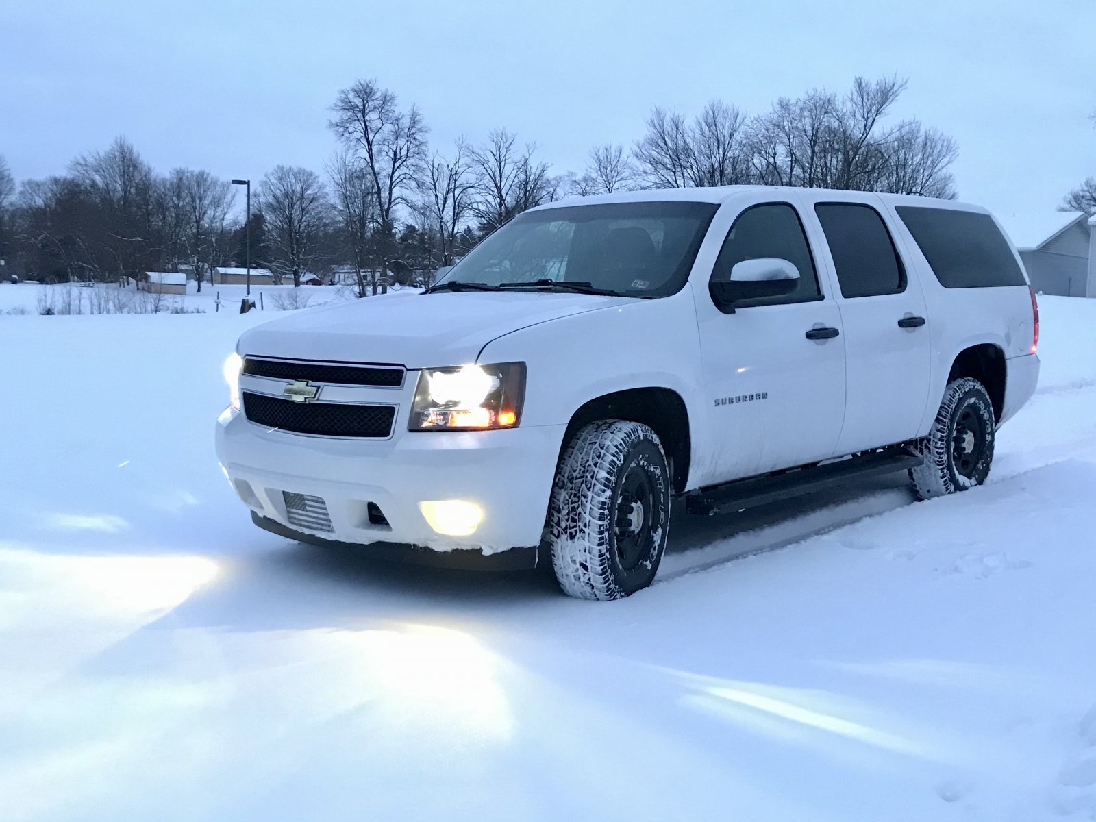

Do they not make a frame mounted hitch for suburbans? I’ve heard horror stories about these things being totaled if you are towing or have the hitch in and you get rear ended it could bend the frame. Was hoping to get a frame mounted receiver, but I can’t find anything anywhere. Or even any one talking about it. Hopefully I’m just terrible at searching for things. Thanks!
