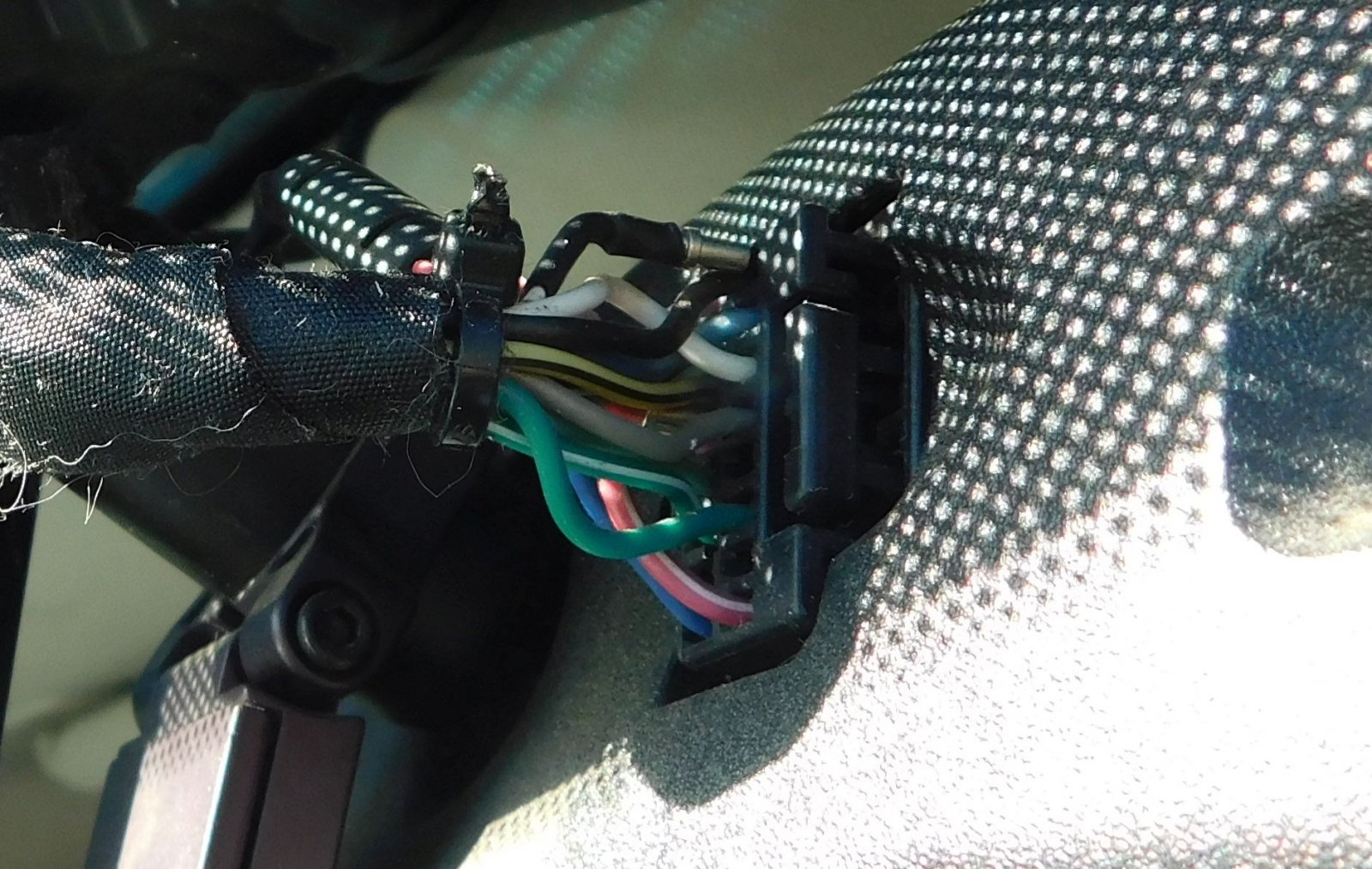

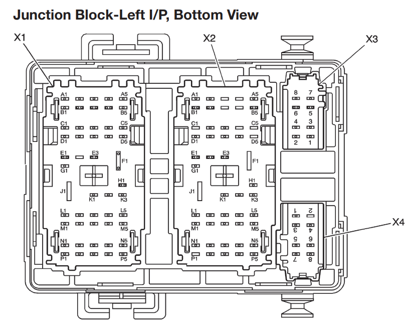

you can tap into the mirror harness 2 pink wires the center most 1 is the positive, black wire on the corner is the negative or in left side of the drivers footwell there is a small junction box with a black plastic cover, there are various connectors in there to tap into, you probably won't find a open spot because on the denali they are all used, but just use a meter and find one that is key on.

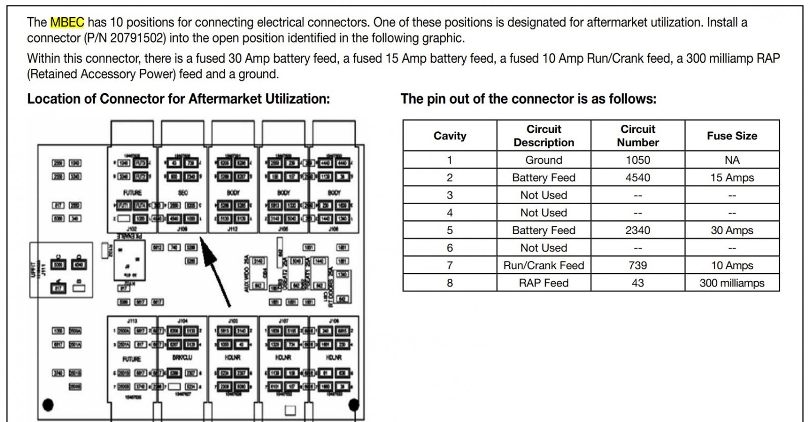

Well. there is probably an easier way... (Doubeleive's mirror tap or the $30 ebay connnector!)

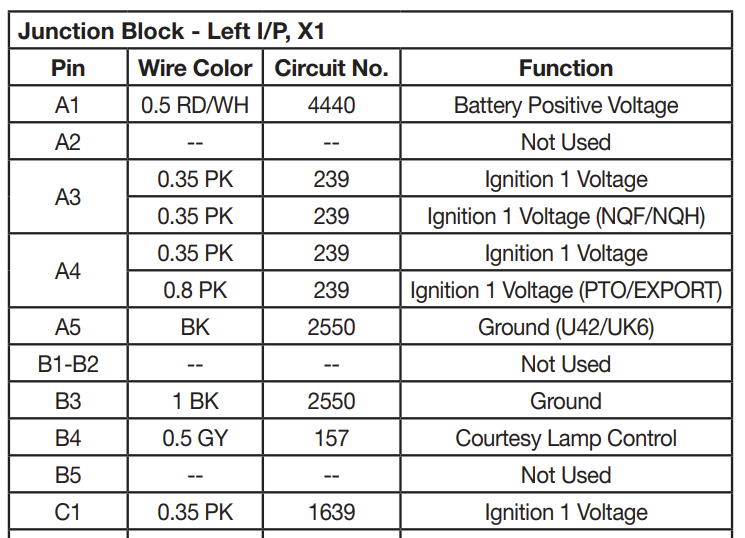

Worst case, there is some power at the left i/p junction block
underside
Ignition voltage might be better, 'Accessory' is highlighted only because that's how I searched for it.

Thanks, just what I needed, got it working the way I want.

I like using this plug, though it is $30 you could totally save, it also has a batt +, ground, and retained accessory power wire..
the only issue with this is on the denali (such as mine) all of the connections are occupied, no available slots. so I just pinned one of the connectors like I did on the mirror.
