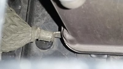

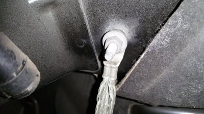

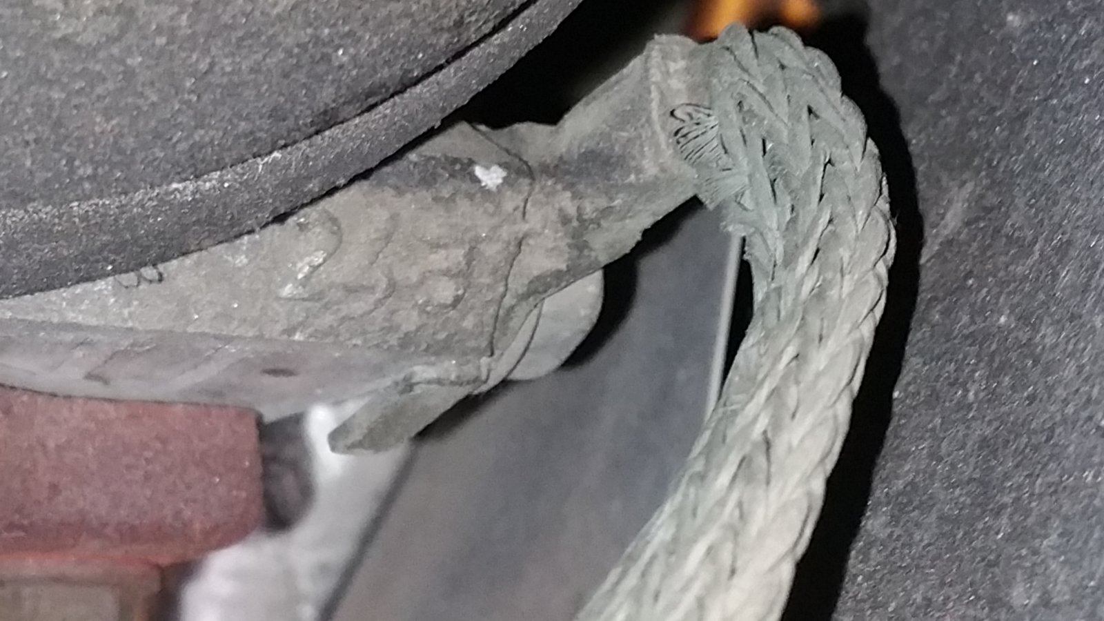

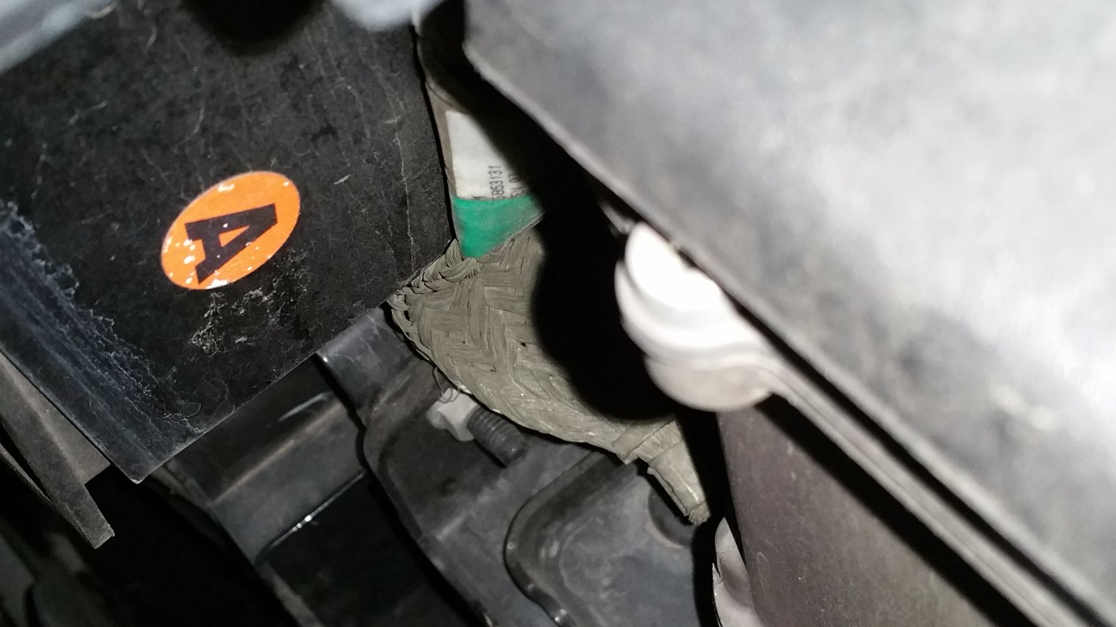

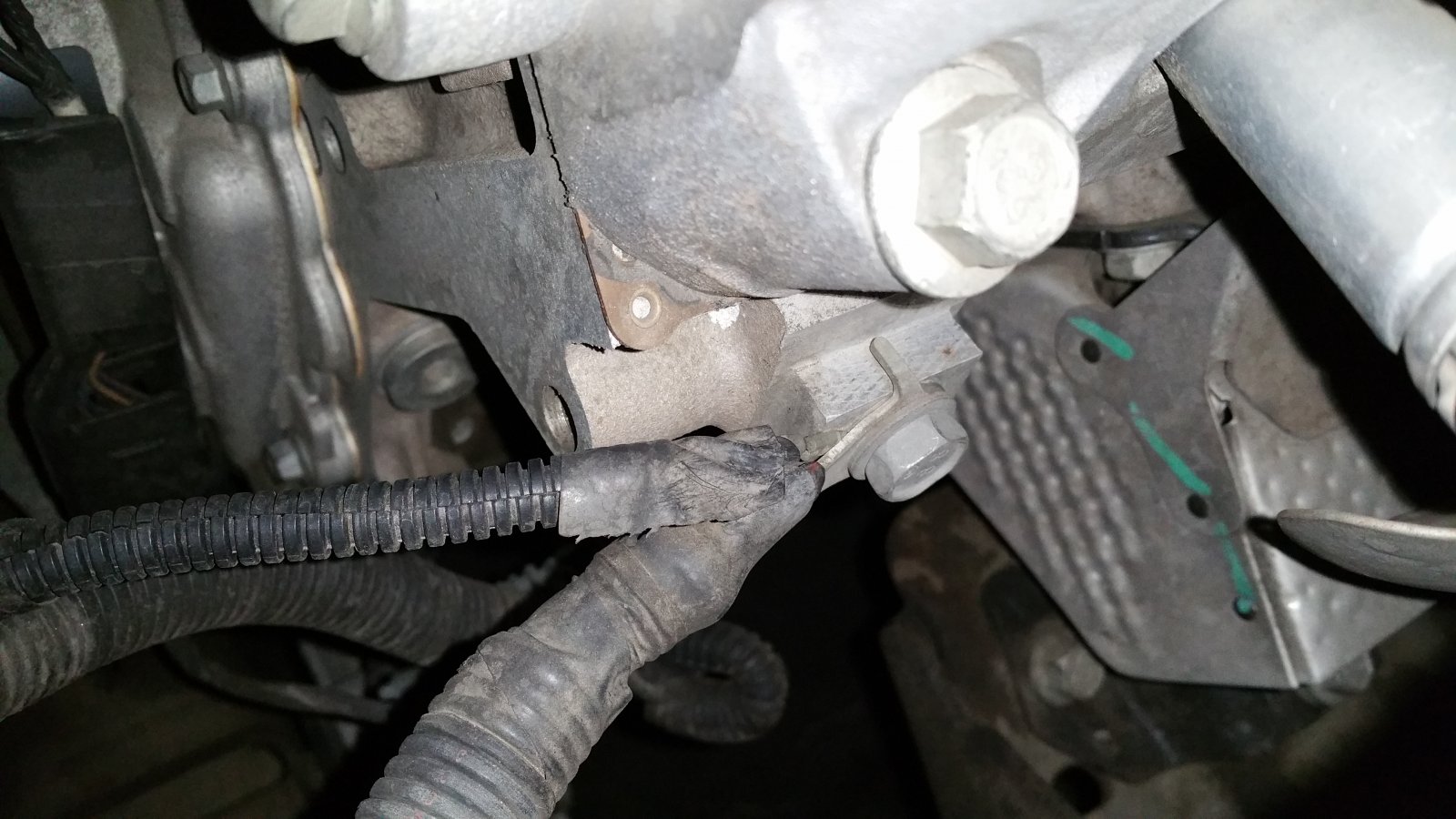

ground wire
open all 4 windows at the same time . do the lights dim a lot?
I'm Not buying that it's from "Florida" and has no corrosion at all.
when the lights dim you have some impedance Ω
mine is a California car it has only rained about a dozen times since 2008
this: could you say these are in good condition.
looks like they cut corners and used aluminium cables i'm pretty sure its not tinned copper i don't see any copper blue corrosion
20191118_114732.jpg View attachment 237090 20191223_211955.jpg 20191223_212031.jpg 20191223_212122.jpg 20191223_212158.jpg
