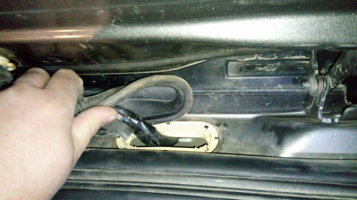

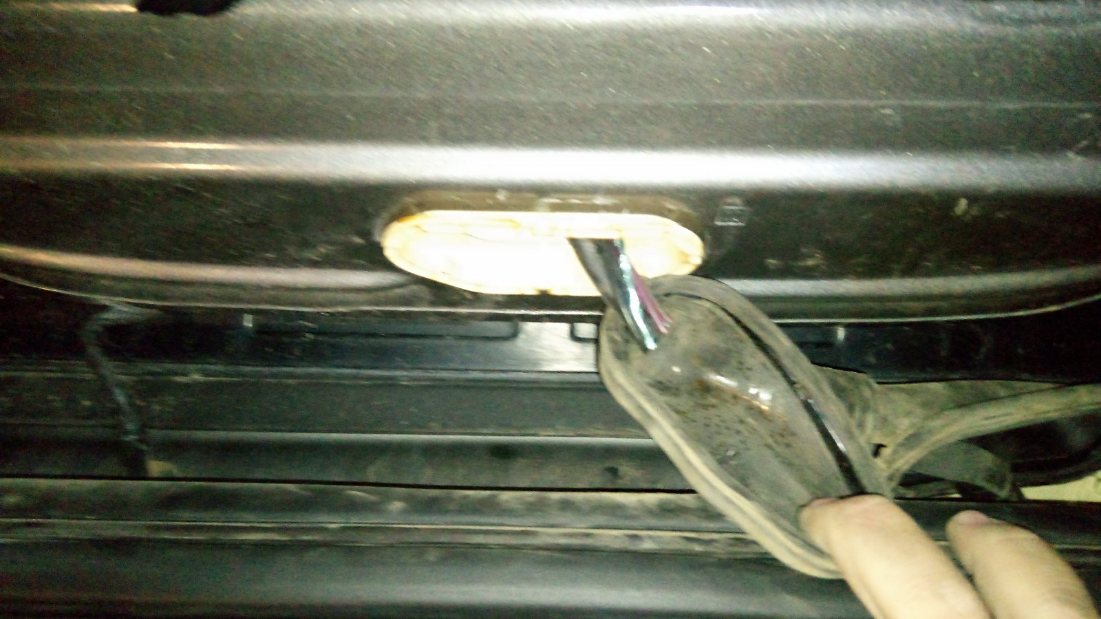

It was the lift gate harness getting power from the glass actuator. Every time I lifted the gate the glass actuator would pop the glass and has always done this the 6 years I've had it. Until tonight I've never had the gate open when I put a fuse in. Put the fuse in and heard the actuator. I could squeeze the boot and the actuator would engage. Opened it up and couldn't find a short yet. Long day so I put it back together for now. Glass isn't popping and lights are working.
That's what I'm looking for but for the life of me can't find. I've watched a few of these videos and they're in different places. I'll look again.
Never found one even after following the harness. Found the source. Details in other thread comment.
