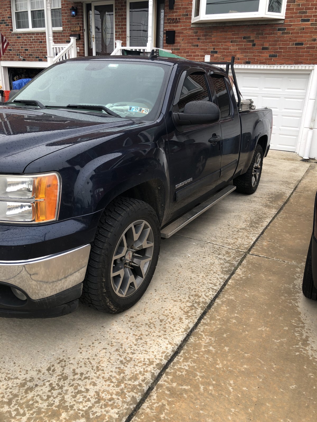

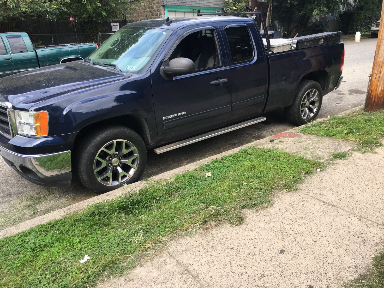

Had them on my 2011 no problems with offset or anything. They fit perfect... tpms may not be interchangeable I had to buy new ones for my truck.

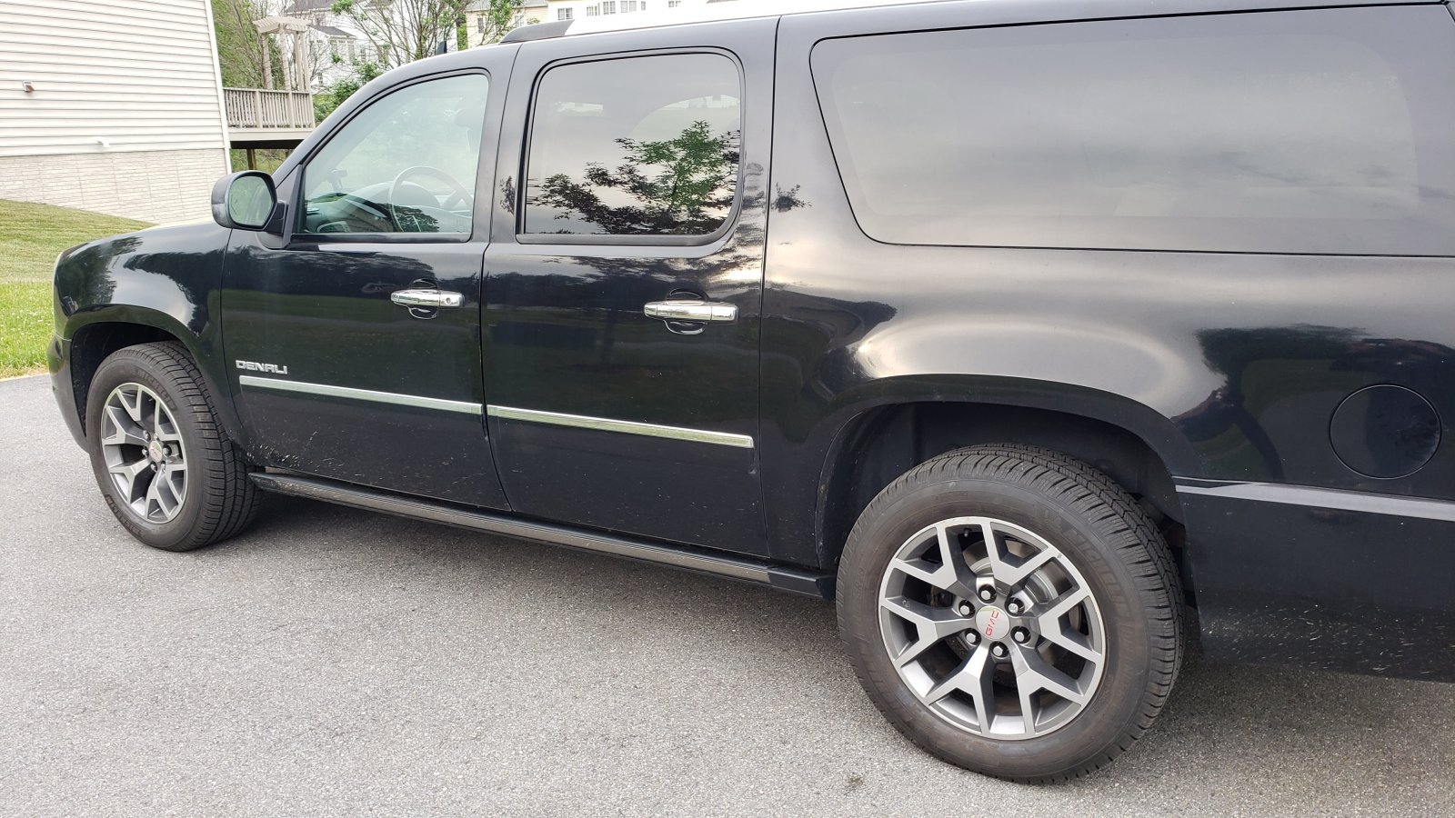

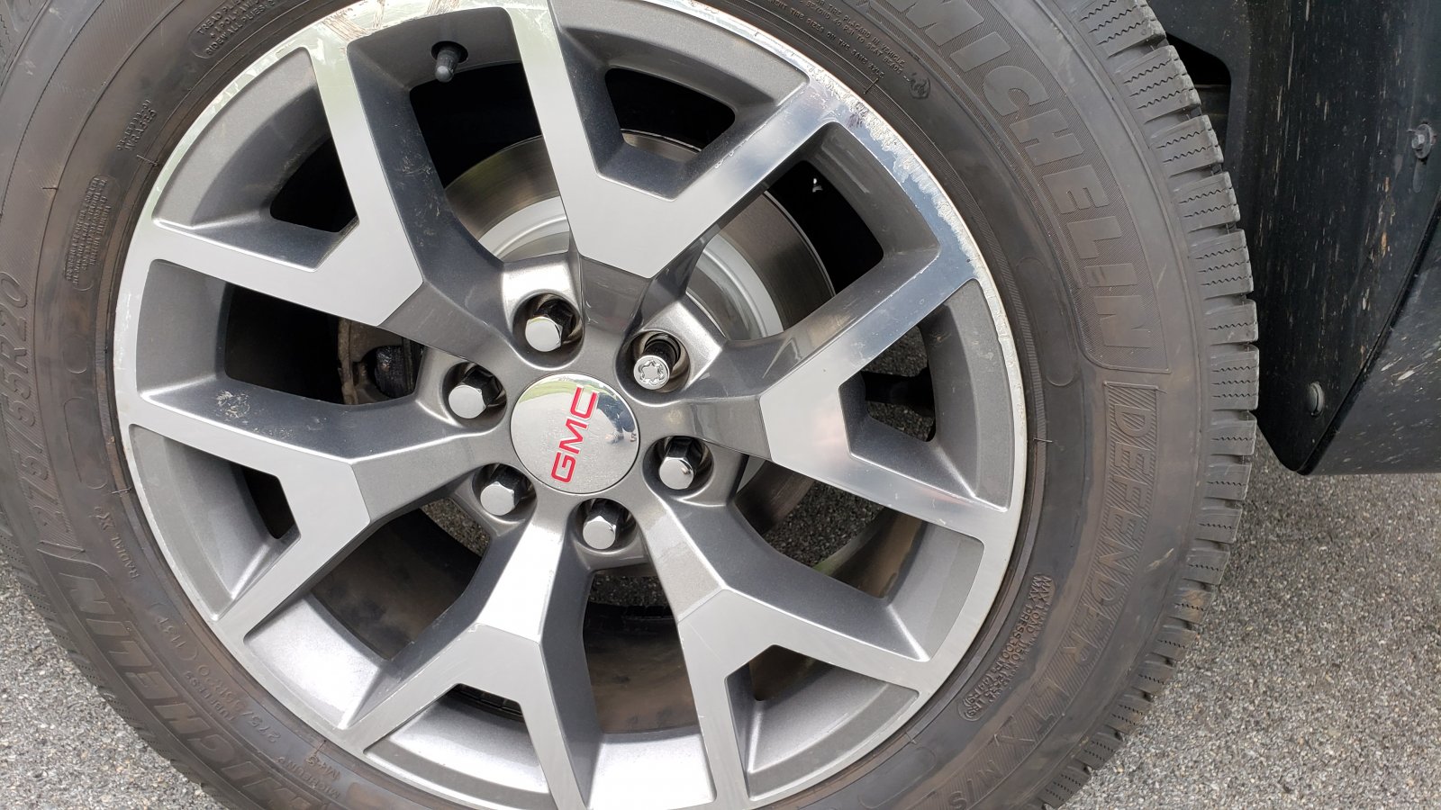

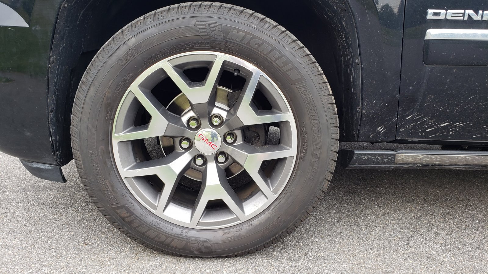

Update: just wanted to let you know that I went for it. Found a take-off set for $800, switched the tires to the new rims, had them rotated, match mounted, and road forced balanced. Plug and play, pretty much. Rides so smooth like it's on glass. Speedometer is spot on, everything is perfect. Thanks guys!
