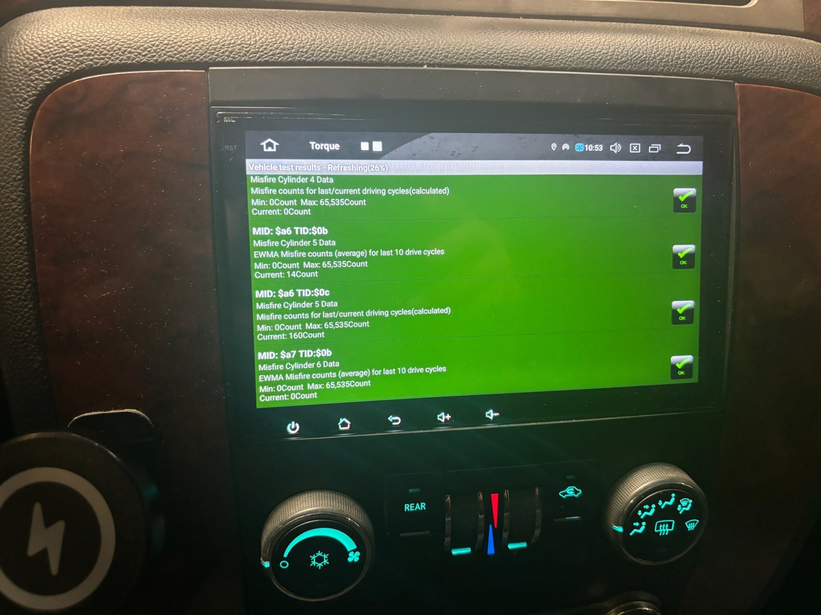

My Tahoe has had a very slight shudder in the idle since I bought it. Reminded me of worn engine mounts. Anyway about a week ago the engine light came on. Returns P0305, I tried ruling out all the easy things..... plugs, wires, coil pack by swapping 5 and 3. no change. Pulled the plug on 5 and it idles worse but rpms are about the same. Today, I put 15 gallons of E85 and fuel injector cleaner in it (as a hail mary).
When reset takes a couple days to come on. OBD2 test gives me about 200 misfires at idle in 10-15 minutes, doesn't misfire under load/while driving.
Not sure where to move from here....

Hoping pictures help.... (maybe at least for some attention)
