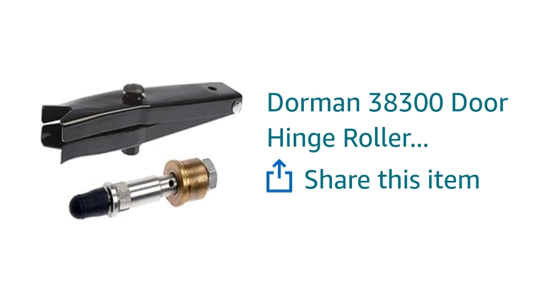

You could go with this for $40 and repair the hinge. I have them on both my trucks and they work well and are greaseable. A little bit of a pain to install though.

Please let us know how the hinge replacement goes!
My roller was like Solli5pack's, where it was flat spotted and would pop everytime. I pried out the spring to stop the noise, and bought a replacement hinge.
But after seeing Dorman repair kit, I will likely get that instead of painting and installing the new hinge I have.
