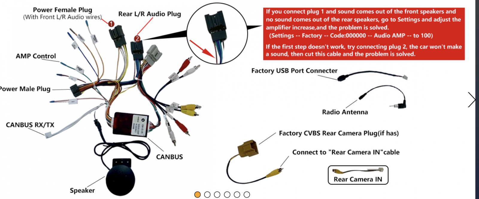

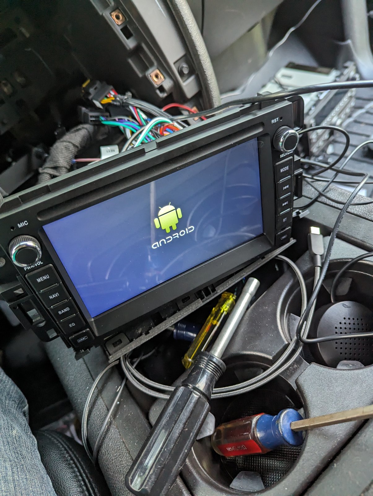

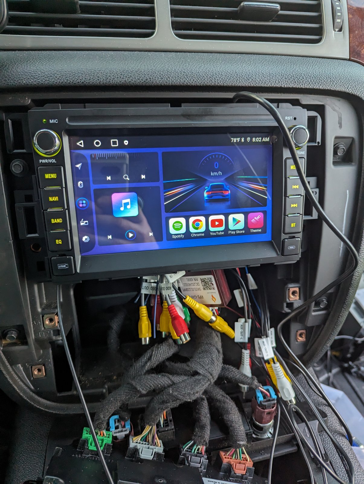

Picked up a chinese Android radio that supposedly is a factory fit. Install after laying everything out and pulling off the trim was quite easy. The issue (apparently known) is the rear has a buzzing and very little sound coming from the speakers. Its almost like all of the sound is bridged to feed the front only (which sounds great but is VERY loud). I'm being told to cut a specific wire while I'll try tomorrow. If it works, this is a great upgrade. The interface is quick (despite having only 2GB RAM) and Android Auto (wireless) connected immediately.
Amazon link -> https://www.amazon.com/dp/B0CM6HC5W6?ref=ppx_yo2ov_dt_b_product_details&th=1
Some pics, I'm not going to put the dash back together until I know I'm keeping it, etc
(Support says cut the brown wire on Harness labeled "2")

**Update** can't get the rear speakers to work, but went back and forth with support trying 2 or 3 things, apparently I missed a harness to harness amp trigger wire (not sure why that's not presoldered but whatever). Will re-re-swap tomorrow and report back.

**another update** amp trigger wire re-attached, now as soon as its powered on a LOUD buzzing plays over the rear speakers. Spoke to support again and they're sending me another radio. Swapped back to the factory radio and all works (so its not the wiring or amp). This is frustrating... I might end up with a name brand Pioneer, etc

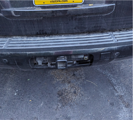

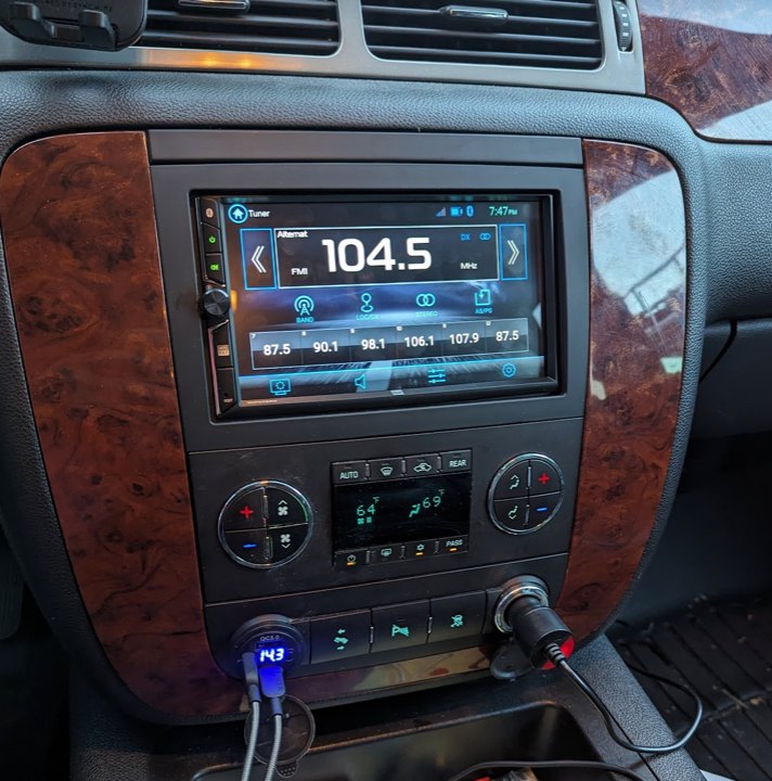

Crutchfield "Dual" branded unit in. Its very basic, which is exactly what I wanted. Basically its an AM/FM radio, reverse cam and vehicle to use Android Auto (wireless). Works perfect.
I also rewired both front power plugs with relays to be ignition switched (changed out the drivers side one for a QC/PD flush USB port) and added aforementioned camera. All in all, very happy, sounds great.
