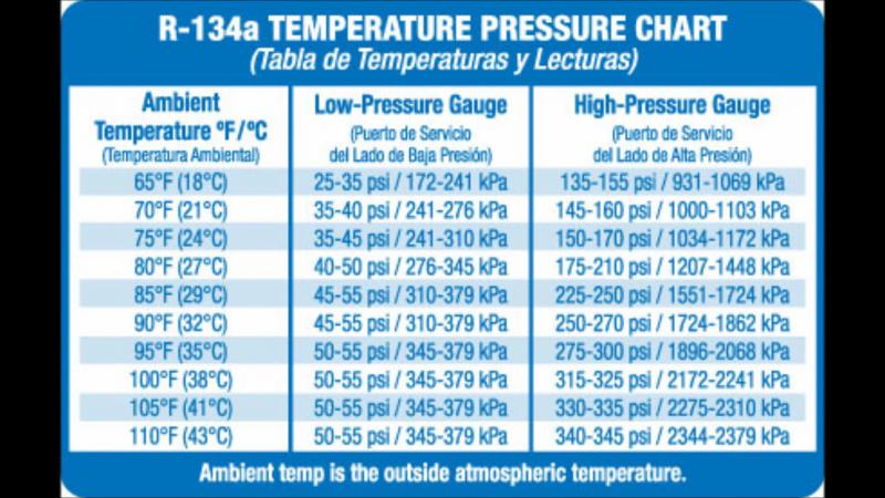

I think you are barking up the wrong tree with the voltage. I wouldnt trust what the gauge is showing. You stated in a previous post " Sorry for the lack of info and appreciate you chiming in...At the volt gauge on the dash, I did not put a volt meter to the compressor as yet. When functioning, the low is 35psi +/- and the high is 175-190."
Im guessing its substantially warmer than 80deg outside where you are and if it is then your pressures should be subtantially higher. The pressures should be checked with your system manually running on high fan (max cooling) both front and rear a/c and allow 10 minutes to stabilize. It appears your system charge is low. I would expect a min of 40-45psi if not higher on the low side and 200psi+ on the high side. Attached is a temp vs pressure chart. Your symptoms are standard for a system that is undercharged. The question is did it get undercharged or was it properly charged and still has a leak.
Not too mention a frosted over dryer/accumulator is a tattletale for a undercharged system. Your evaporator is icing over also because the refrigerant pressure is not above 32deg. Your humidity in the vehicle is freezing instead of evaporating at the evaparator which is what happens on a undercharged system (home a/c, refrigerator/freezer, window unit and even auto a/c).

Thanks for the detailed response, Rock.
I will get the gauges on them later today or tomorrow as you outline above and report back.
It's actually been pretty nice on the CT shoreline - 80-85 degrees most days.

"45 mins into an hour drive, the airflow through the vents slowed down drastically."
The airflow dropped drastically because your evaporator was a solid block of ice which means the refrigerant in it was below 32deg (low pressure...aka undercharged). This would not be possible if your compressor clutch wasnt working.
80-85 deg ambient temp should result in 40-55psi on the low side. As the ambient temp climbs so will your min low and high side pressures. Thats just the nature of the beast. All a/c type systems are at the mercy of the ambient temperatures their condenser and evaporator coils are subjected to. Especially the condenser coil.
So you need to know what the outside ambient temp is to get a clearer idea of what your min pressures should be when operating normally.
