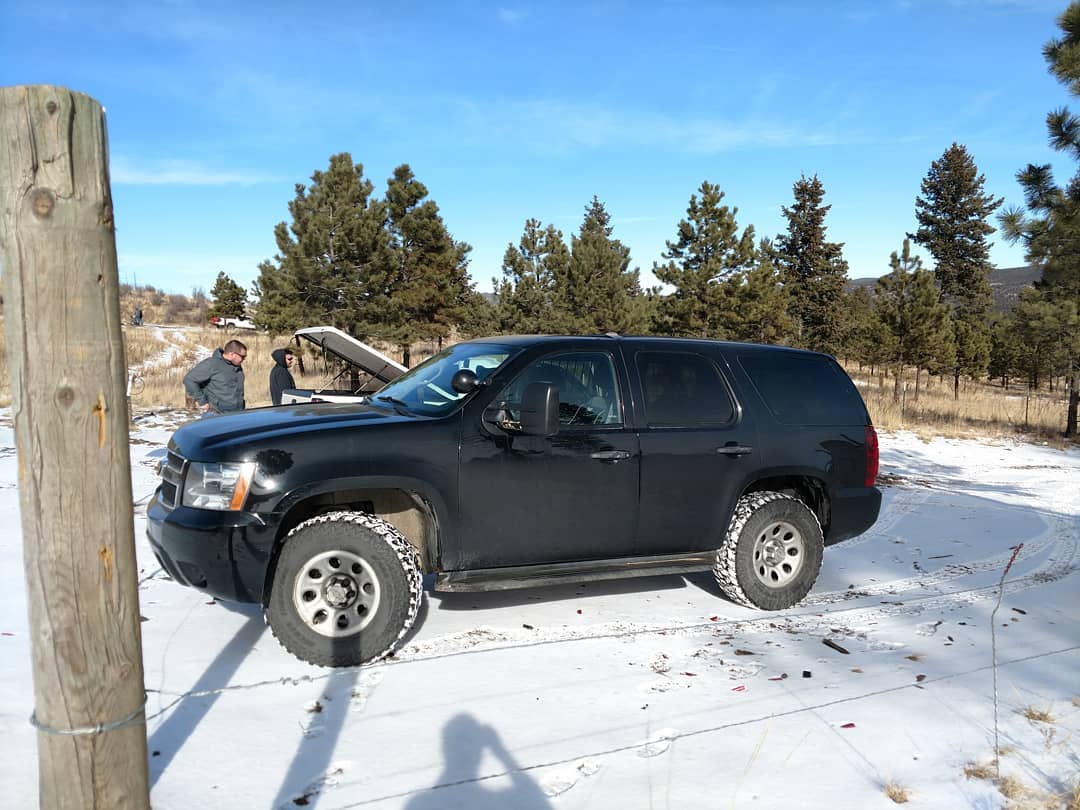

I don't have 20's, but I fit 285/70R17 mickey thompson baja atz p3 (factory 17x7.5-31mm wheels) with a 2" leveling kit with minor fender liner rubbing under compression while turning.
and the sidewalls are flush with the fenders, no poke!
46503661_10216221831151636_5649785175853236224_o.jpg 46749158_10216221746309515_7057355871260508160_o.jpg 48426716_10216441141714263_4780542116503748608_o.jpg IMG_20191128_103031018_HDR.jpg

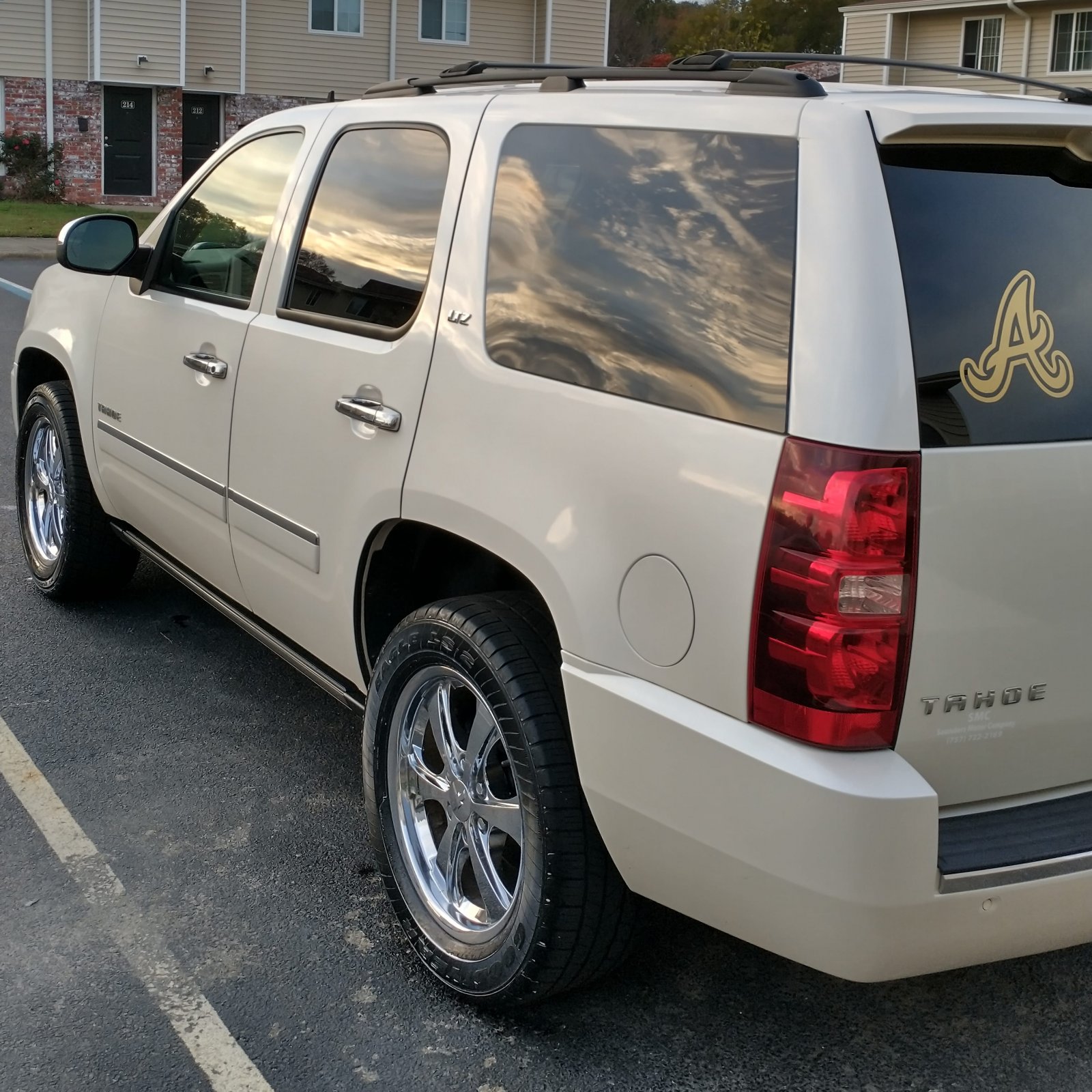

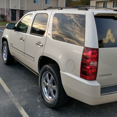

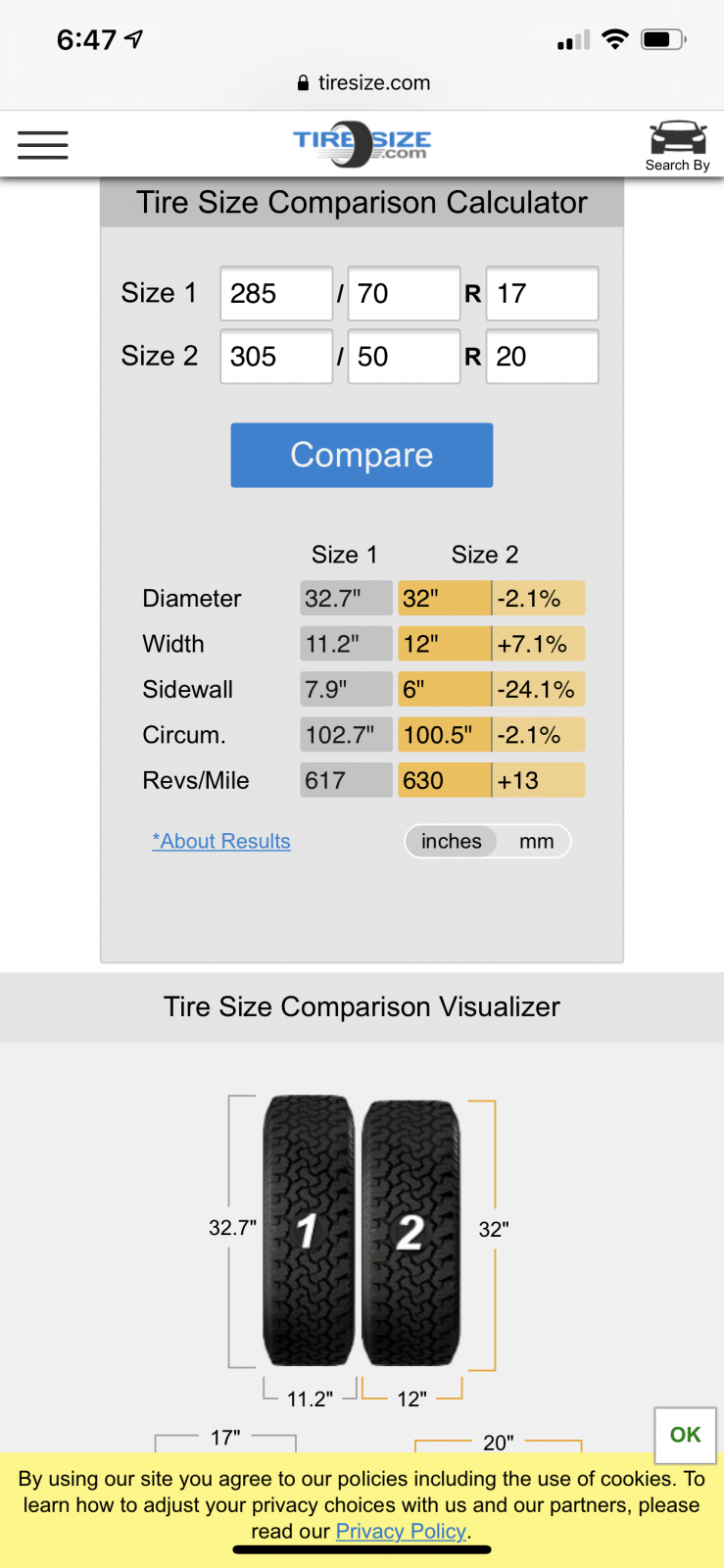

not sure if op is still looking but I know people have 305/50/20 no rub on stock suspension.... street tires tho, not an aggressive a/t tire.
That said I have 285/70/17 a/t-ish tire and have very little rub in reverse at full lock with a 2” level.
check this out, you can prob do this without too much trouble....heating and bending fender liners is common
