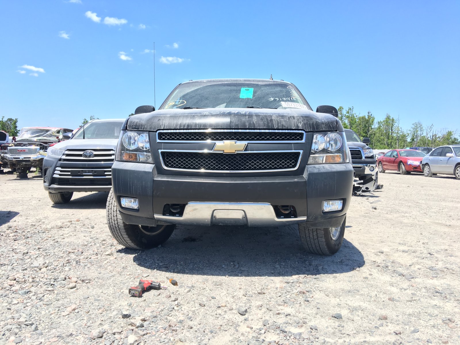

I went over on my lunch break today to try and button up the last few things for inspection on Wednesday. All that I had left was the 2 lower brackets that bolt to the bottom of the bumper cover and the a bracket that hangs off of the bumper reinforcement.
The brackets were a little bent, so I was trying to straighten them out. They did not seem to be long enough anyways.
Turns out, the bumper reinforcement that I got, was for a non off road truck. I have learned that EVERYTHING to do with that front bumper is different on a Z71 than a non Z71. The bumper cover, fog lights, reinforcement, foam...ALL OF IT.
So, I am basically just going to get it inspected and see if the guy catches it. I do not have time at this point to order the new stuff in. So, if he catches it, I will order it all and have it re inspected in 2 weeks. If not, I will ride it how it is until I get a correct stuff on my own time.

Well tomorrow will tell me if the work has paid off, or if I am going to have to replace the bumper reinforcement...If I have to replace it and have it re inspected, it will be another 2 weeks before the inspector comes back out this way.

Got a few more trim pieces on the front. Only missing the pieces that go around the tow hooks now
. Still no inspector yet :(
