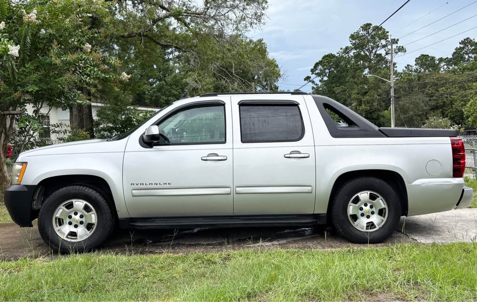

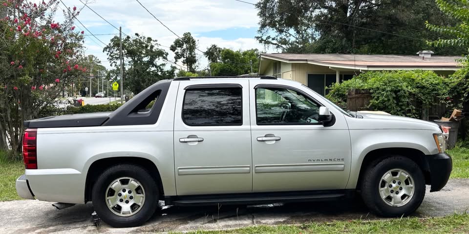

Found a nice 2011 Chevy Avy LS 2WD with 102k all original with 5.3. Asking 10500 got him down to 9k.
I own a 2003 Tahoe 5.3 and is perfect!
Would you delete AFM at this point or leave it and do oil chances every 4k miles?
Seen some do the 5th gear around town under 65 thing which I might do.
Just can't find a good low milage per '07 in good shape.
Thought of going with a newer GMC 4.8 w/o AFM, no heaving towing just basic to the dump once a month maybe pull a small trailer twice a year.
BTY<Yes, I know it need rear shocks (ZWL Smooth Ride)I already told him not to replace them yet, this guy has no idea that there are so many types of rear shocks!
PS, my mechanic (dealer mechanic for 30yrs) says leave it and just do oil.
