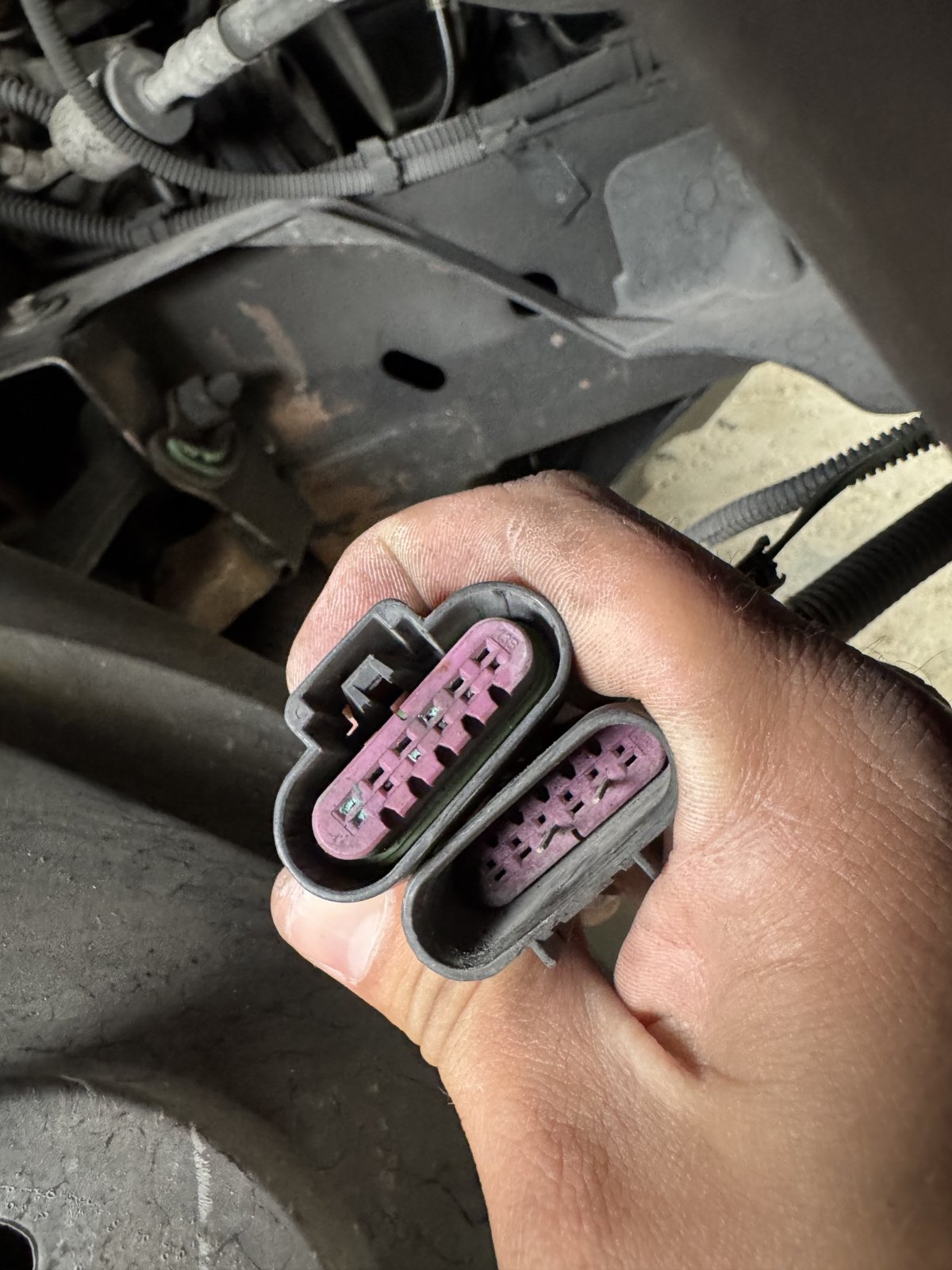

***UPDATE***
Ok guys, i finally found the culprit! It was this little sucker right by the passenger side fog light behind the wheel cover!
Funny thing is, i found it by accident . Yesterday i took the driver headlight out to see if there was anything i might of missed by tracing the harness again and today when i was doing the passenger side, i had the headlights turned on with the high beams as well, i grabbed that connector and unplugged it and then back on again (what could happen!) and voilá! I saw there was a quick flash on the wall! Seems like the connectors were dirty and they weren’t making proper contact so i cleaned them and all good now! Still, huge thanks for the suggestions you guys gave and taking your time to help me!
