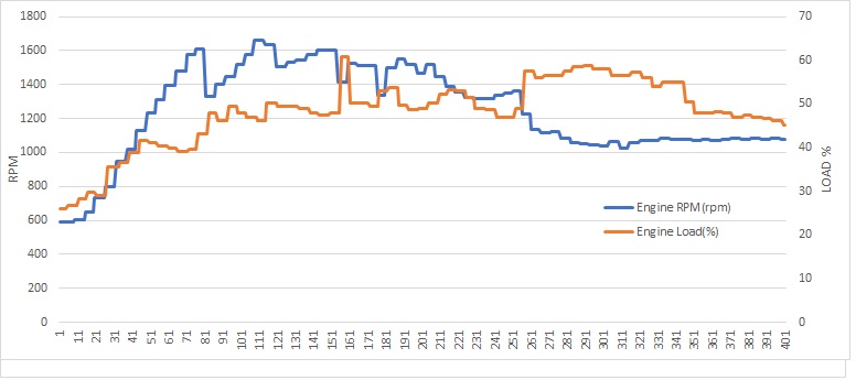

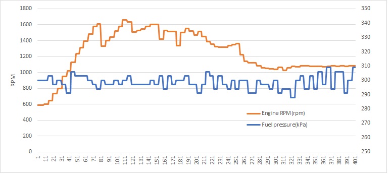

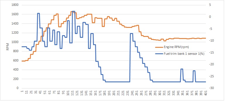

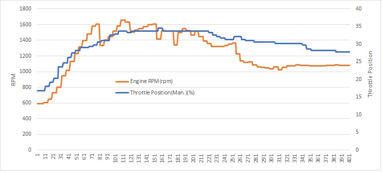

I am still having issues with the truck.
I left the truck at a local shop for a week shortly after my last post due to another episode. They were unable to recreate the issue or find any problems in the engine or trans.
I took the truck home, replaced the TPS, cleaned and regreased the battery terminals and cables, cleaned the MAF, and changed the oil.
The issue went away for several months until recently. I am still experienceing a drop or jump in RPM about 5-10 min after start up in the morning. It doesnt always happen and I have been trying to capture this on a data logger. The issue with data logging is that i have to remove a Range AFM module so after days of recording with out issue I go back to normal driving. Some times the issue is subtle and sometimes it is severe enough to stall the engine or cuase the truck lunge forward uncontrollably. It has occured while stopped at a light, while coasting, and under light throttle. Once the issue occurs the truck drives fine for the rest of the day. No Engine or Trans codes and no CEL or DIC messages. I dont see a correlation with weather; so hot or cold days, humid, dry or rainy.
The files below show an event that occured today was rather subtle. While pulling away from a red light and under light throttle the RPMs dropped a few times and then stabilized.
Looking at RPMs v Engine Load around sample 160 shows two drops in RPM and spike in load. This also comes up in the RPM v throttle position at the same time. It could be a sensor giving bad info or just my body moving forward due to the severity of the event.
I have also plotted RPM v Fuel pressure showing about 290-310 Kpa ( 45-42 psi) and bank 1 fuel trim which bottoms out after the event.
Really need some help figureing this one out.

We need one of the members here who has a lot of experience with tuning these things to have a look. I'm out of my depth. Maybe @Foggy might be able to help.
