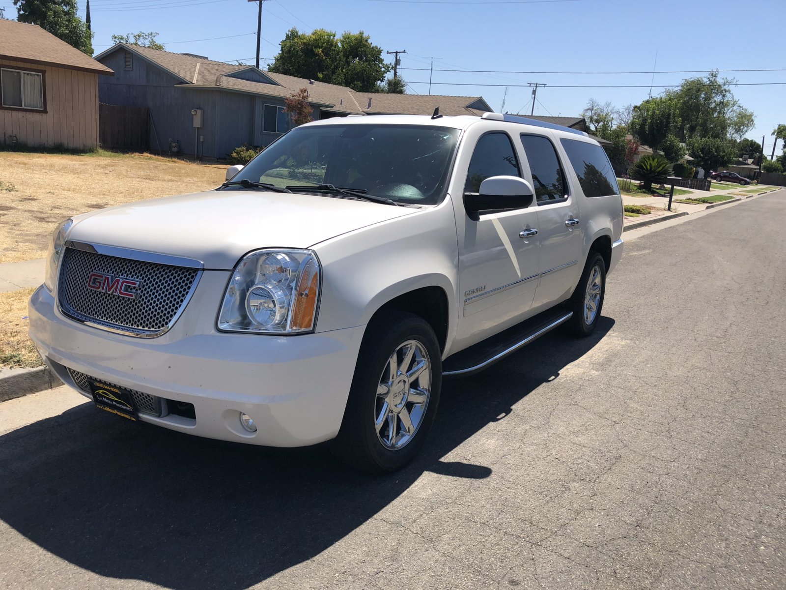

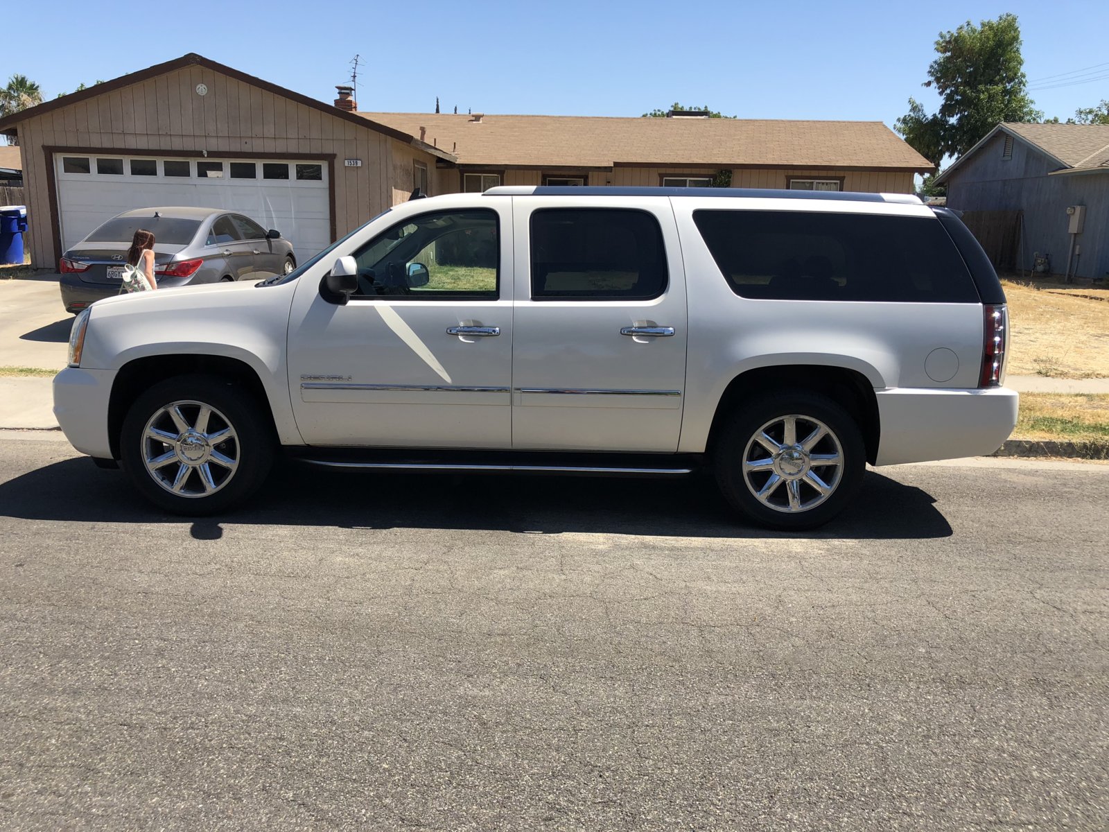

Already on a road trip over the grapevine. 17mpg average on E85.

Oh yea! White truck and 110* forecast on Friday. Now that’s a wise decision.
Around 100-110k we had our eng & trans case main seals go, Alt, radiator, a motor mount and rear auto/air ride shocks die. The shocks took the compressor with them from running too long @ 122k mi.
We just lost a TPMS sensor @ 123k mi right after 4 new tires were installed. Read up on where to buy them and plan on replacing all four next tire change. You’ll pay 50-70% less than replacing them one by one or all at once based on the shops part pricing.
When air/magneride shocks begin to leak you’ll hear the pump run 5-10 sec at cold start. Don’t wait for comp to burn out if u got leaky shocks. Disconnect it or replace them immediately. Arnott in FL makes replacements for $125 ea w/ a full, postage paid, both ways, lifetime warranty. Only buy directly from FL factory or because warranty is based on the reselling retailer. If they stop selling them, you lose lifetime warranty.
Typical stuff for an 08 truck purchased in Jan 14 with 96k miles for $19.5k. It’s about $5k worth of repair based on GM dealer labor and part rates. It’s paid us back in full plus $1k in the green including rental reimbursement. It’s nuts, the dealer offered a $3.7k service contract through a company called AUL here in Cali for 4 year/48k miles. We’re at mile 124,985 and covered til 147,600 or 4-13-19.
You are going to love your beast. Congratulations! Make sure you slather tons of wax on the roof. It’s susceptible to clear coat erosion and rust if left untreated.
