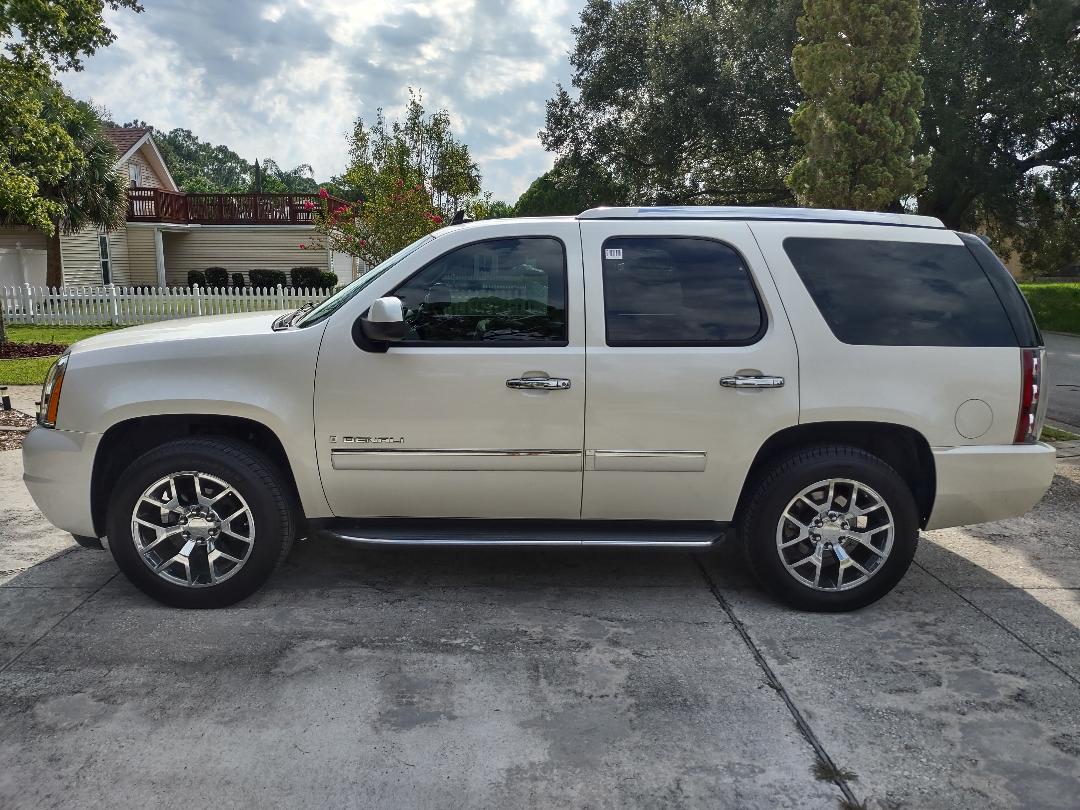

Truck looks to be in great shape!

that's a clean looking truck and as soon as you have to drop the oil pan for gaskets and stuff that 2wd will be priceless haha.
