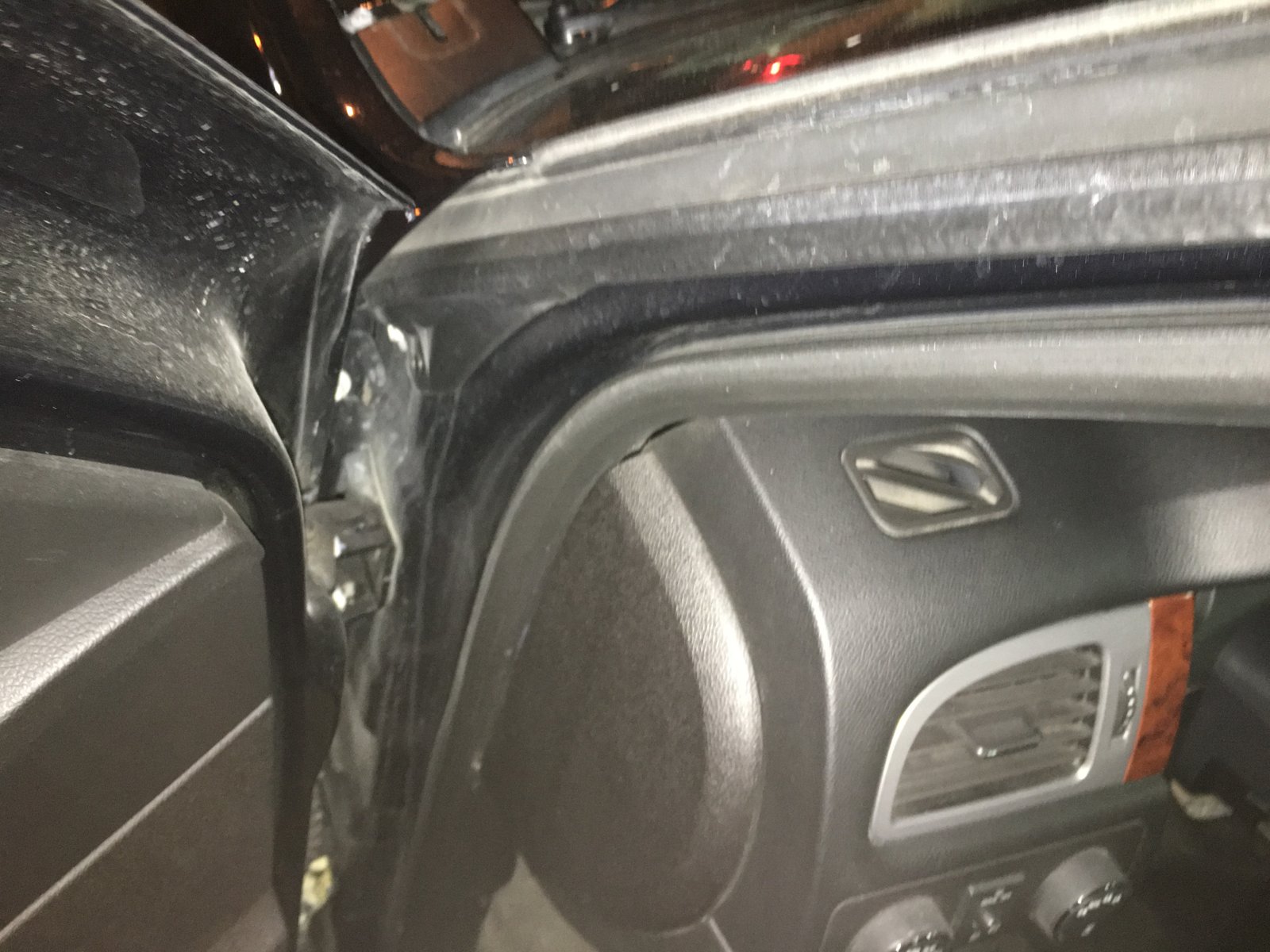

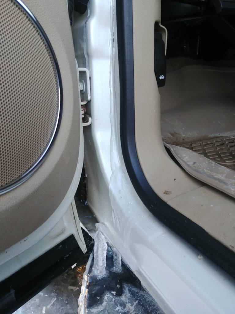

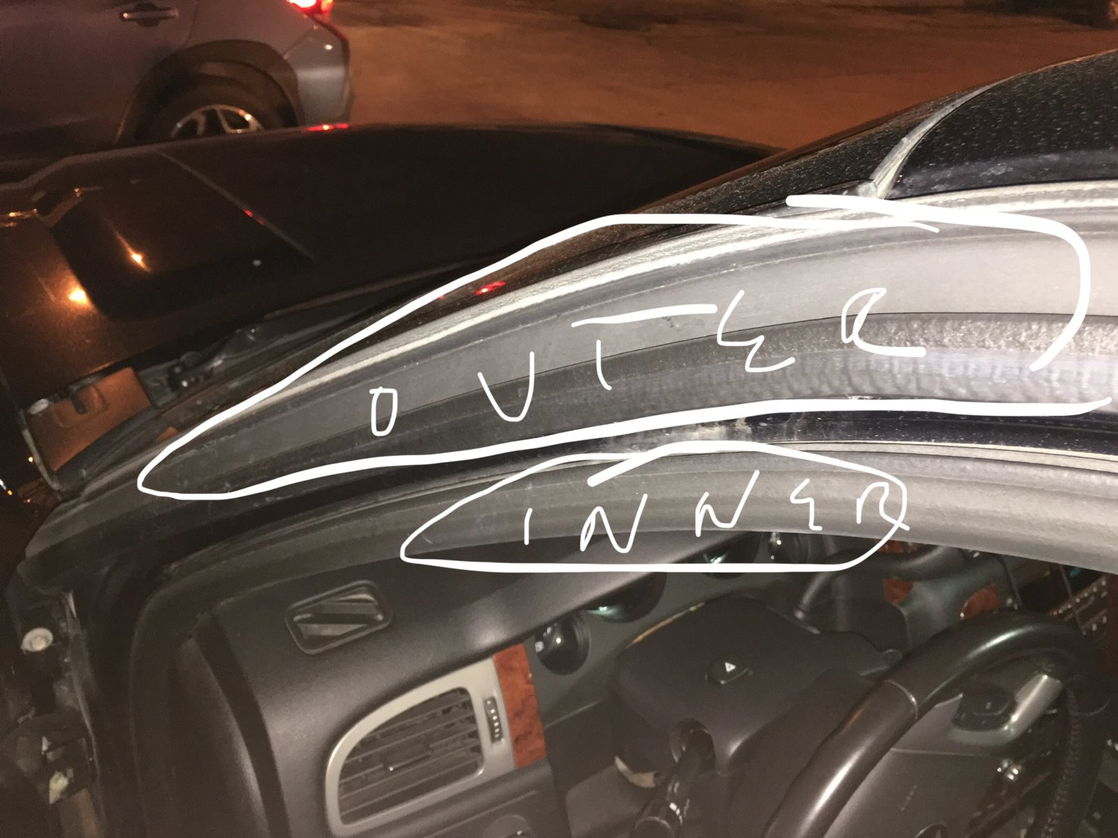

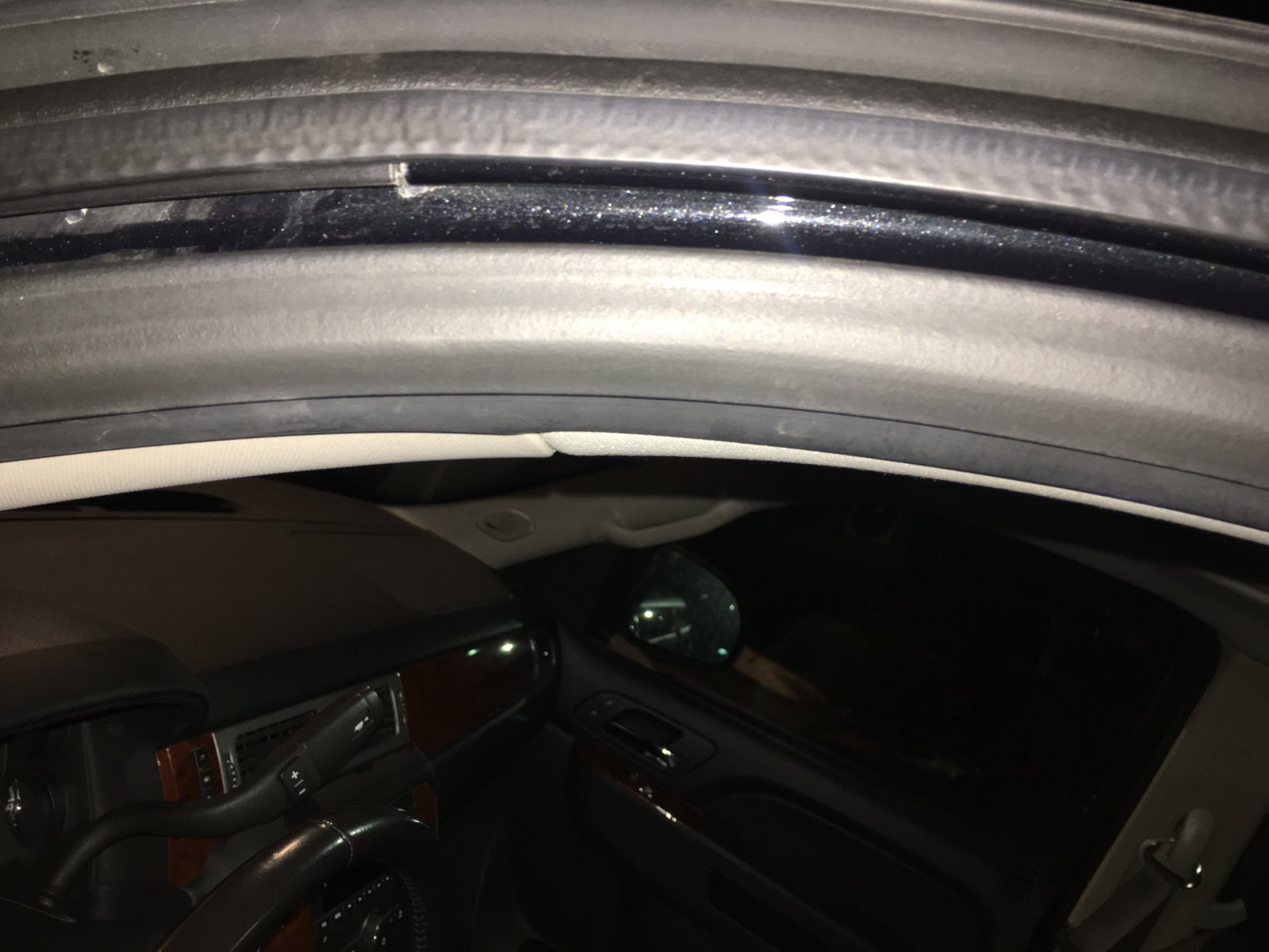

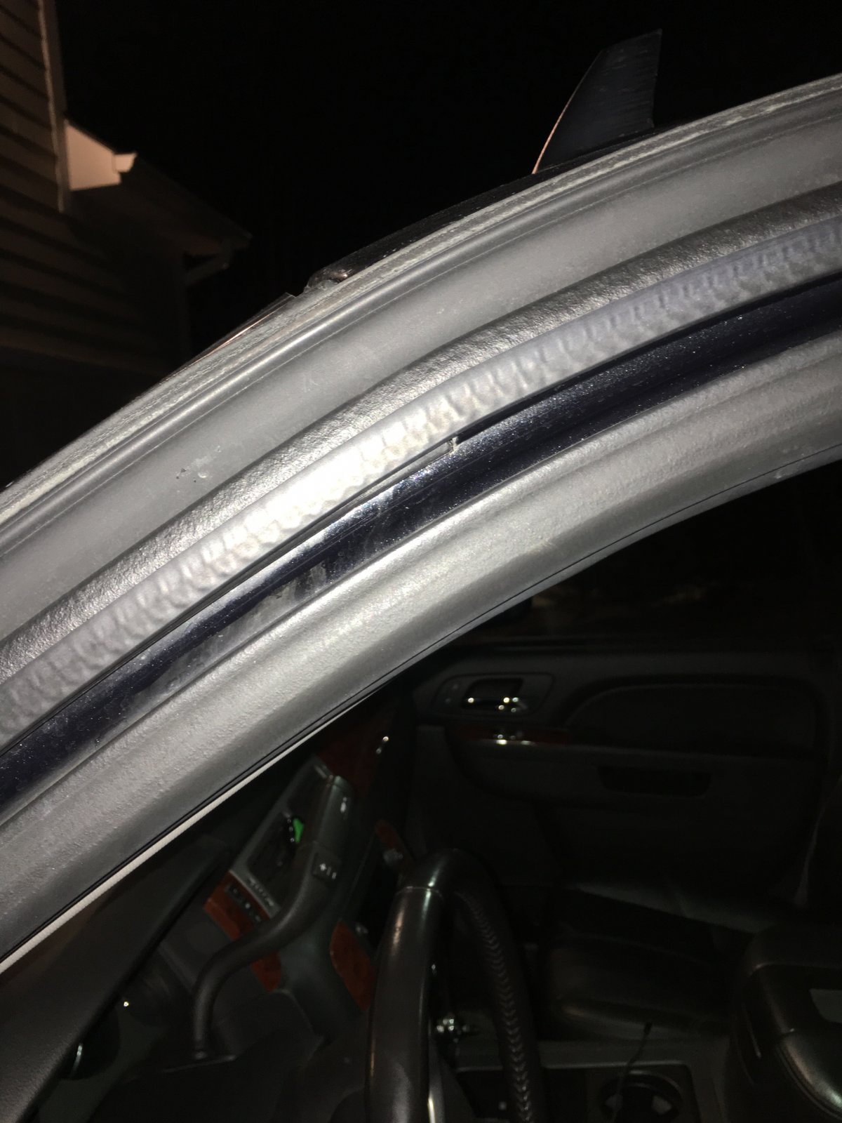

Here's photos of the driver's side and passenger side. It looks like both seals are there and good shape. When I looked at the ice build up previously, it was directly below where the hood and windshield meet area. Two of the pictures which are hard to see are looking into the front fender and an ice build up at the bottom of some piece of black rubber.
(I know it's dirty AF and it's driving me crazy [emoji43]the weather won't give me a break to get it all cleaned up)
Sent from my LGUS997 using Tapatalk
You’re getting water past that top seal somehow, was the windshield ever replaced?
I know its cold but you need to water test. Start at bottom, by hood and windshield, and work up until upu see it coming in.
I agree and was about to comment the same thing. Just dealt with a similar issue on a 07 Yukon I bought. Only it was the windshield had separated from the glue. I had them fix the top seal when they reinstalled the windshield.

I actually went and looked at mine again...
You see the little spot thats 2 diff black colors, yours goes white to black at top of windshield... I think its right there tbh.

Back to confirm (seems I forgot about everything while I was out of town)
I believe there is water coming in at the point at the top of the windshield, although I can't get the pictures to load from previous poster. Is there a fix to this spot?
I have also noticed I think there is water getting in at the lower part of where the door and front fender meet. I am running slightly larger and more offset wheels right now and wonder if this is the culprit of the lower water access. I also ordered some weathertech front flaps I plan on installing. I wonder if this will help as well as switching back to the original 22s versus what I'm running now.
