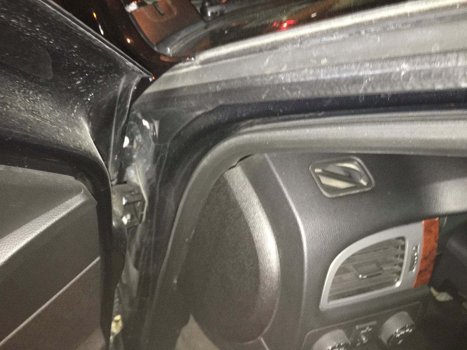

Here's inside the driver's door jam
Barely got a dusting of freezing drizzle last night and this is the amount of accumulation I'm dealing with. Passenger side door is basically similar about. Back two doors also get accumulation, just not this much but enough to freeze the doors shut.

That's crazy. Looks like that neighbor you pissed off is running his hose on your door. Seriously, though, your doors not sealing. No way.

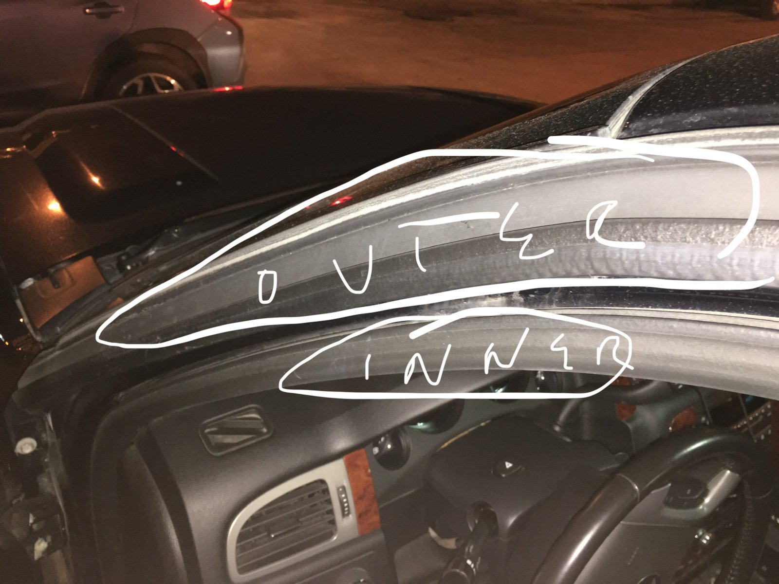

im looking at my seal, take a close look at where the seal installs on the chassis and you will find your "void" in the installation. The fact that it is leaking on multiple door seals makes me wonder if it has been repainted? you can find the leak by opening the door, pulling the upper seal back and using your garden hose to run a gentle stream of water behind the seal and watch where it is leaking past it's install channel. Unless your hose is frozen also? Yikes! My native state is CA and is FUBAR but we are in T shirts by 0900 lol.

There are 2 seals, inner and outer. The inner is there but I can’t see your outer... they are both behind the door and tge outer runs front to back, make sureits there and correctly installed.
Now I'm wondering what seal you are talking about
To me it looks like all the seals are good (at face value)
It would explain a lot if this is being caused by seals that are missing. But I'm not sure what exactly to look at to make sure that is not the case

Open door and Take a pic of the top of the inside of your drivers door jamb. A pillar is what its called. Ill see if seal is there.
