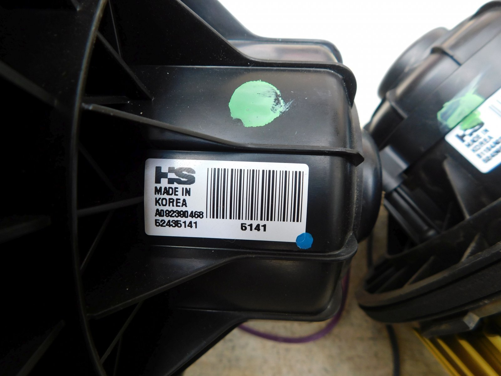

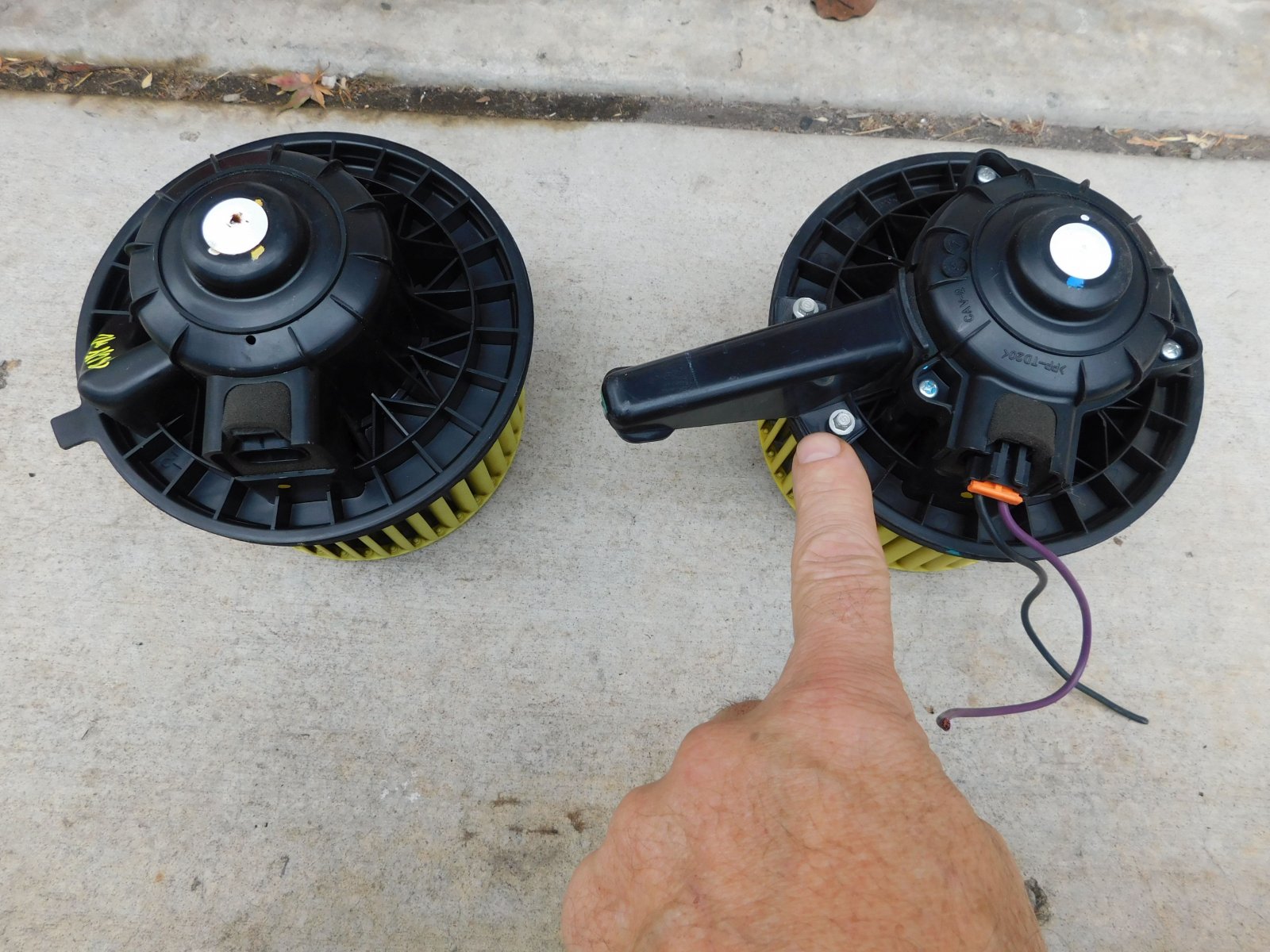

the catch here is with your 2008 you might want to pull the old one out and check the design
in my photos below the one I am pointing at is the old design on the right with a "airtube" that cools the motor from a corresponding slot in the airbox,
the one on the left is the new design and it is self-cooling
both will fit, but if you replace the old design with the new design you will have a open hole in the airbox and if you have the new design and put a old design on it will not have any cooling.
I am not sure what year they changed the design but it seems to be early on your 2008 could have either design.
both of my examples are OEM made in korea
rockauto shows either design for the same year so best to get under there and check it out before buying
***to remove the blower lift the orange locking tab from the harness connector squeeze the tab and the harness pulls out, then there is one screw to remove then you lift the plastic tab visible on the left blower motor in my photo then twist the whole thing I believe counter clockwise and then it will simply slide out.
View attachment 445484View attachment 445485View attachment 445486
