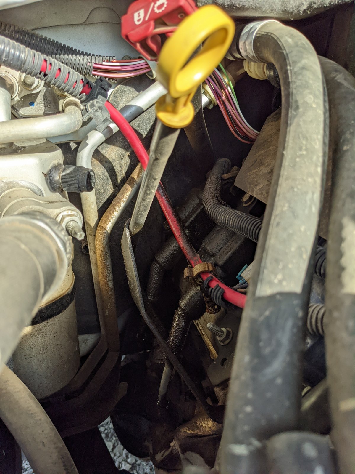

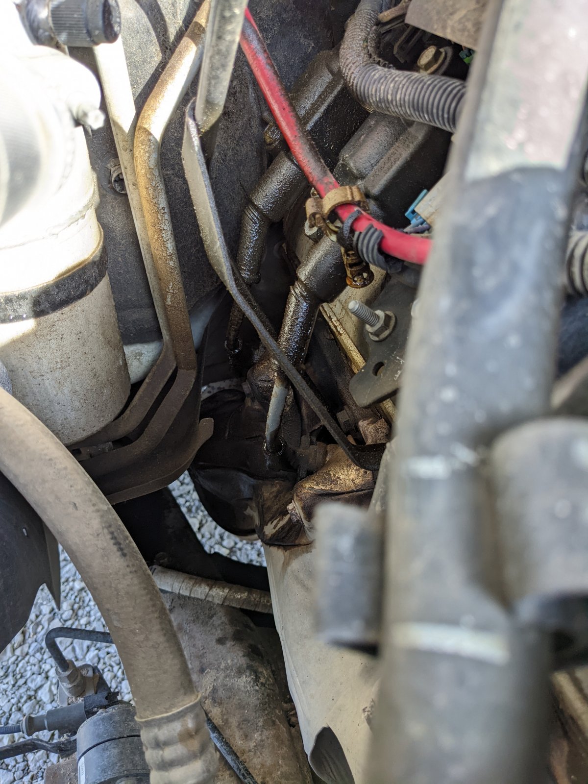

Been fighting this problem. Replaced a bad head gasket recently. Still leaking, more so on long drives, then ends up on manifold stinking things up. I'm not a mechanic by any means. It's hard to see back there. I did recently also replace oil sending unit. That area is dry. Any ideas where to look, would be appreciated.

Been fighting this problem. Replaced a bad head gasket recently. Still leaking, more so on long drives, then ends up on manifold stinking things up. I'm not a mechanic by any means. It's hard to see back there. I did recently also replace oil sending unit. That area is dry. Any ideas where to look, would be appreciated. View attachment 371514View attachment 371519
I should of added 2008 Tahoe LTZ. 4 wheel drive.

Looks to me like the coolant tees are leaking Dexcool right onto the coil and wires. Common problem. If so, time to replace the tees.
