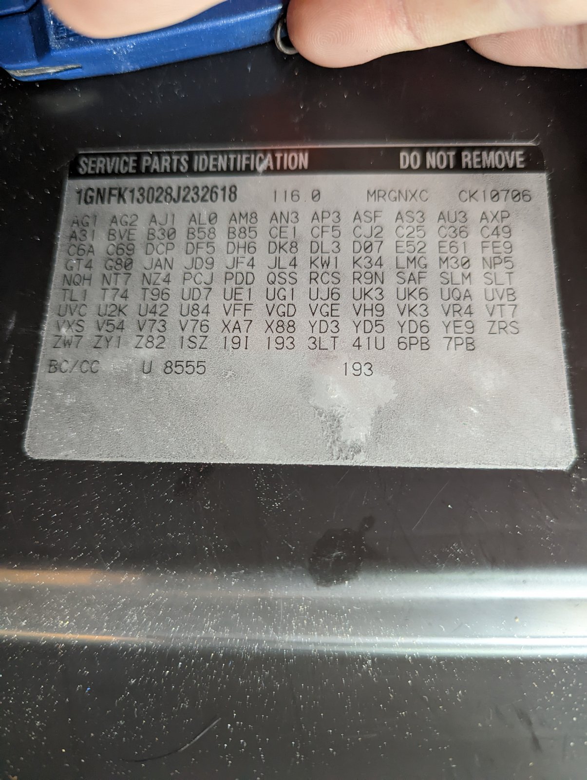

Post up a picture of your RPO sticker. Should be on the door if your glove compartment. It will have a bunch of 3 letter codes in it. That will help us help you determine what your LTZ has for suspension for sure. I am thinking that the LTZ’s came with AutoRide and AutoLevel. At least my 2009 LTZ did.

Here are the codes as requested. @wjburken

Unfortunately your understanding is correct that you don't have the autoride or autolevel suspension. ZW7 is premium smooth ride which means yours has conventional shocks and springs. The bummer is that you can't easily add the factory autoride/level components, but the good thing is that you can upgrade to a better conventional setup without having to disable the automated system in the process. Lots of good threads here on how to do that, and Trey is offering some good input above also.

Thanks for all the replies. I think perhaps the best option is to replace all the warn bits, and upgrade the factory shocks/struts. I will take a look at the King / Fox setups, thanks for the advice there. I really just want to feel less bumps. While I would have loved to retrofit the factory magnaride option, I do understand that would be quite a large undertaking, and not worth it in the end. If I ever trade trucks, I'll be sure to get those options already installed.
