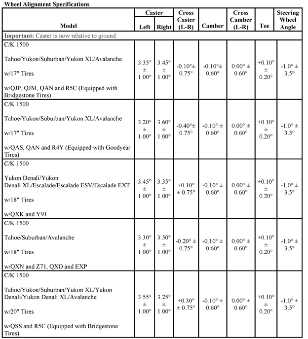

2008 Denali alignment spec
Bigjimmy
Jun 9, 2016
63
22
Just about to fit new front upper control arms and lower ball joints
Any suggestions on what alignment specs should be?Ive only got it levelled with 33s
Specs please as I live in Scotland and will have to provide them to the alignment shop

@Bigjimmy At the risk of sounding like an idiot I think they just need to get it as close to factory spec as they can.

The camber should be close to even on both LF and RF at +.5 degrees. The caster should be +2.5 to +4.5 degrees with about a half-(.5) degree lead on the right to allow for road crown.
The toe in should be -.05 to +.15 degrees on both sides.
Ride height should be even on both sides and of course the air pressure should be even.
This info is for close to stock rig but unsure if different on a leveled rig.

As above-Left hand drive rig correct? Caster lead LH then.

Yes, Scotland you’ll need to swap the US spec for caster with respect to left/right. Or start driving on the correct side of the roads. :D
My truck is lifted 6”/and I’m using stock alignment parameters and it’s great.
