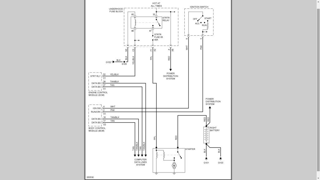

you could try replacing the starter relay first, but it sounds like you might have to take it to get looked at. do you have a code reader to do a quick scan?
pic of the starting circuit:
