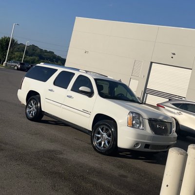

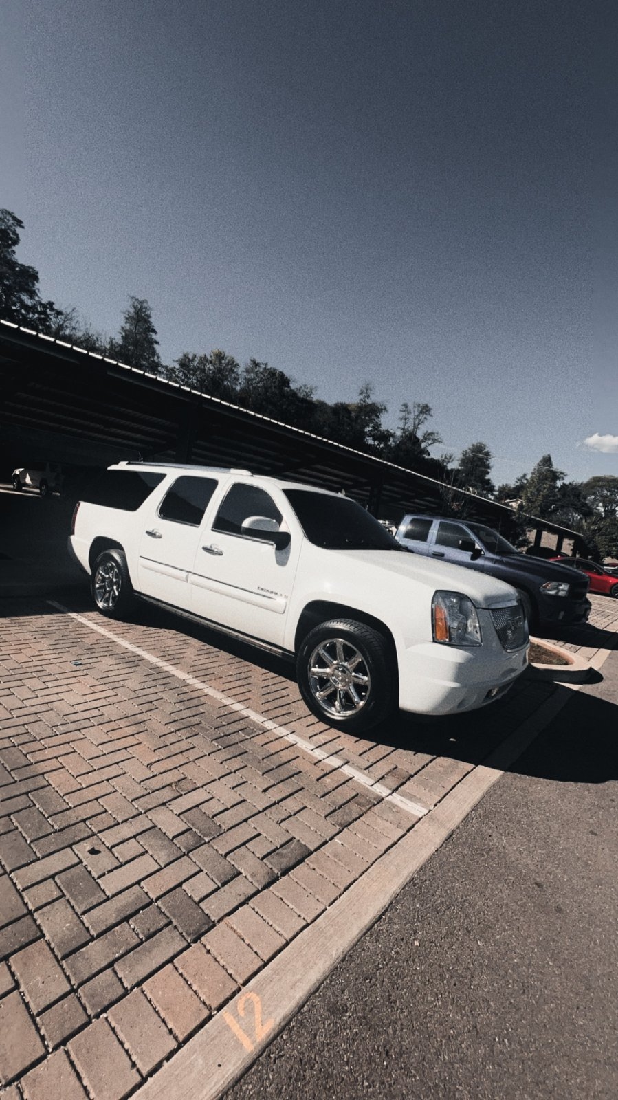

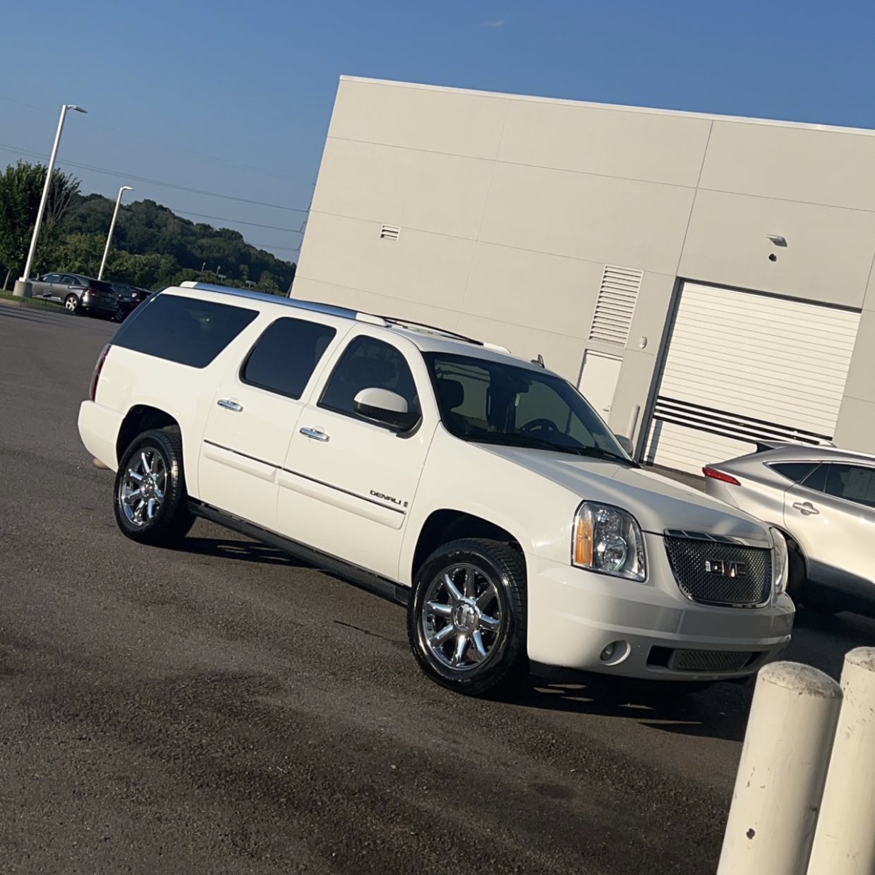

Why wouldn’t you do it? I’m only wanting to just to fit the wheels I want. I’m also 6’5 and have to duck under my trunk every it is fully opened
