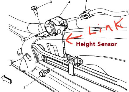

While there is no "factory" adjustments you can change out the auto leveling links on the height sensors found on each side of the rear.

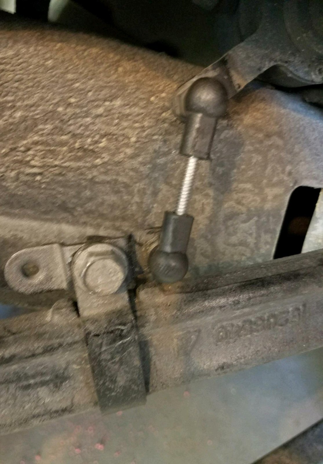

If you shorten the link I indicated in this pic it will cause the air suspension to not raise the rear end as much. You can buy 10x24 threaded rod from a hardware store which will fit in the factory plastic ball sockets after you remove the original metal rod.
Here is a pic of mine after I installed my 4/6 drop kit. I wanted to maintain the auto leveling feature for when ever I load up a bunch of people in the Burb or hook up to my trailer OR both.
You will just need to play with the rod length until you are happy.
