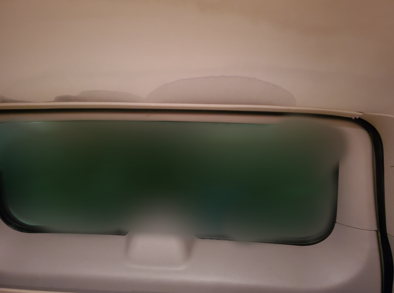

I'm assuming the extreme cold weather froze my rear wiper line and burst, when I tried to use the rear washer fluid I saw it was leaking into the cargo area above the headliner. Does anybody know how to access the line to fix it? Here's a pic of the leak location.

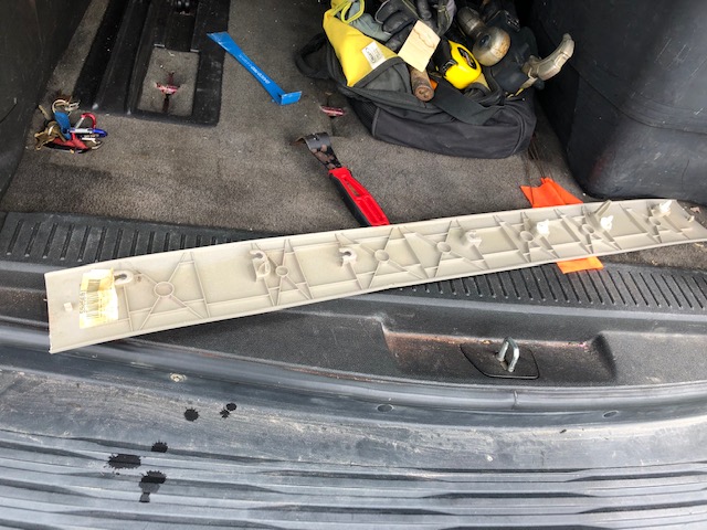

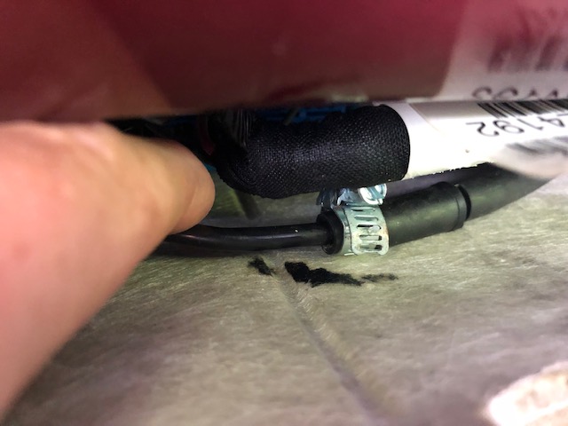

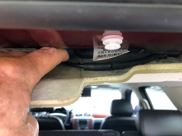

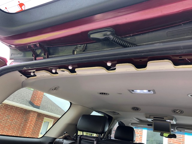

As expected on this 2009 Tahoe HYBRID (fixed rear glass) there is a connection for the rear washer plastic line above the headliner trim about center ways of the vehicle. Trim is just a few pushin clips and pops right off with a trim tool. The connector has gotten old and has stretched a bit so that the line does not fit snugly into it so I put a small aluminum screw clamp on it to make sure it stays. There is another connector under the hood that can blow off if this line gets stopped up. I would much rather the one under the hood pops off than have washer fluid running out of the headliner into the cargo area! Took about 10 minutes..... spent mpre time on here than actually fixing it LOL. Just another quirky little area to know about as your GM truck ages i guess.
