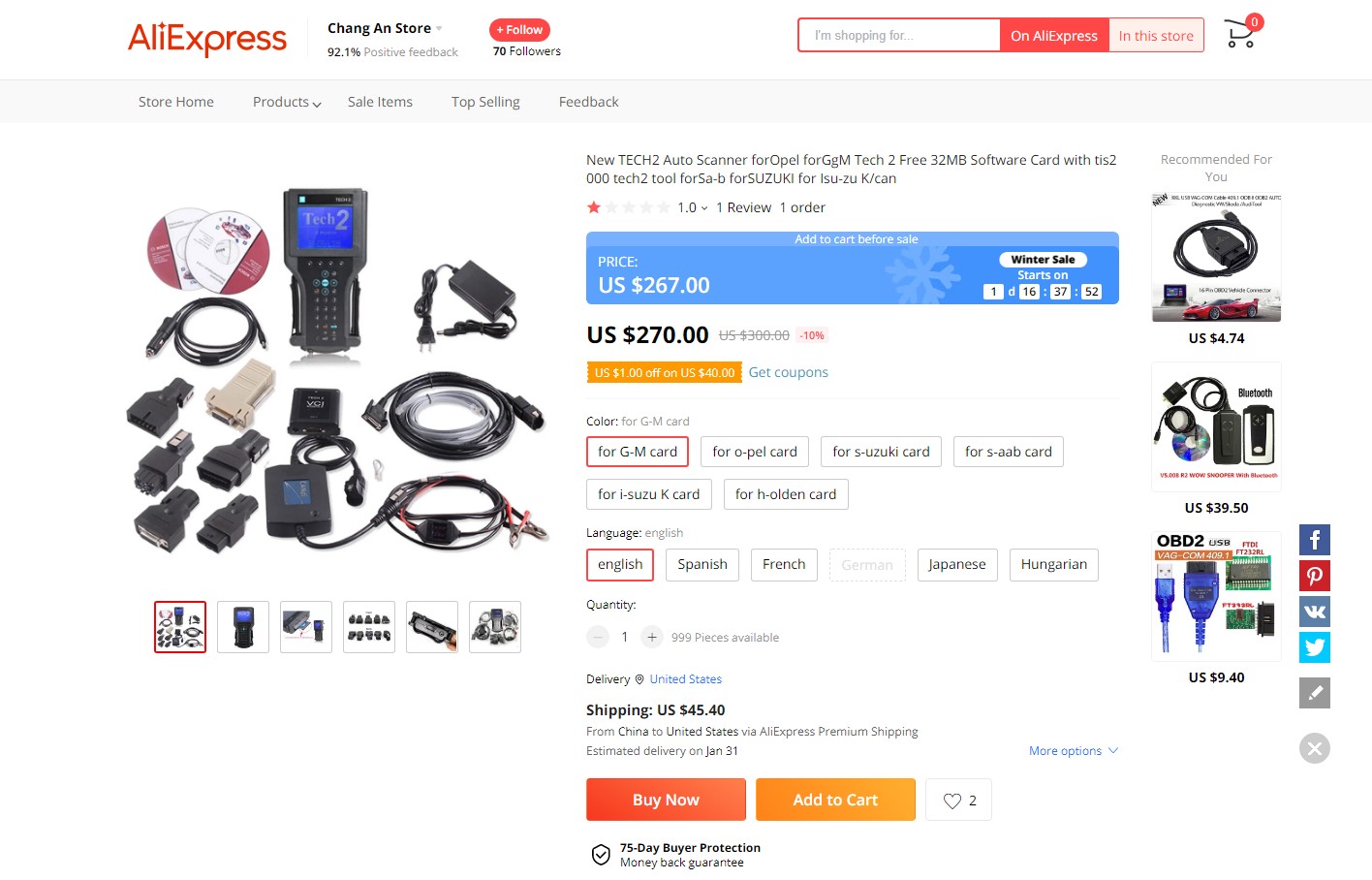

If you are going to buy a scanner, you would be best served by purchasing a Tech 2.

I would not buy a Tech2 unless you have a time machine to go back to 2014 went they went obsolete. Note that you still have all of the AFM/DOD components from your OP. The disabling has just been overridden in software but you still have AFM lifters and camshaft. My gut tells me that a plug or coil wire would trigger a P0301-Po308 instead of P0300. If you hear a loud ticking on one bank of the engine I would remove that valve cover, disable the fuel pump relay/controller and observe valve operation while spinning the engine. This vid is good background if it is a collapsed lifter issue

This is a little snarky but are you saying don’t use the $3k GM diagnostic tool available for $300 and gut check the truck? The only thing obsolete about the GM specific / Tech II scanner is it’s price.
