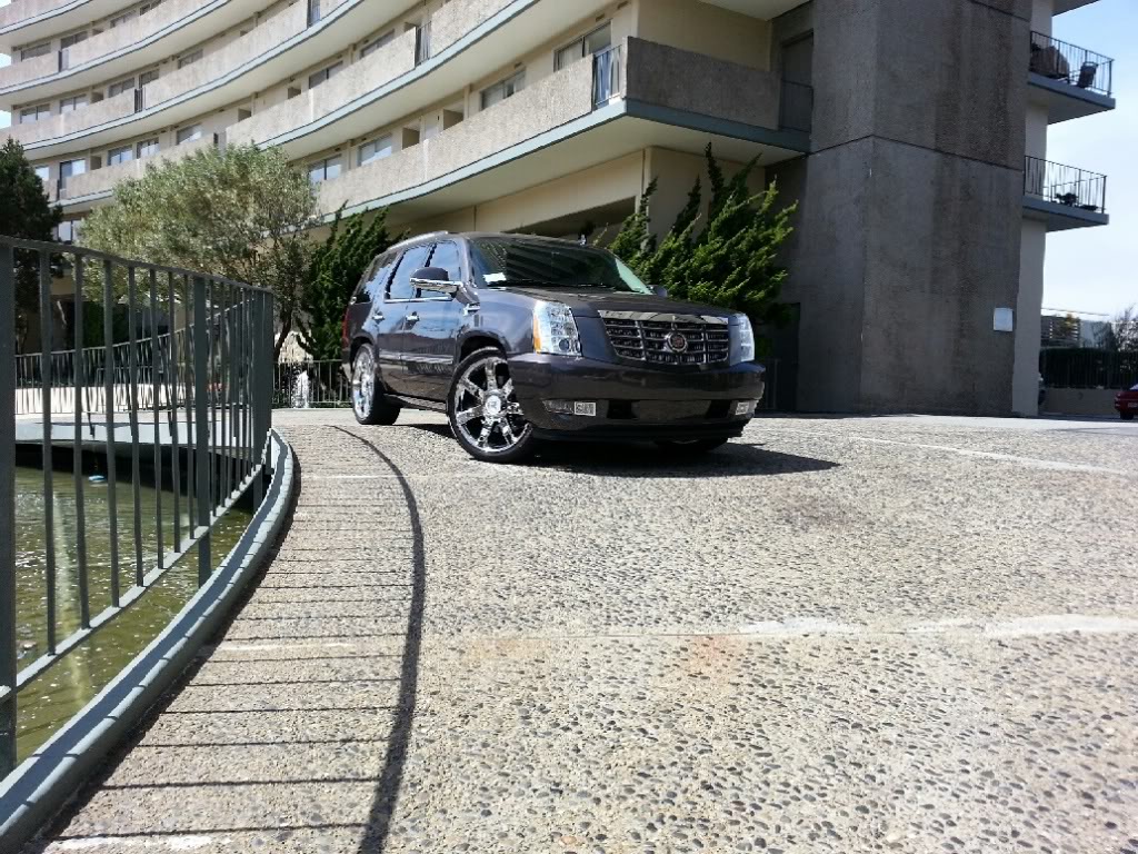

Hit up modded he has 26's and sits really low
