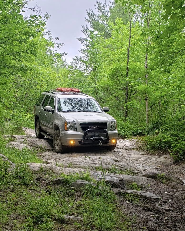

K I’ll post a before and after pictures. But I have the ReadyLift 2.25 leaving kit with 33” K02 tires. Plus a westin winch tray with a modded RoughCountry bull bar and a 10,000 lbs winch on the front!!! Lol lots of work done and even more to be done! Lol. Tomorrow I’ll post a pic. But to fallow the progress check out “416 Expedition”

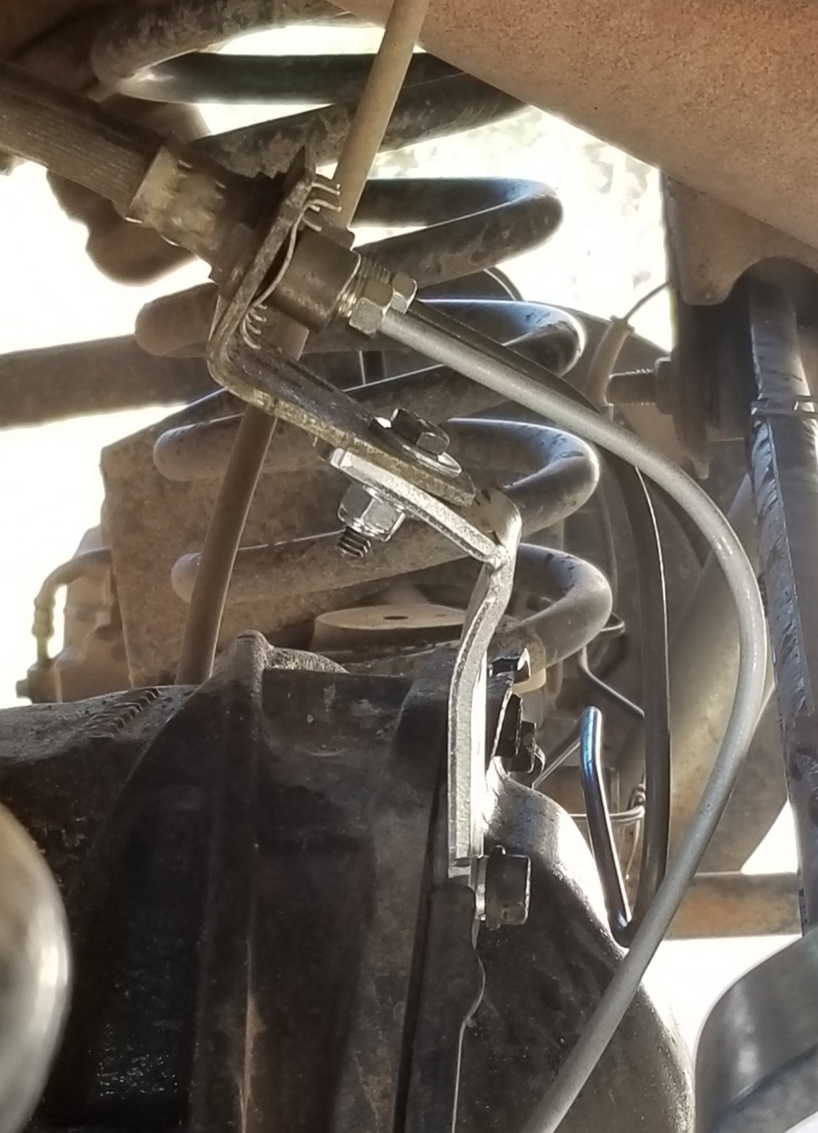

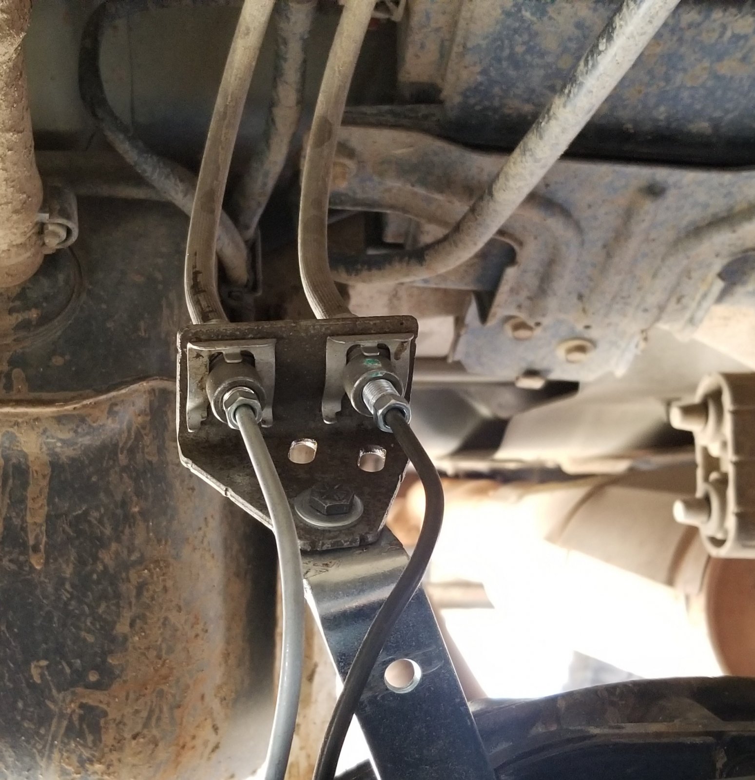

Well I have the answer for him a year later...
You will need longer rubber brake lines in the rear or the differential brake line bracket will break causing the steel lines to break too.
Then you will have no brakes...
I tried replacing my bracket with a heavy duty 1/4 inch bracket... It was taller but, it also broke and now I have broken my third and fourth brake lines.
I think the two rubber lines are stretching tight this causes the bracket to break from flexing and fatigue. Then steel lines start flexing and they will break too.
I think what it needs are two longer rubber lines.. Anyone have a source for those?

My ProComp lift has a relocation bracket that dropped the rear connector block and changed the angle to orient the the flexible hoses more downward IIRC. I’ve had no issues to date and it’s been flexed a LOT.
With respect to the OP (and not slamming the product he bought, I’m not familiar with it) I found in my research that one of the differentiators between the low cost kits and the more expensive solutions was the inclusion of parts to resolve things like brake lines.
Wich connector block was relocated? I have two blocks on mine one is above a frame rail and the other is attached to the differential. I wonder if the upper block above the frame rail needs to be lowered below the frame?

I will get you a photo and post it later. As I recall I moved the upper block from above the cross member to below (Or maybe beside?). The bracket they supplied you could easily duplicate from hardware store bits and there’s pictures in the ProComp installation instructions.
The major pain as I remember was getting the block unbolted from the crossmember working in the confines between the frame and the floor pan.

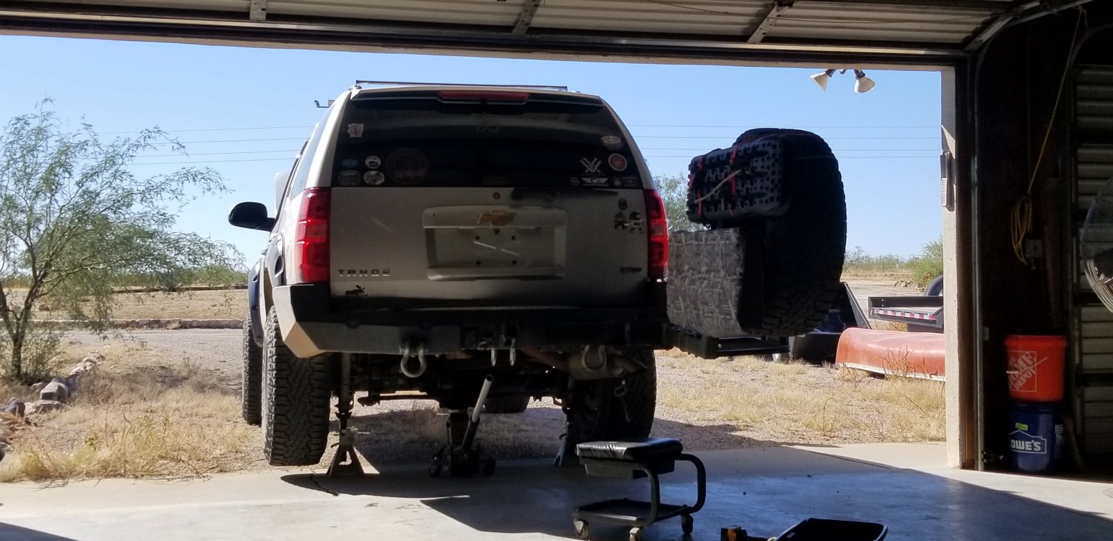

@Bill 1960 it is pretty tight in there. I wish I had a lift in my garage... For that matter I wish this garage had a taller roof so I could jack it up more than a foot or two... lol
Tozan
Overlander
Nov 12, 2016
646
997
Beauregard, Louisiana
I fixed it for now. Since I was replacing both lines I was able to bend them to fit the new location.
I hope this will last for a while but either way I am going to try and order a new set of SS lines to replace the stock rubber lines.
Sucks I have to move it outside when I jack it up... I miss my old warehouse in Reno with the 45 foot ceiling and car lifts. But, living in the middle of nowhere is well worth it...
