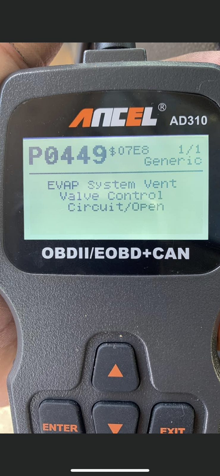

Hello everyone I have a 2007 GMC Yukon Denali which gave me the P0449 code. I searched here and online and found that the most common fix was either the purge valve solenoid or the vapor canister. I replaced them both. The one in the engine bay and the one in the rear above where the spare tire goes and the code is still there. I also replaced the gas cap and no luck. After I erase the code it will come back in a matter of minutes. Any help will be appreciated.

Hello everyone I have a 2007 GMC Yukon Denali which gave me the P0449 code. I searched here and online and found that the most common fix was either the purge valve solenoid or the vapor canister. I replaced them both. The one in the engine bay and the one in the rear above where the spare tire goes and the code is still there. I also replaced the gas cap and no luck. After I erase the code it will come back in a matter of minutes. Any help will be appreciated. View attachment 366621
That code is telling you that the Vapor Canister Vent Valve is no good or maybe the hose is bad. Did you use OE parts?
