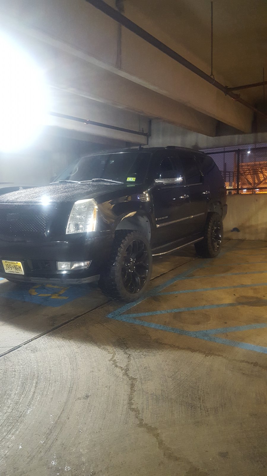

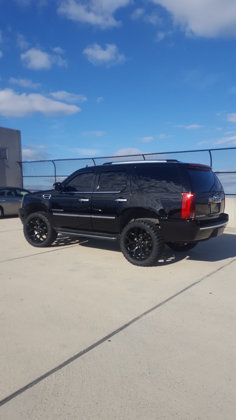

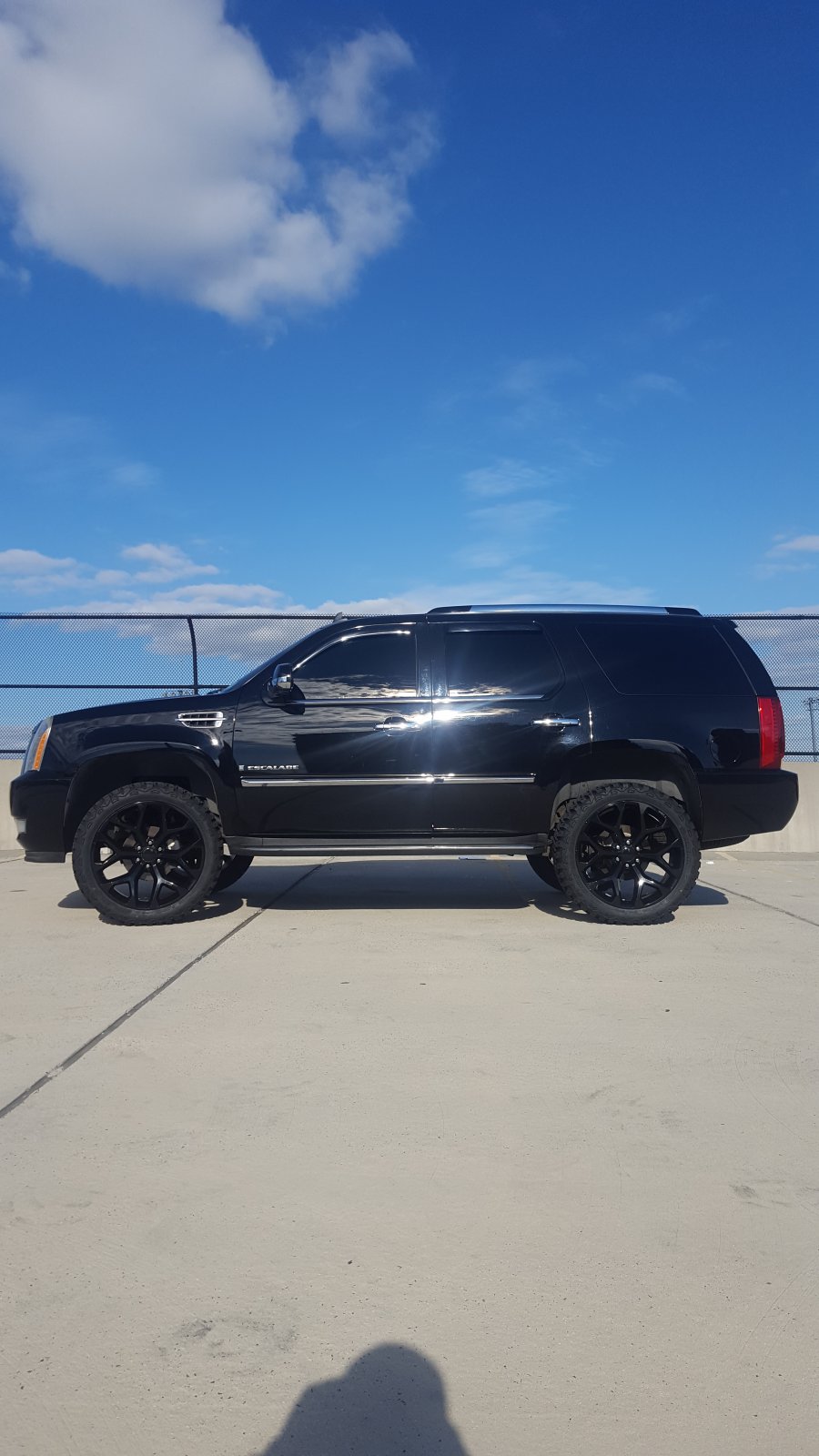

1st pic is a few months ago with the factory grille.

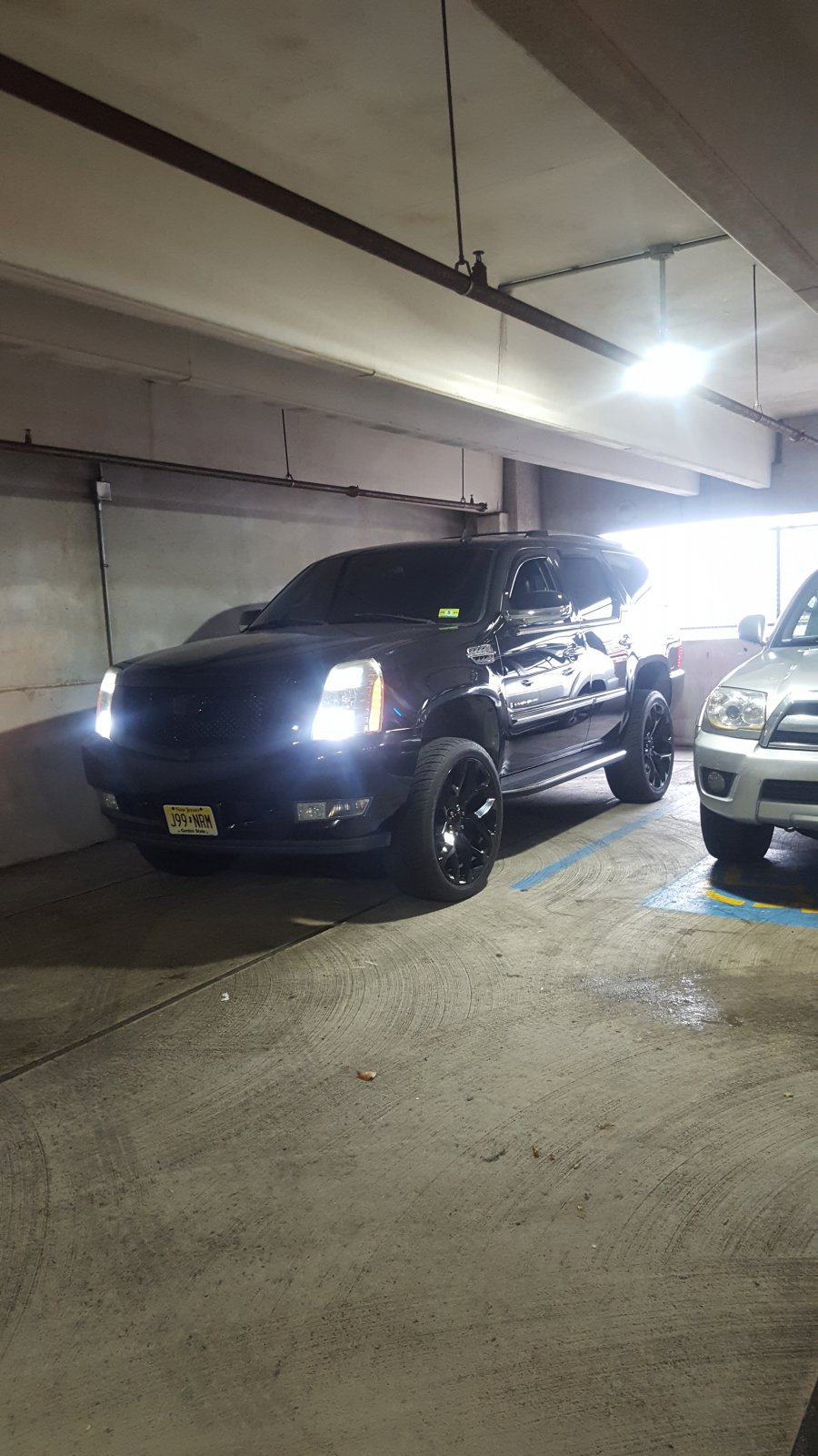

2nd pic is how she sits now with the mesh grille.
I am attempting to fit 35" tires. Will be a tight fit but I will make it work after the lift install. Tires that am I running now are 33.3" tall and I just had to cut alittle on the front inner bumper.

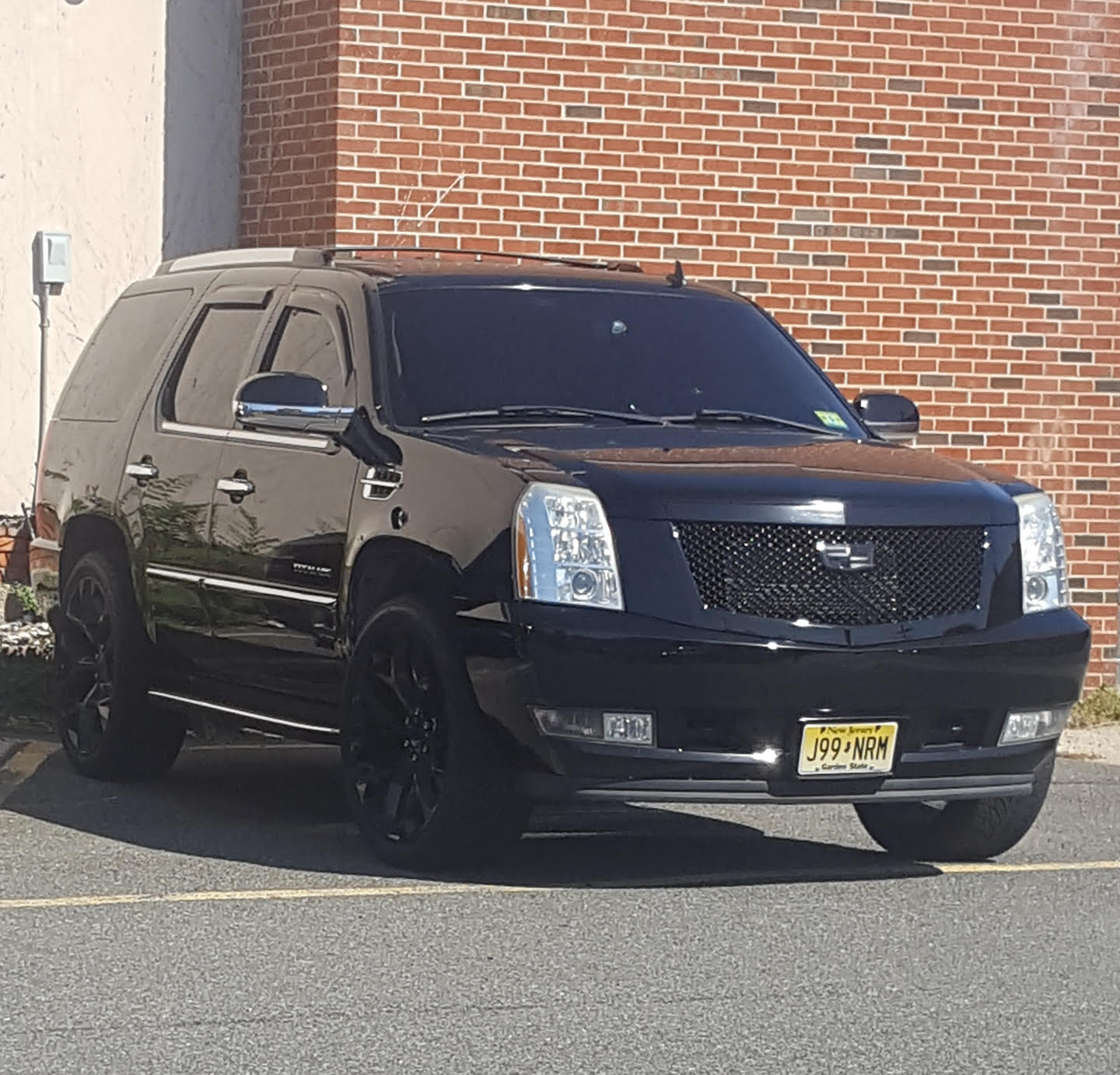

Looks leveled in this pic but trust me, its not.

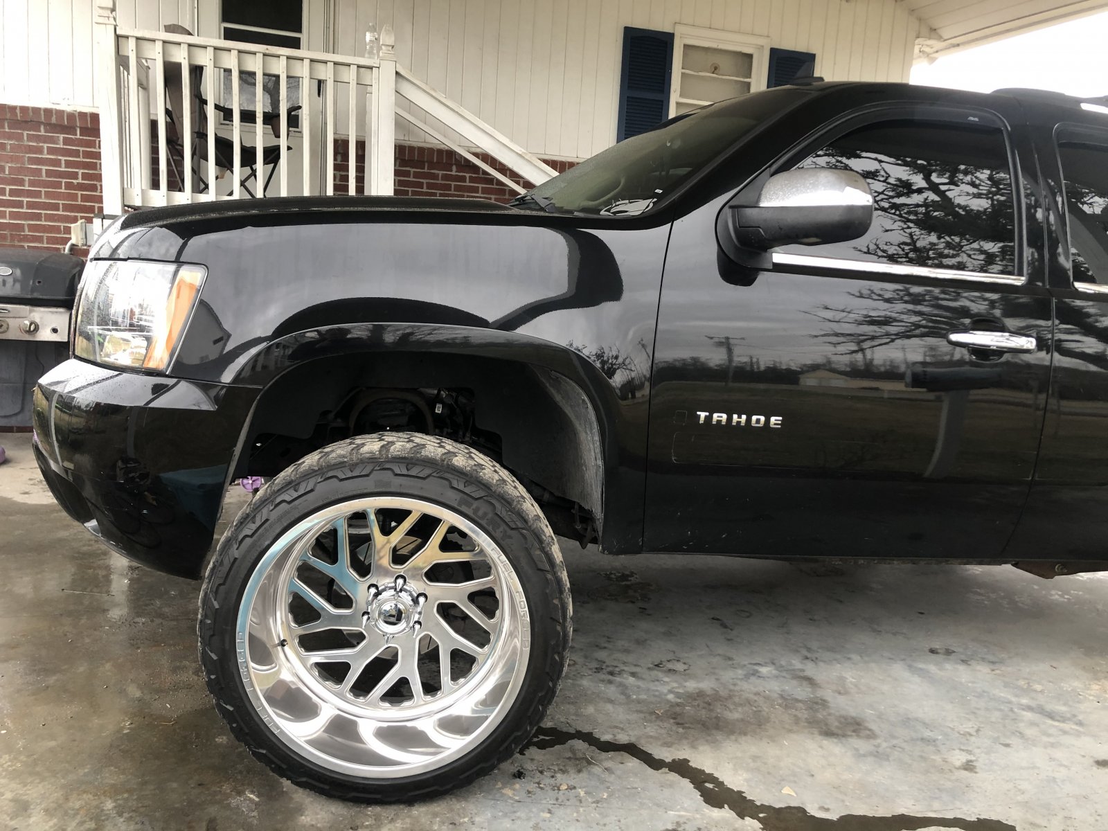

You might could stretch it another .5-1” but your angles won’t be the best without a crossmember drop probably eat up ball joints and cv axles at that point but I’ve seen crowd run up to 4-5” worth of leveling kits all day as long as it stays on road you’ll be fine if you actually plan on off roading at all again probably be breaking stuff the biggest I ever went with leveling kits was maybe 4” maybe 5” if I was trying to clear some big tires for a show like in the pic here and it was only for a couple days rode like shit and was for the show I lowered it the next day cause my angles were so bad I had to take the cv axles out

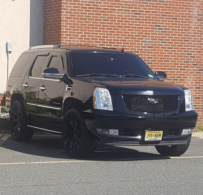

35" tires are looking and riding good. Here is a pic but i will get better pics in a few days.
