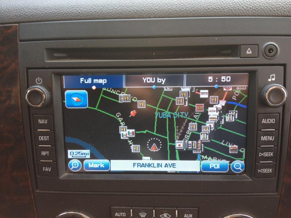

We are getting ready to purchase a 2007 Denali XL that has almost every option except for rear entertainment. It has the Bose system with Nav and we are trying to figure out the best way to add rear entertainment. Attached is a picture of the existing unit.
We would like to be able to control/change the DVD from the front head unit, does anyone know if this unit is compatible to play DVD's? If not, what is the easiest plug and play head unit that we will need, OEM or non OEM?
Would it be recommended to purchase the OEM flip down unit or upgrade to a aftermarket unit? If we are to upgrade, would anyone recommend a certain brand to get/stay away from? Has anyone cut out the dome in the headliner? Is there anything to look out for?

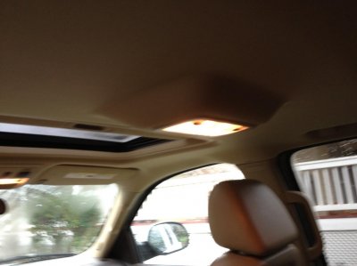

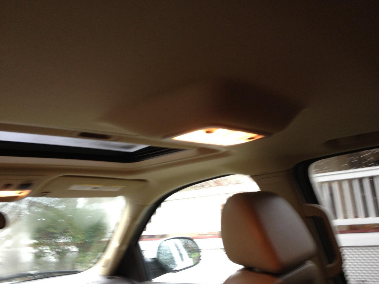

I picked up the Denali yesterday have discovered that this head unit is navigation only and would like to add DVD. Has anyone cut the headliner to add a flip down unit? Will the stock unit cover the entire hole after cutting out the dome (see picture)?
Is it possible to swap out the head unit for a newer OEM unit and then install the OEM flip down screen?
Trying to decide if that is too much trouble and instead should just install an aftermarket dvd (headrest or flip down).
Any advice would be greatly appreciated!

You only have DVD movie playing capabilities if you have the RSE package. Otherwise it's only DVD-ROM nav discs. Why not just headrest LCD displays? Each one has it's own built in DVD player. Way easier to do then cutting up your vehicle to add that RSE.

talk to the guys at navrepair.com they will know exactly the best solution for you. Trust me. I have an 07 escalade with nav and no RSE but i sent my nav unit to them and they activated the U42 option for RSE and now i can control the dvd's from the front while my kids watch the movies on the headrest monitors.

Nope you have to be in park to watch with the factory system unless you get a GM LockPick. I've got one in the escalade and can watch DVD's/adjust nav address while in park.
@Alan: If you are looking at aftermarket look at the pioneer head units. I have the AVIC-Z150BH in my avalanche and it can play DVD's up front. It's their flagship unit that has nav too. If you don't want nav and just want DVD movie playing capabilities there are cheaper head units they make that are nav-less.

Correct, as far as I know my head unit cannot play DVD's at all. Currently I cannot watch a dvd up front while in park.

I have an escalade so Im pretty sure all escalade nav units can play dvd's. So I don't think you will be able to do what you want unless you get an aftermarket head unit or buy another oem nav unit that can play dvd's.
I was in the same situation as you where my kids are too little to be able to reach the headrest dvd player to switch a movie out so I needed to be able to control it from up front.
