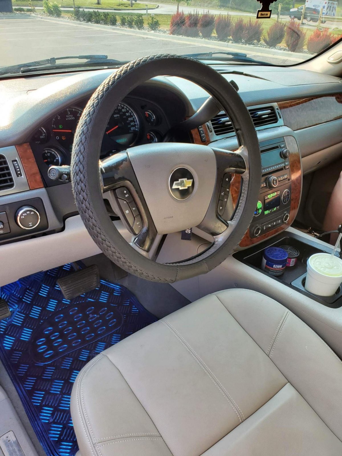

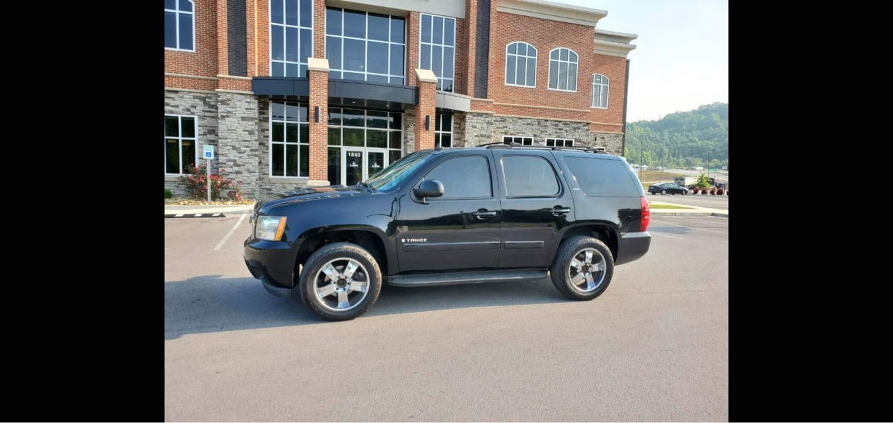

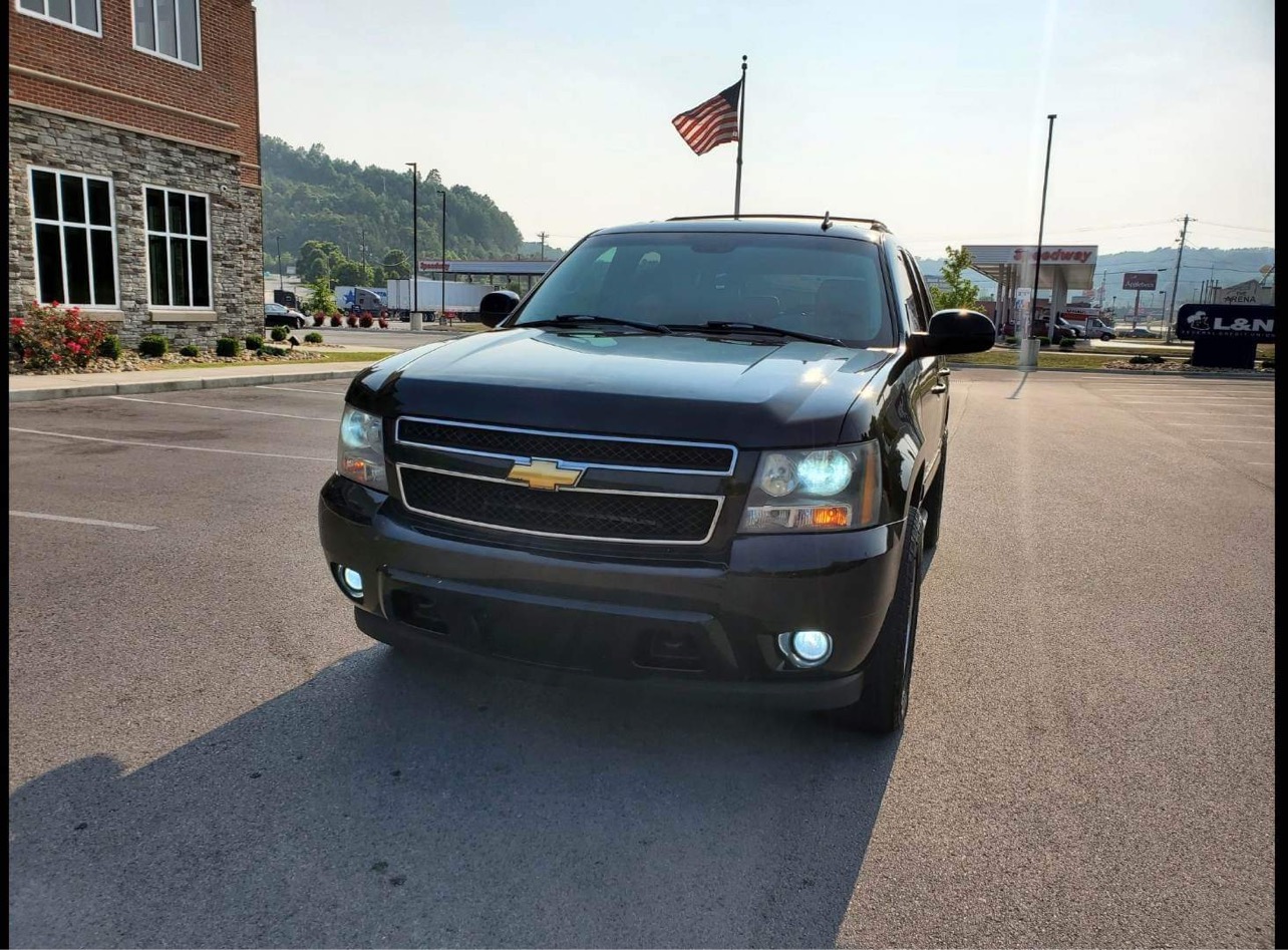

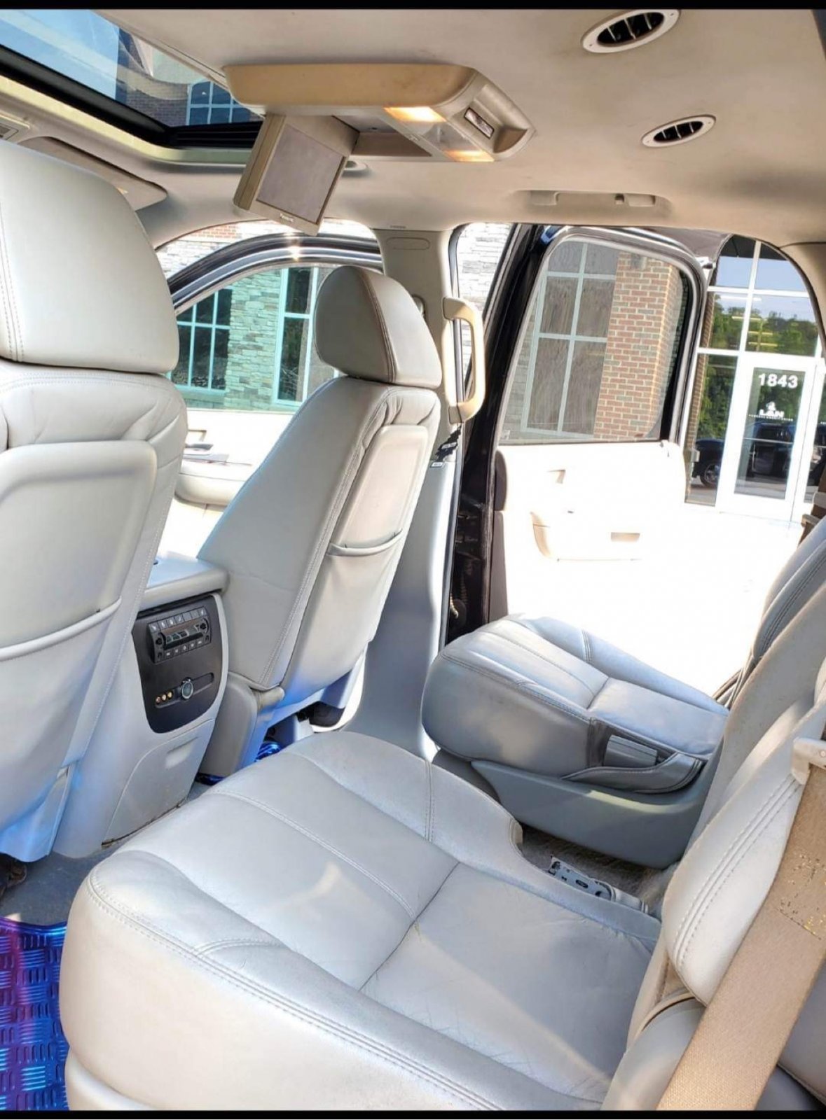

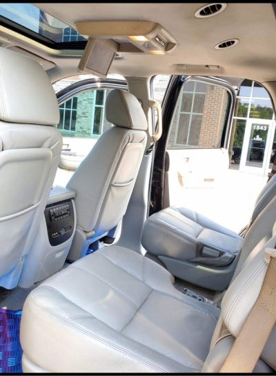

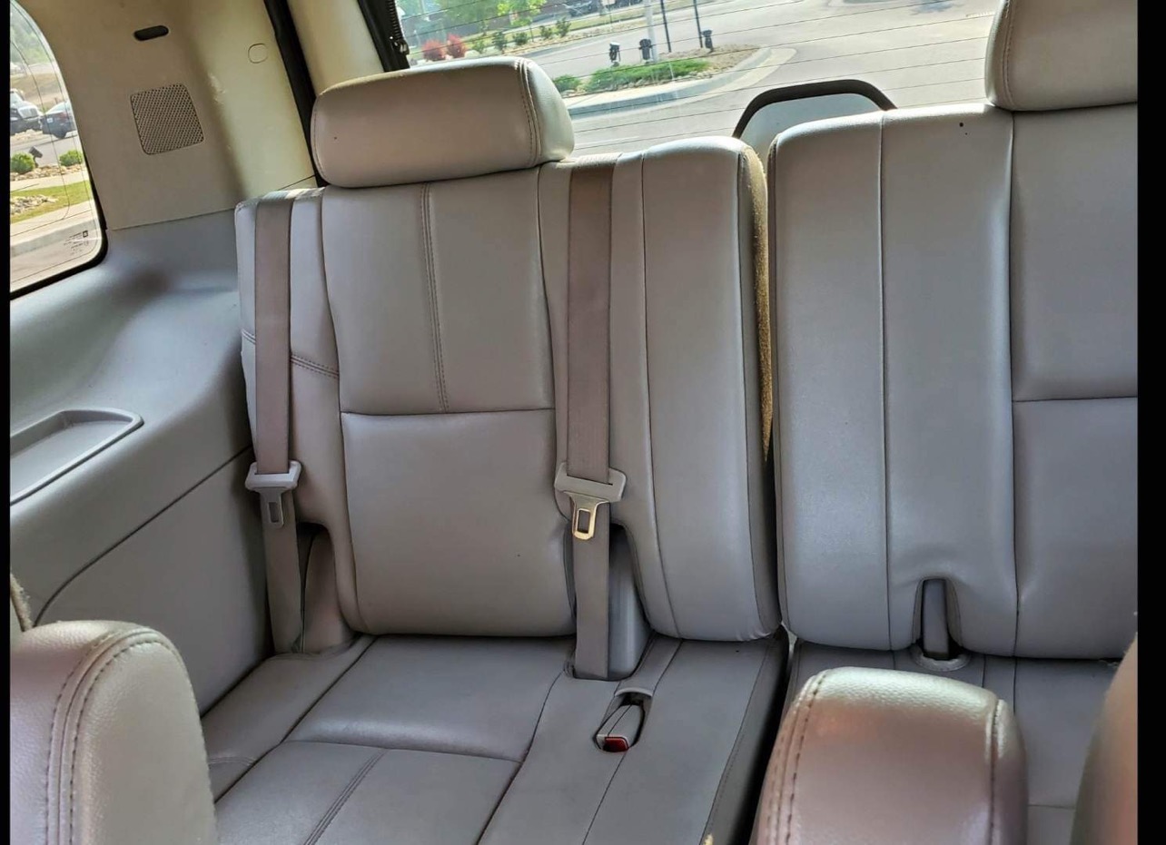

Looking for some advice before buying my first Tahoe. I am looking at a 2007 for a grocery getter for my wife.
We mostly take my truck everywhere but are looking for something bigger to accolade kids. She will drive this at max 10k a year.
Local guy has a 2007 Tahoe ltz for sale with 162k on it. I’m looking at it this weekend but I’ve attached pictures for reference. He’s asking 9k. Does that sound like a ok deal? What are some things to look for/common issues with these things? It looks clean but I’m not sure what kind of service records he has. Not worried about minor things, as I do almost all maintenance on all my vehicles myself unless it’s major motor or transmission work.
Thanks for the help!

The interior looks great save for the grungy steering wheel and busted dash, normal wear items. New steering wheel is $300 with new controls too.
Check all the fluids, run the transfer case through all the modes. Test every button and switch.
One of the switches between the cigar lighters was probably de-activated during a recall a long time ago, that was the heated washer fluid. That's the button all the way to the right. That one may not work but the others ought to.

Looks nice. Paint on hood is intact. Maybe it had a respray? It’s LTZ so you get autoride and rear air suspension. Best ever for the ride, towing and value now that replacements GM strut units have a lifetime warranty and repair under $2h ea.
