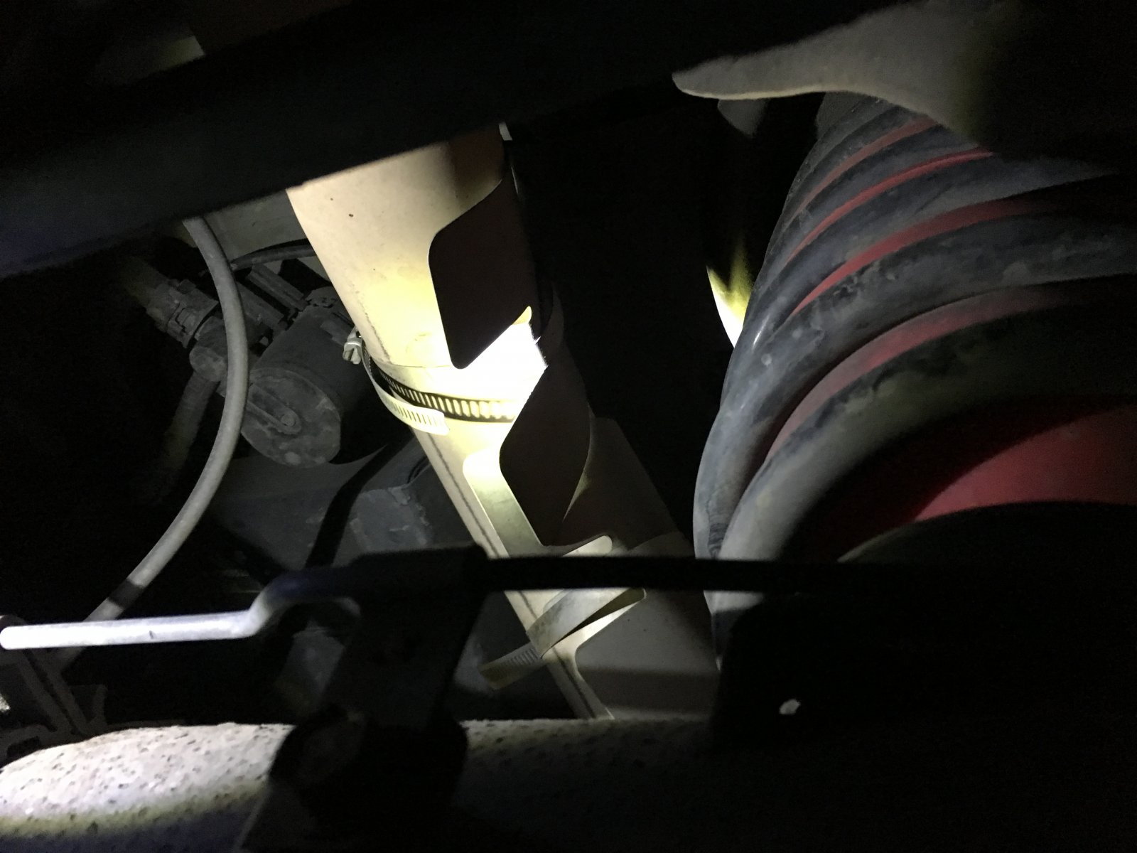

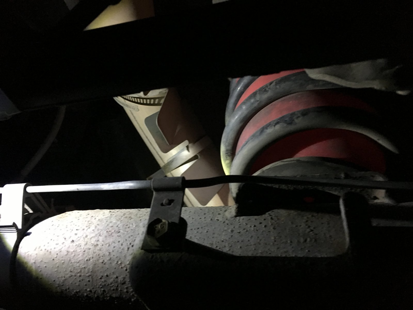

I have airlifts on my 2006 xl Denali. The passenger side bag is pretty close to the exhaust. We installed it on mine. Keeps the airlines protected as well.
Would it be possible get a picture where you put heat shield .. because exhaust be same and yours worked out . I seen it's close to exhaust on passager side. Less mine the exhaust is altered from stock . I was reading the top hole where stem goes up needs to be a inch hole by stem . That should be tricky to do ..

I’ll grab a shot for you when I head down to the truck to leave for work in a few.

It’s an odd angle to get up in there and take pictures of the heat shields... lol
DD0389A7-C39E-4A9D-8F57-0AA5F519B40C.jpeg 0315AAFB-0E5B-4CE1-B6A2-F7A7FBE7A9A2.jpeg

I do appreciate it ! That's great ! I get the idea now
