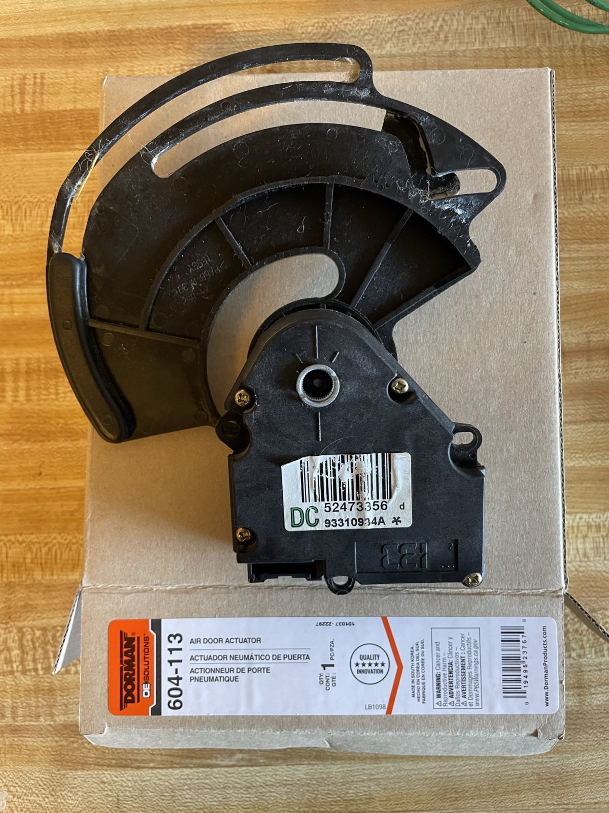

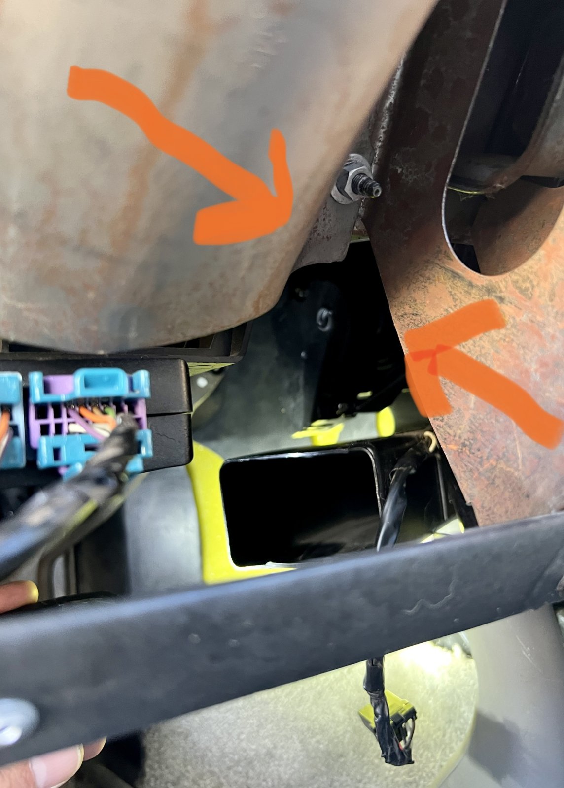

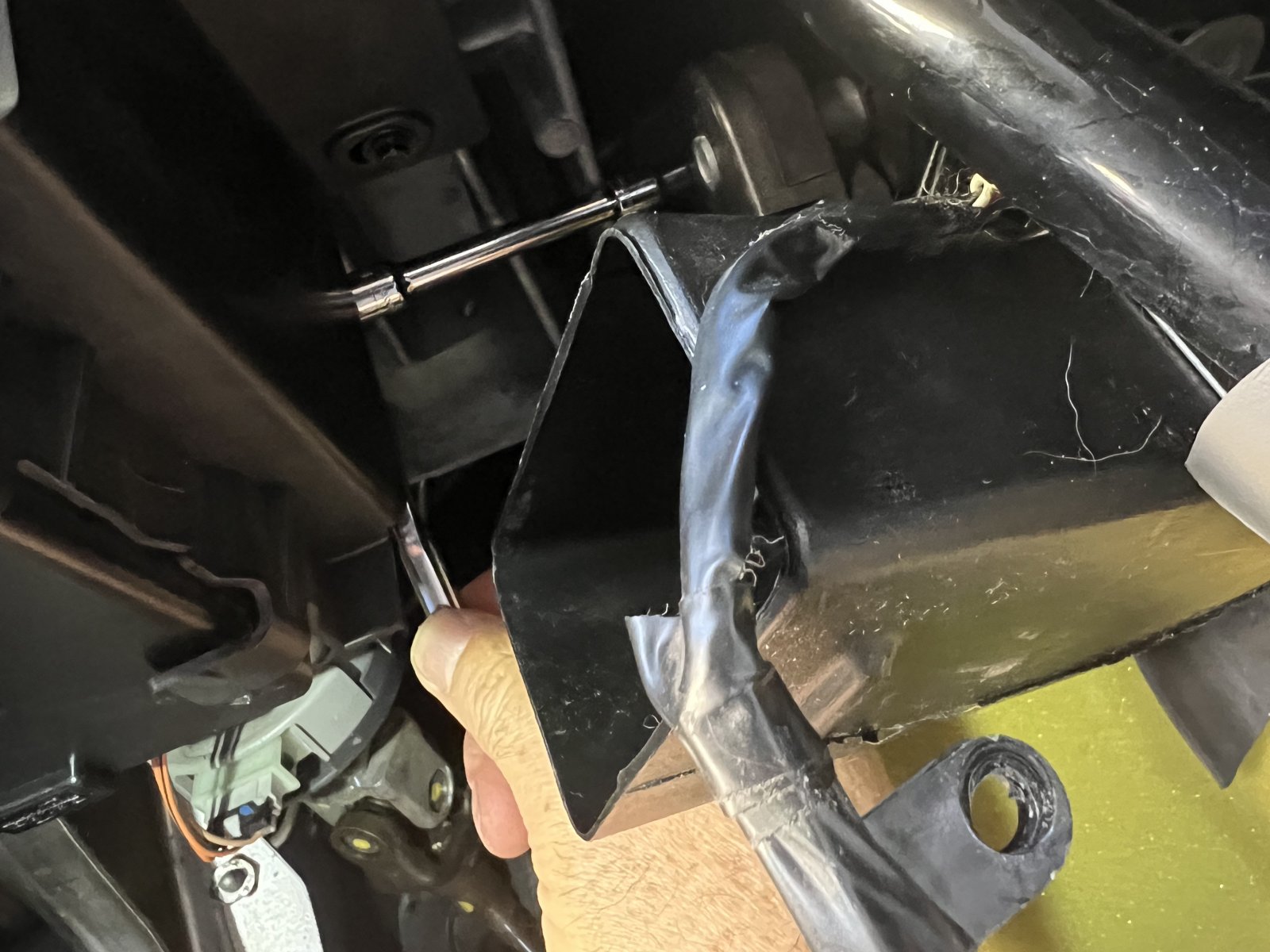

Sounds like the AC vent door actuators under the driver side dash (floor/defroster dash/front dash) are failed so you are only flowing thru the top defroster and blow by in the bottom; and a failed HVAC compressor (hot air) or failed mixer (hot/cold) vent actuator.
The hot/cold mixer actuator on the passenger side is easy to get to. The vent door actuator is very hard to get to, but it’s possible for a patient novice with tools. I have a thread on replacing the vent door actuator that restored air flow thru my front dash when it was stuck on the defroster upper dash station.
This is a very common problem in 15 to 20 year old GMT800’s.
