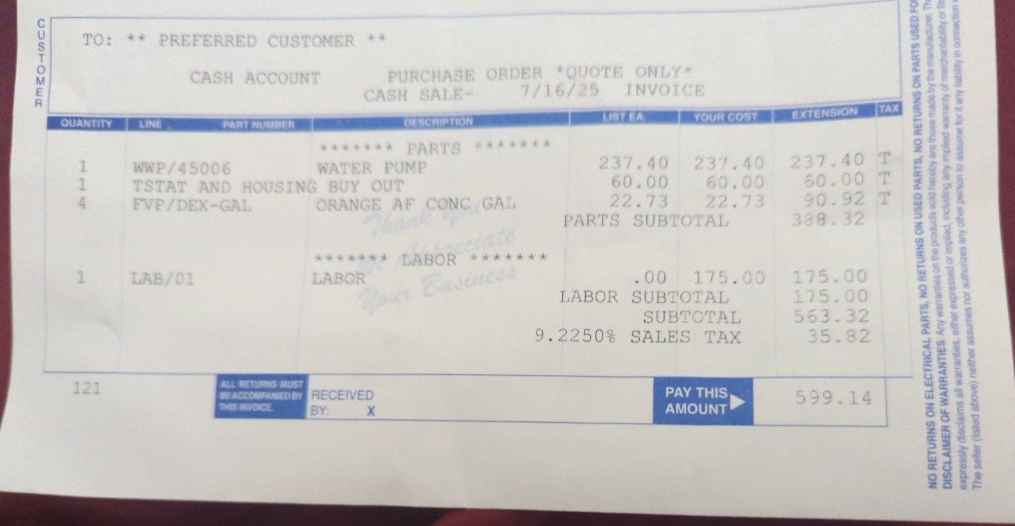

I would replace that radiator before you do anything else. I know you mentioned spending money on the other parts, but that cost seems a bit high for the parts you mentioned. Do you have a copy of the bill?

Yes I have one of the bills... I put new tires on it as well right before it did this so that was the other 500 I work for the mail so I have to get 10ply. So I need to get a new radiator? I can't afford crap I can't work

FWIW The receipt shows 4 gallons of orange concentrate antifreeze, nearly double what an empty system would need for a 50/50 mix.
There aren't air pockets in the coil packs, but could be in the cooling system.
