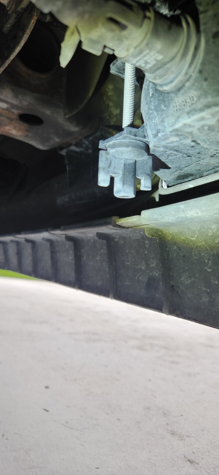

I lost one of the plastic fog light adjuster 'thumb' screws... I guess I have to visit a salvage yard ?
2 nuts off the shelf or junk bucket will work just put it where you like it and tighten the two nuts against each other. this effectly locks them together.

I went to the local 'Pick Your Part'.... I got a couple fog light adjuster knobs and fortunately, I also got the 4" adjuster bolt. GUESS WHAT?? The earlier Yukon 4" bolts are of a SMALLER thread diameter !! ( Also, the earlier spring is thinner & longer ) The fog lamp mounts are the same..... The 4" adjuster bolts remove very easy ( just "lift up and out" ) So, consider this if you dig up a used replacement....
Correction / EDIT..... I forgot..... My pair of fog lamp housings are the same as OEM, but are NOT OEM....... But the story is the same,,,, salvage yard hardware may not match what is on your "same style" stuff.
