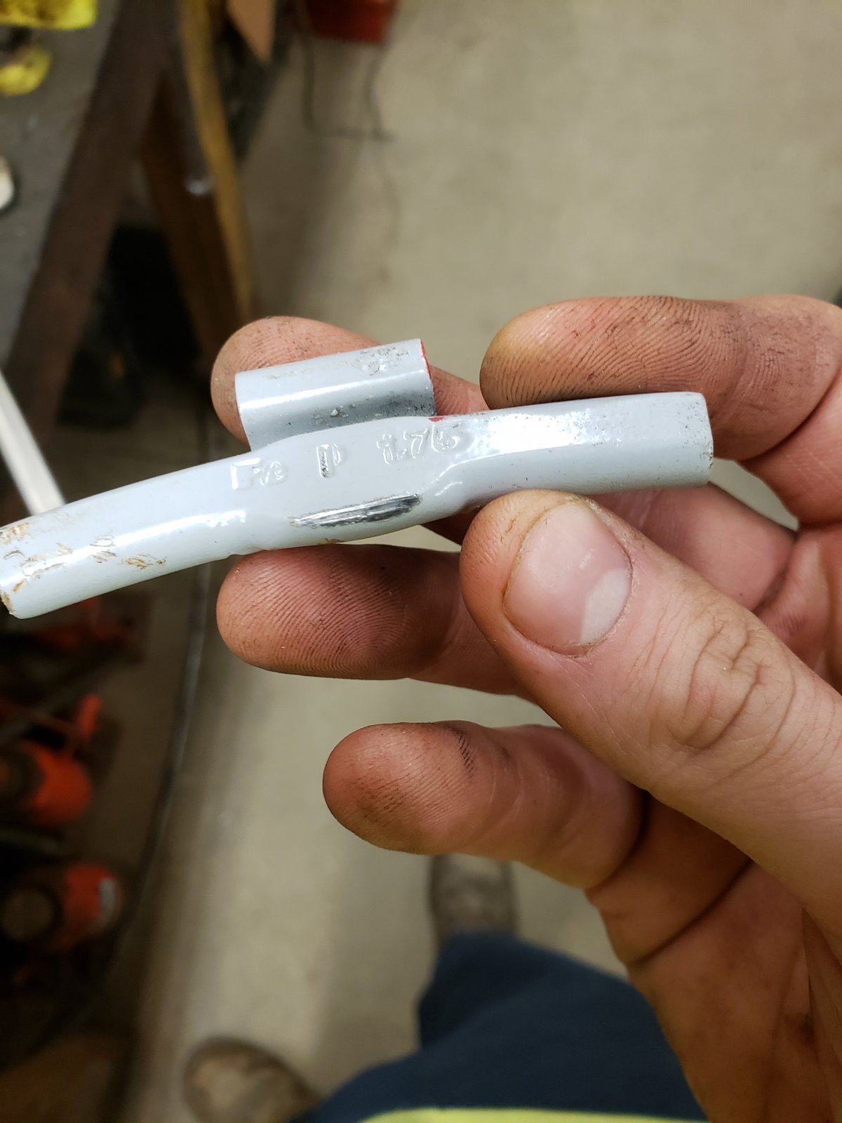

He stuck his head under the truck and noticed the wheel weights, on the brand new tires, had the smallest scratches in them. When I say small, I mean like the paint was peeled off but the metal wasn't grooved. He removed the weights and the sound went away. Apparently, they would rub on the steering knuckle during a hard left turn... I have no explanation as to why it would only do it on a hard turn but that was the case.
This noise was as loud as a rod knock.
