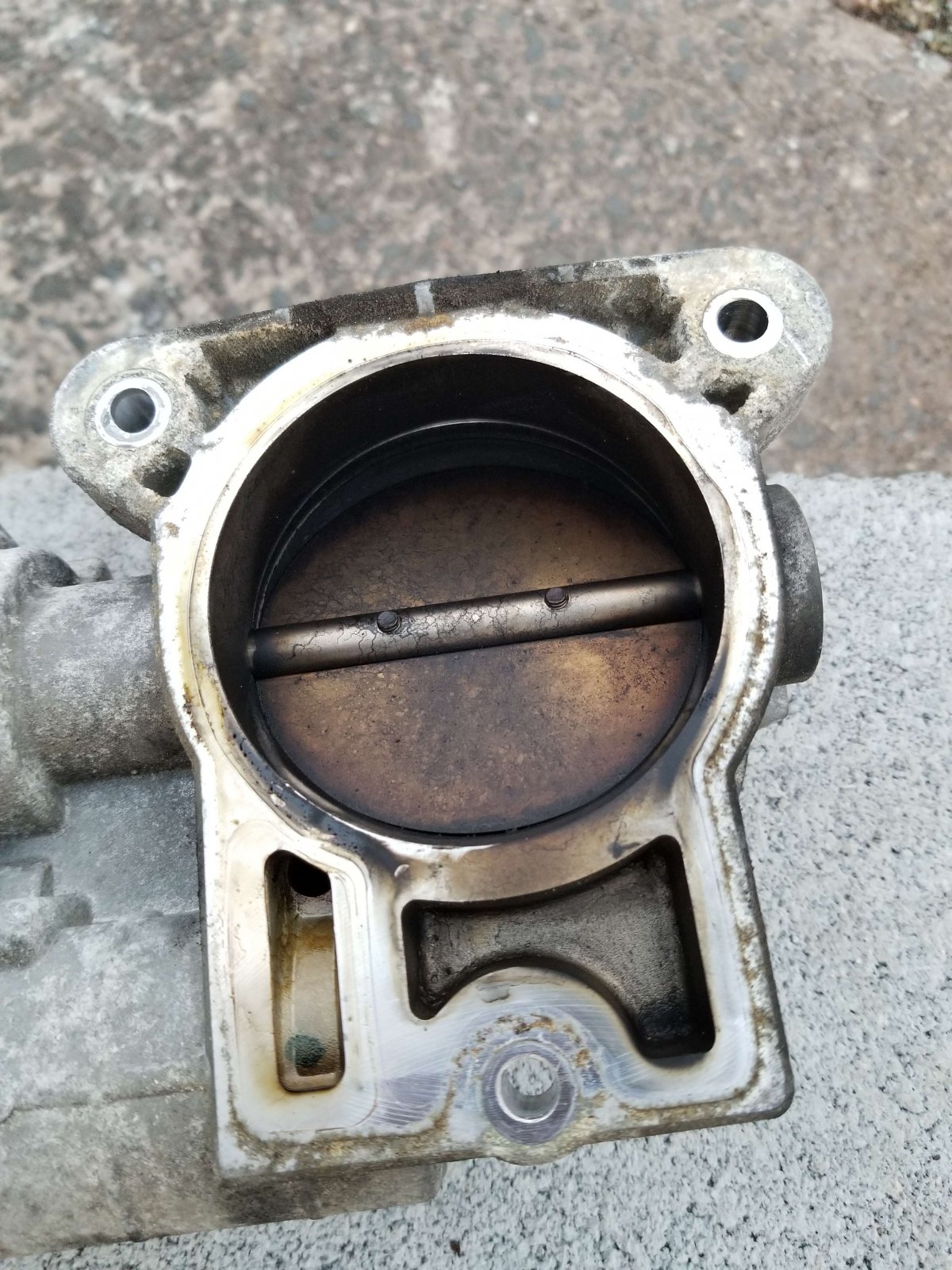

Here is a picture of the throttle body. Will definitely be cleaning this very well, its nasty.

Update, cleaned throttle body and it's running the same except with a small vacuum leak coming back to idle from revving because one of the throttle body studs broke.
Its idling at 490-500rpm, feels low to me and I'm wondering that's why its stumbling, because when I forgot a vacuum hose it was at 750rpm and it sounded much smoother. Just dont know why its idling low

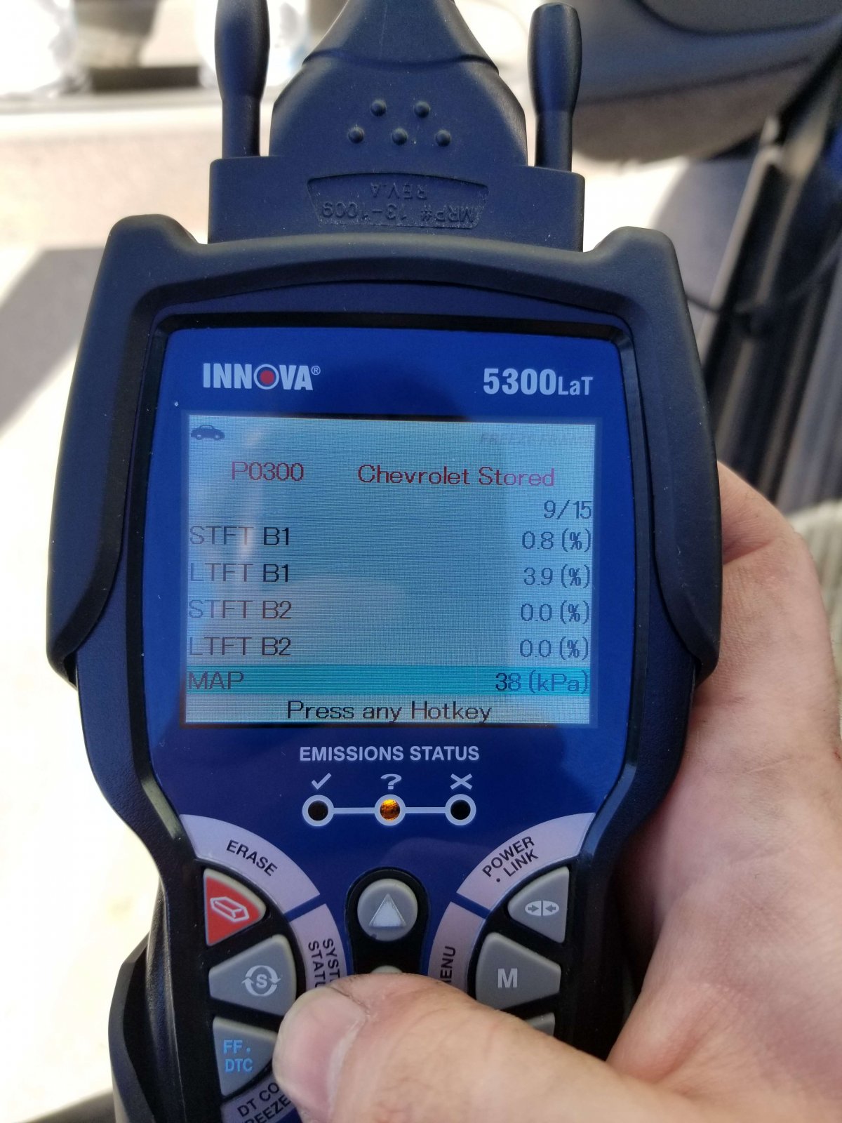

Definitely the intake ports then, took the PCV line off and its fine. What about on the passenger side? I know the EVAP Purge solenoid can cause a vacuum leak too. But my fuel trims seem good so it must not be a huge leak.

But coincidentally while still a low lean, the drivers side(bank 1) is still higher than the passenger side at 0.0% ST and LT, its got me thinking a small vacuum leak.
