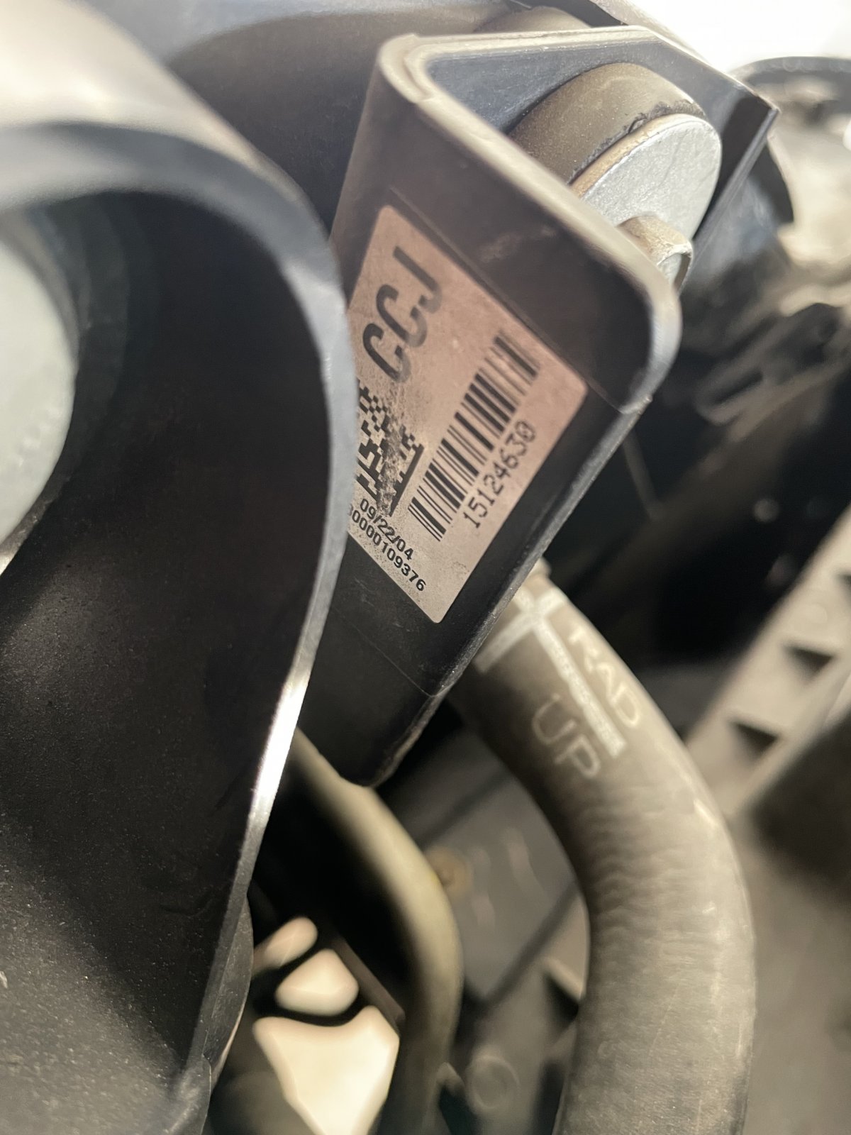

2005 Z71 tahoe. Part number on the original radiator is 15124630. Searching online tells me this number was superseded by 19256745, though I am unable to cross reference this number with anything on RockAuto.

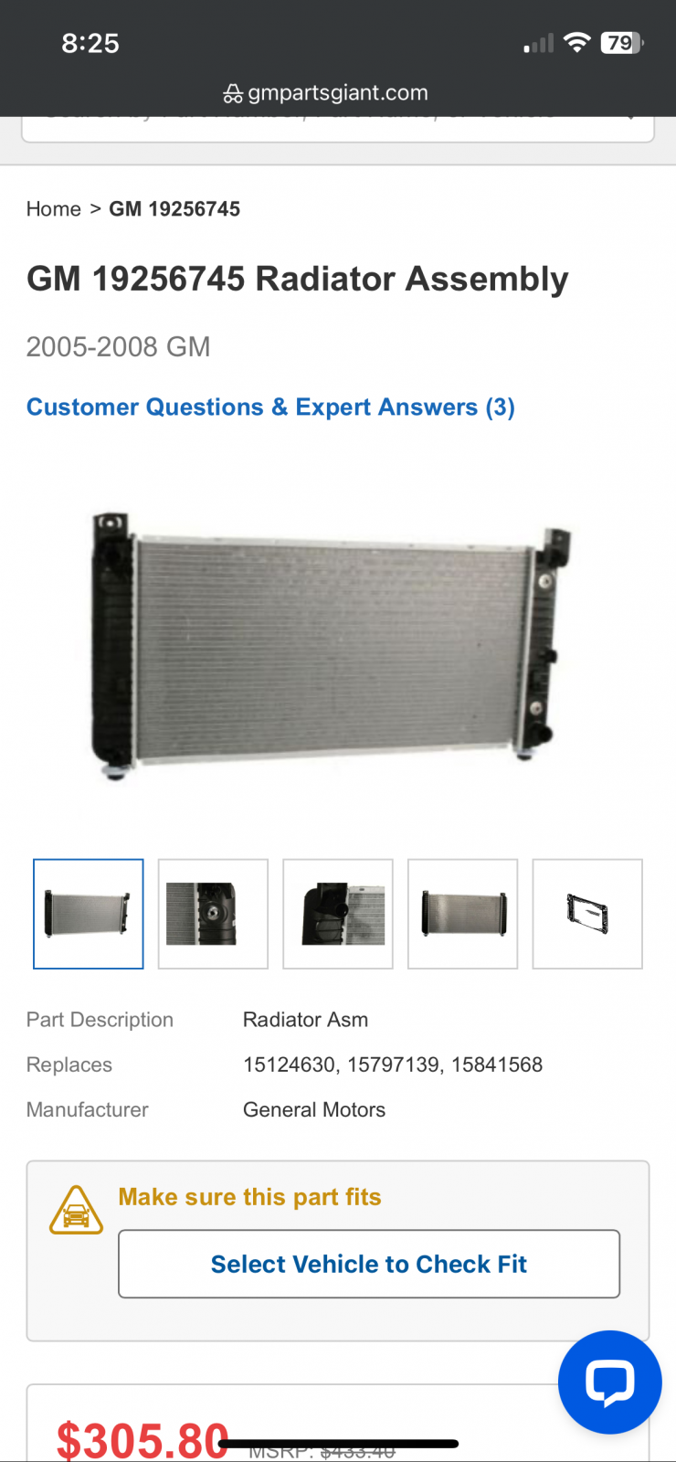

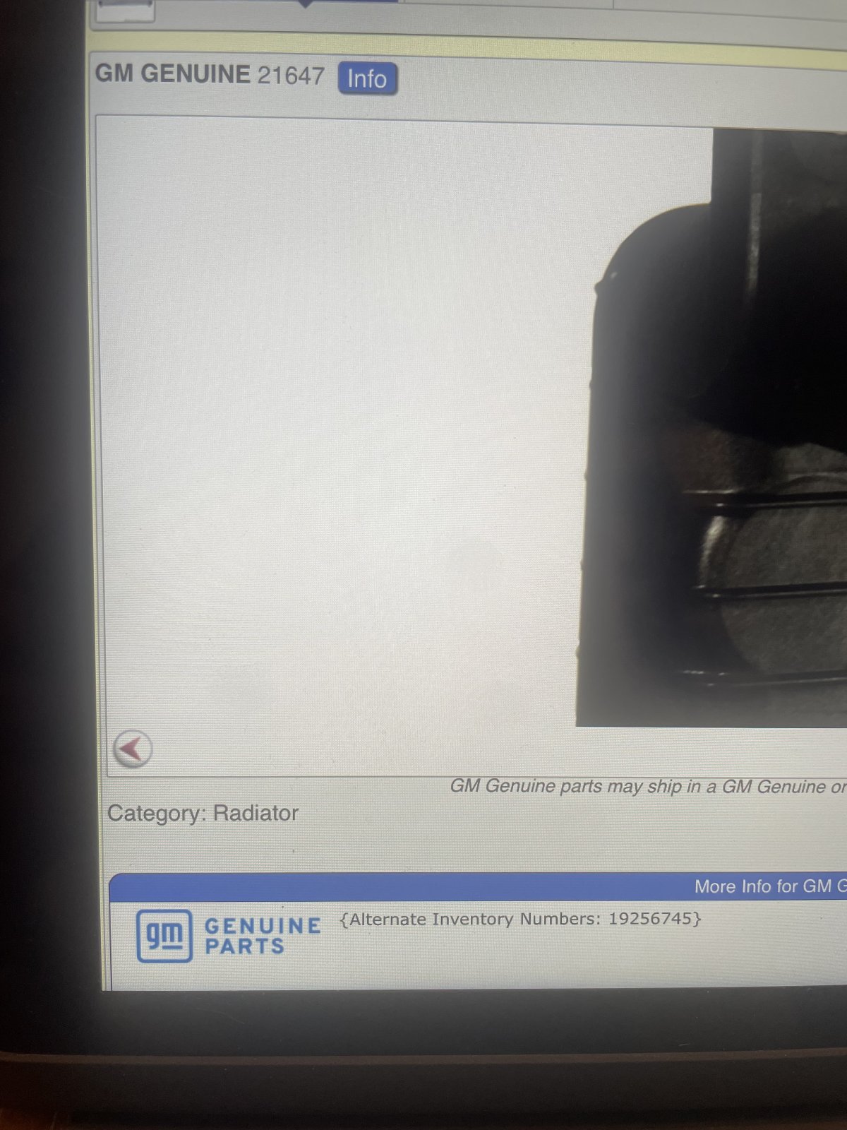

I added a few pics for additional info. From what I’ve been able to track down, 15124630 was replaced by 19256745, which has an alternate inventory number of 21647 in RockAuto. That number isn’t an option when I go through the part catalog so I’m at a loss.
21647 has a thicker core than 21650, which would be nice, but it also says it’s over 37”. My current radiator length is 34” which matches 21650 instead.

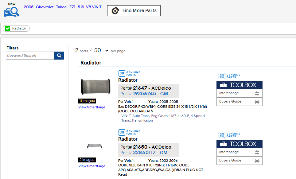

I'm still a little confused, though. Hopefully it'll help someone else out down the road if they search for a similar situation. Is the only difference between the two just the core thickness? I got a screenshot off AC Delco and it shows the two as options but it also shows the same dimensions until you view the smartpage, where core thickness and length are different. The code "CCJ" in the description for #21647 also matches the "CCJ" that's on the part number tag of my current radiator (in first post).
The only other thing that is jumping out at me is the applicable years for both radiators. Why would GM offer #21647 for one year? I think my tahoe is special, but don't think it's "that" special to get its own version of a plain jane radiator.

I cannot find any info on the difference between one another. Same core size, but different gm#'s.

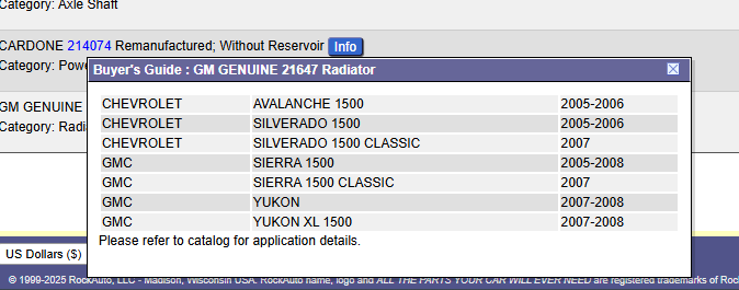

I'll see if I can cancel my secondary order for the other radiator. If not, I'll just return it after the job is done. I did go back and look at RA to see what applications there were for #21647 and my Tahoe isn't even listed, even though the alternate inventory number is 19256745, which is the number that superseded my current radiator.
