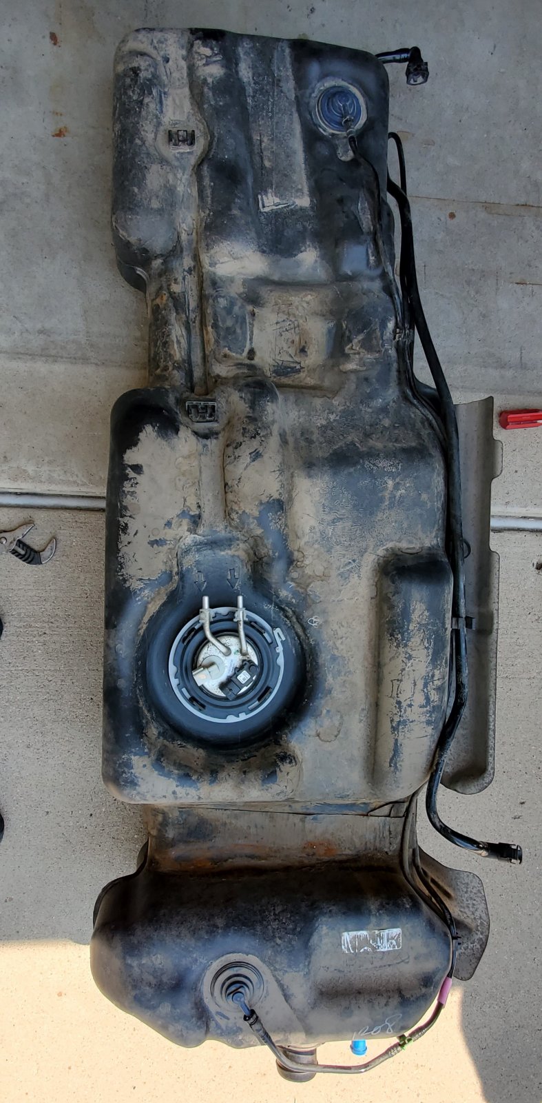

My '04 FF tank will come down without removing any of the evap lines from the clips on the tank, just disconnecting two connectors (canister and vent valve). Only the fuel lines need to be disconnected and snapped out of the plastic clips (on the left in the pic below, which is the driver's side). Everything else stays on.
It's easier to leave the fuel lines on the truck, just disconnecting from the pump, since the fuel line connections at the front of the tank are virtually impossible to access and undo -- ok, it can be done with some finagling of the tank in the process of removal, but why take on the hassle? They're well exposed after dropping the tank, in the rare case that any work is needed on them.
