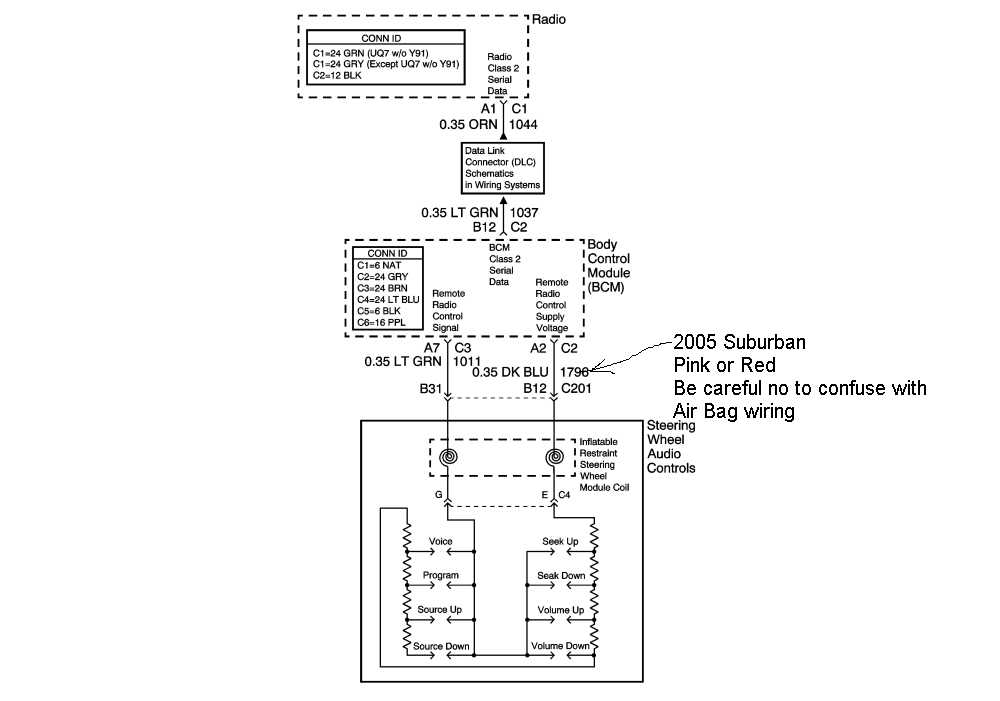

Does anyone have the diagram for the 2005 Burb/Tahoe/Yukon Steering wheel? Some of the wire colors have changed from the 04 diagrams I have. In particular, what color are the wires for the radio buttons?
Thanks,
Rich
This image comes from the Autozone website.
