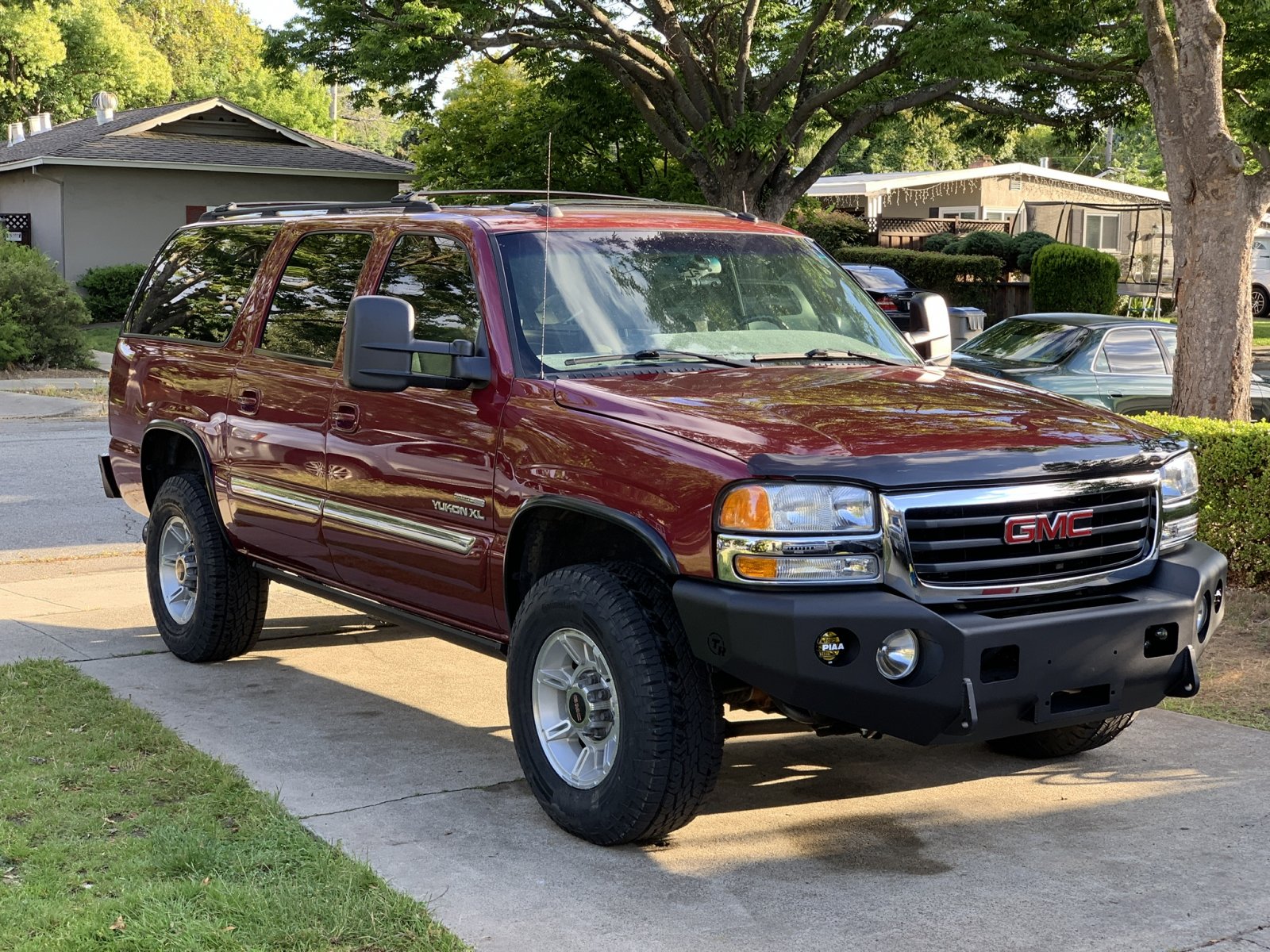

Nice rig! Adding an oil catch can and a transmission filter will improve the longevity of the vehicle as well; on the flip side, I have heard of setups lasting 200k+ miles on stock, so you don't NEED to do those things. The only other thing I can think of that you missed was the oil pickup tube and O ring. Those are a common points of failure on these engines; might should have replaced those when you had the pan dropped.

Nice rig! I love ours and don’t see us looking to replace it until I’m forced with no other option. This truck replaced my dually and I haven’t looked back.
The gmt800/900 k2500 burb/xl is one of the most solid platforms around. Hope you enjoy it!
As for your tire question:
Anything larger than stock will likely decrease your mpg. Your not towing super heavy, but it might raise trans temps a bit but that can be addressed with a bigger Hayden trans cooler. Other than that if you really want to keep the larger tires and can’t get temps mileage back in line, your only option is to re-gear. Or get the 8.1

Nice find on your well maintained GMC Yukon 2500 XL!
Barely see any 2500 in my neck of the woods.

Nice find, sounds like it will serve you well for a long time.
Since it’s a dedicated tow rig, why not stick with the same tire size? I will disclose that on my own 2500 pickup I switched to 285’s and towed a fifth wheel, so it’s not the end of the world with the 6.0 / 4.10.
