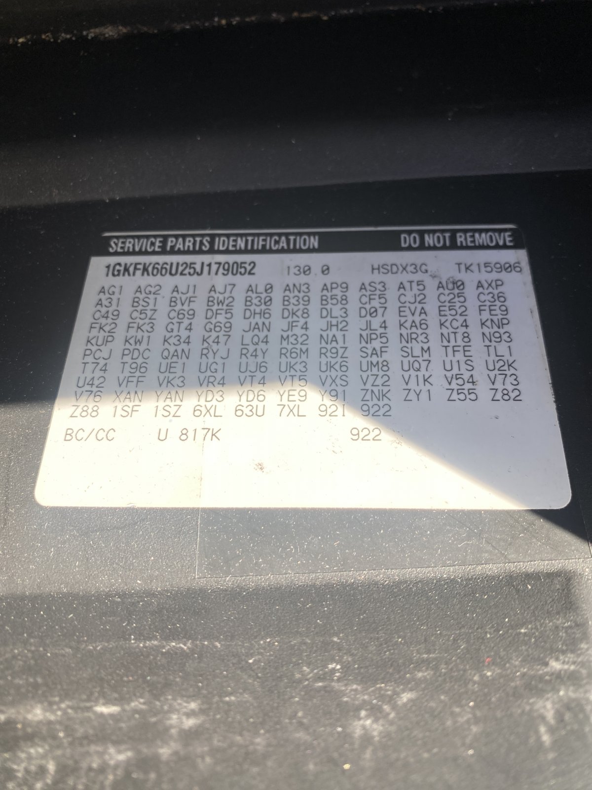

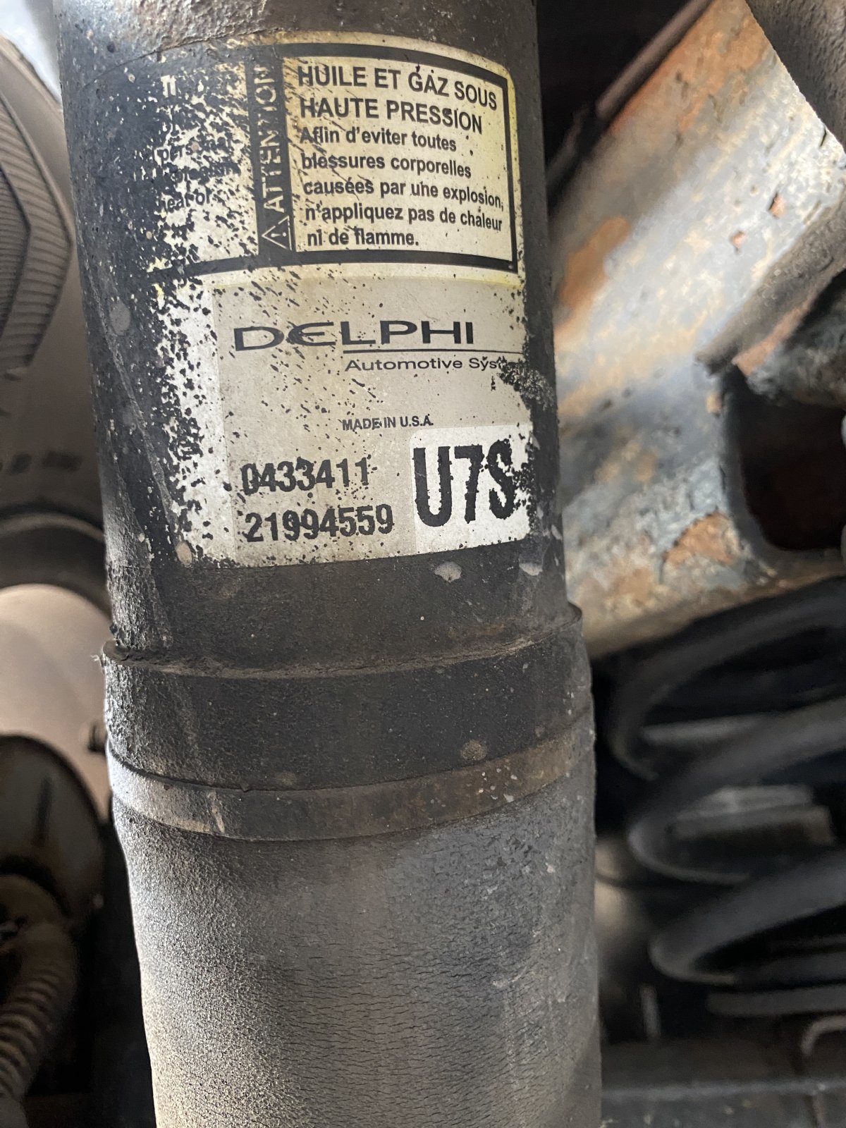

Hello All,
I just picked up a GMC Yukon Denali XL. Overall the car is clean and drives well. I have to replace the knock sensors next week along with trying to decide what to do about the rear shocks. I checked the RPO codes and it looks like it a Z55. My initial thought was to purchase the coil over conversion kit from strut masters. Rather doing the coil over conversion I would try to replace the air ride shocks. I've seen a few aftermarket shocks available but wanted to see if anyone had any recommendations.
