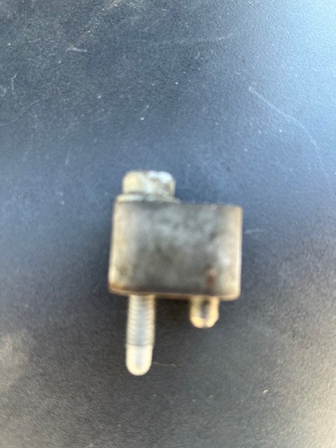

Jun 6, 2024
This bolt and plug part is located on the upper back of the engine. Pretty hard to get to and near where one of the engine grounds runs and gets connected. This was missing on my 2005 Suburban and thus the coolant was bubbling out and then spiling out on the ground. When we were searching for grounds to locate a parasitic battery drain, the bolt was loosened and not retightened and thus it popped off later when suburban was started and run. Luckily we found another one pretty quickly at local junkyard, installed it on suburban, and it now seems to run solid with no leaks. Although it did take quite a bit of coolant to get the system filled back up.
Still searching for the source of this major battery drain but think it might be a bad instrument cluster (as suggested by someone on this forum!) but still need to prove it out further.
