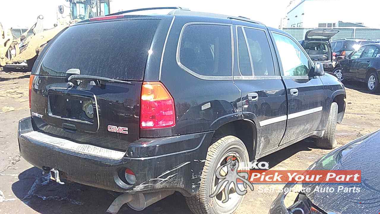

So if you have a NBS with the frameless rear window, and the rear window pull handle is missing.. I have found a solution that is cheap, possibly even free (mine was).
Go to your local salvage yard. I pulled a handle from a 2008 GMC Envoy, pic below, I am not sure if other years, and possibly models will interchange. You only want the handle and the plastic insulator just under the handle, you will use the rest of the hardware from your truck (including the nuts).
Other than getting the part, its exactly plug and play.. Bolt holes line up.
Donor
Installed
The donor truck I got the part from had 2 10mm nuts holding it on. The nuts on my Esky were 5/8. But were the same thread and pitch, but had a crowned, and chromed, nut head.
