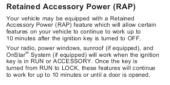

With the radio on, turn off the engine and remove the key from the ignition. The radio should stay on. But if you then open any door, the radio should turn off. Or, without opening the door, the radio and some other accessories -- like power windows -- should also work but turn off after about 10 minutes.
If it's wired properly to a RAP-supported (Retained Accessory Power) power source, and RAP is working properly, it shouldn't turn on after shutting off the truck and opening a door, which is how the OE radio is wired.
If it's wired to a power source that's always hot then that could be a problem. Do you know how it's wired, or to what circuit?

I will have somebody check out that power source theory. It makes sense! I will get back to you. Thanks man...

Found out the issue. It was indeed linked to a power source that was always "hot". Guy at the shop said it was weird because it stayed on no matter what he tried. He thought it may had been the switch in the door that triggers the radio to turn off if it stays on after ignition is turned off.
He put a blocker on the fuse box that the wire was running from and I have had no issues. As soon as I take the key out of the ignition, it turns off immediately.

Well, when installed, using the correct harness would have prevented this, since the radio power would have been ignition/RAP switched in that case. Seems like a lot of trouble to go through when installing, to connect to an always hot source. Unless, of course, one sits in it for a long time listening to the radio, without starting the engine.
